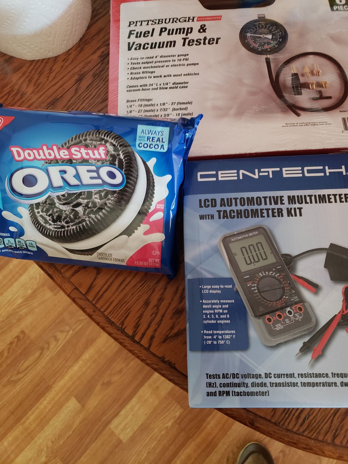

Thanks everyone who chimed in so far. I haven't got much accomplished. I tested a few things and more importantly, grabbed a trio of things that I am sure will get my problem solved. And guidance or tips on how to best use any of them will be greatly appreciated. If not I am sure youtube has a 35 minute instructional that will cover the 3 minutes of instruction I need.
I did play with the idle screws on the carb, got it to run worse at least. Now that I have a gauge, i should be able to get them dialed in. Hopefully I can get back in the garage on Thursday.
Old Apr 23, 2019 | 03:57 PM
Posts: 42,475
The Oreo's ought to help a lot.
Old Apr 23, 2019 | 05:02 PM
Posts: 25,797
x2

Well when your trying to teach yourself how timing, carburation and vaccum work on an engine, you need something to help maintain sanity. I find double stuffs do just that.
Old Apr 23, 2019 | 05:22 PM
Posts: 25,797
Heck yes.
