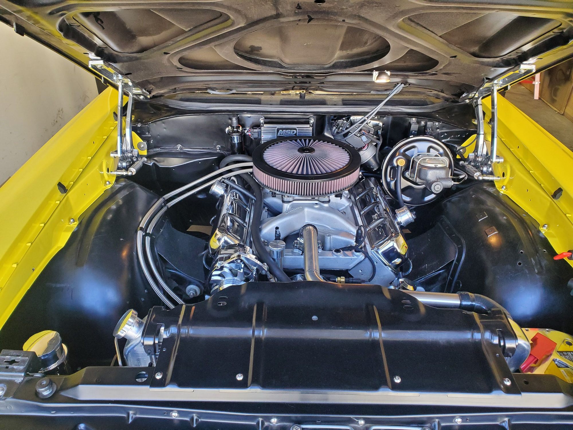

some photos are attached. My new motor is still being put in the car as I write this. I got an electric fan rad but they sent me the wrong mounts and the proper ones are on backorder. So waiting is what I'm doing. Don't mind the dirty engine bay. It will be clean and a deep rich wet black look when I'm done. Some of the photos are with the old wheels too (sunset and thumbs up). The new wheels are copy cat of the classic style but just bigger. 17x9's at the back at 17x8's up front.

Nice 72. I may never take my car to a track, i typically will cruise and enjoy. I dont mind indulging my right foot. I try to keep it under 5k rpms.
i see copper write about winding his sbo to 7k my eyes get wide, but thats how he built it and uses it. My current BBO works for me and 5k is a good limit (i think).
you have a ton of low end torque and great hp ill will bet it will be really nice cruising w your car.
nice build!

Thanks for the pictures, I REALLY like that color combination! Very nice.

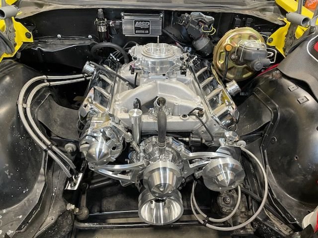

New motor is in and it's awesome. This time not stroked.
As a follow-up to my post from last year I had a new motor assembled and not only is this one well built, it's got some snap to it.
Dyno sheet
The jewelry.

Looks great!
