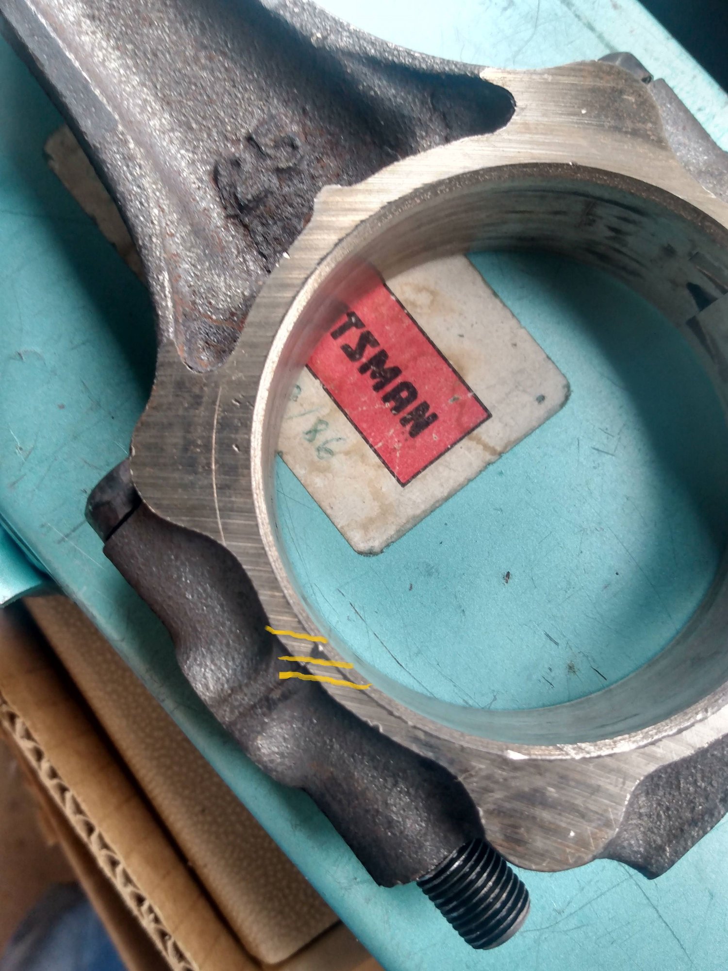

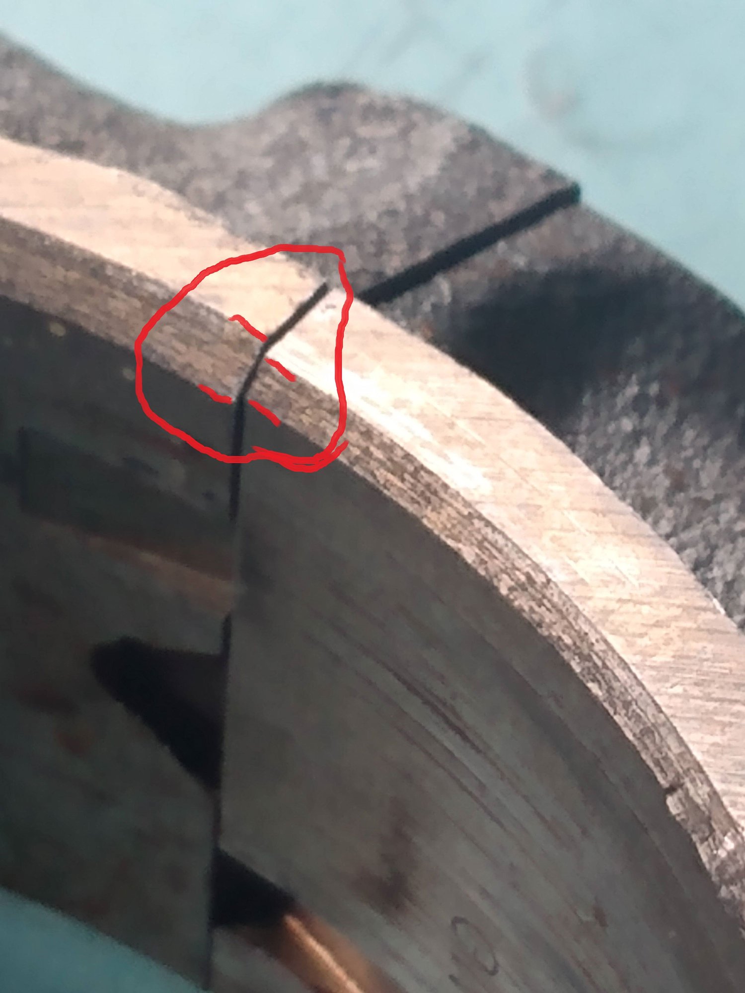

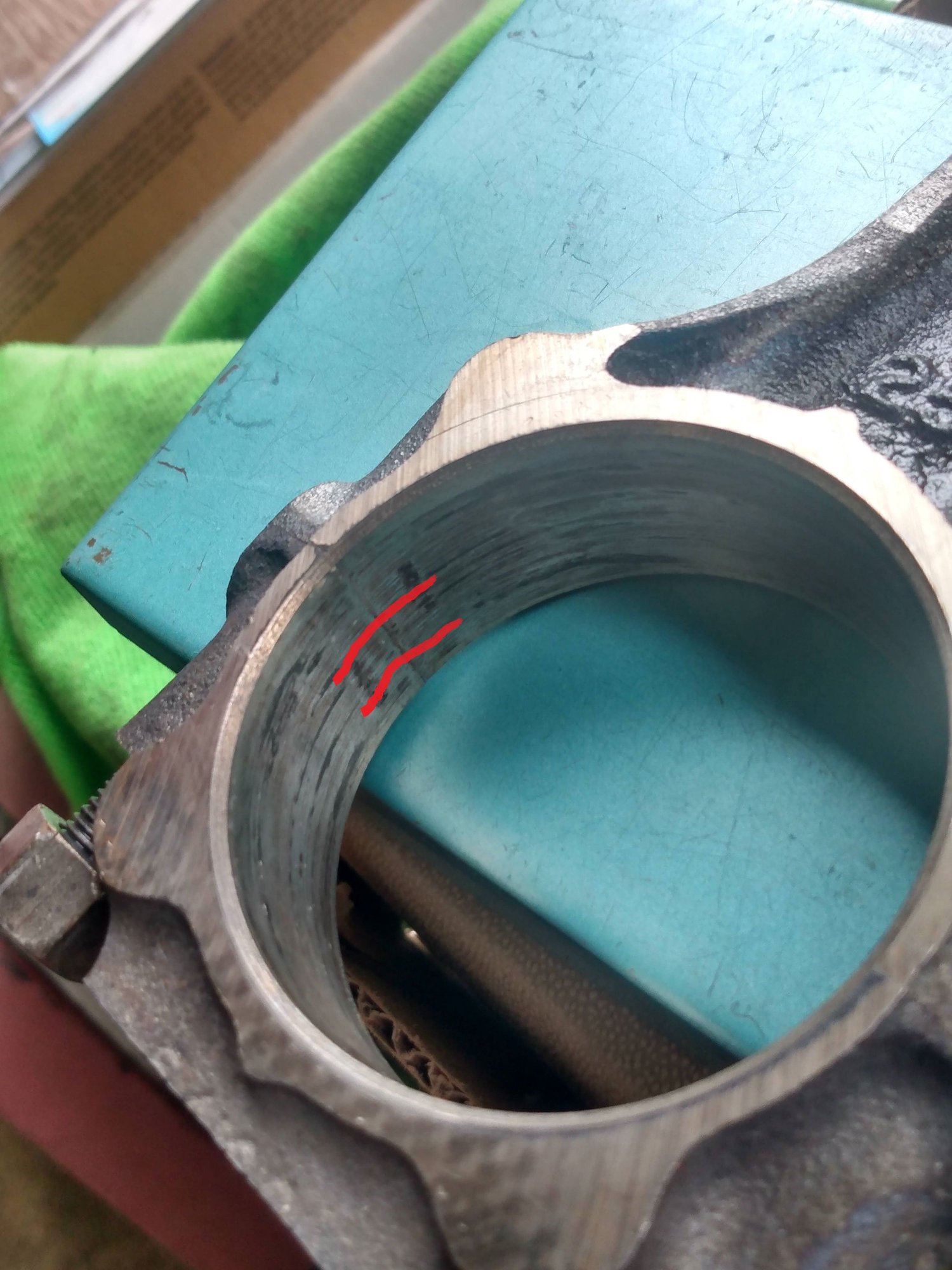

Here goes. First thing you need to do is take the rods out of the engine and put them on a bench with real good light. Then take the bearings out of them.
Now, here are three pictures of the areas that you need to look at to match the caps with the rods. Start with one rod and try all of the caps until you get to one that matches. Then go to the next one etc.
I sometimes use a magnifying glass to look at these things but most of the time you can see them with the naked eye. Between these three clues you should be able to match the caps to the rods. Let us know how it goes You really should not have to replace the rods.
1. The first thing to look at is the chamfer at the parting line. This picture shows an obviously mismatched rod. Sometimes you dont even have to put the cap on the rod to see that it is not going to match.
The next thing to look at is the machining marks where the bearing sits. Look at them at the parting line and see if they match up from the cap to the rod.
Last is the machine marks on the "face" of the rod. Look at them where they cross the parting line and see if they match up.
