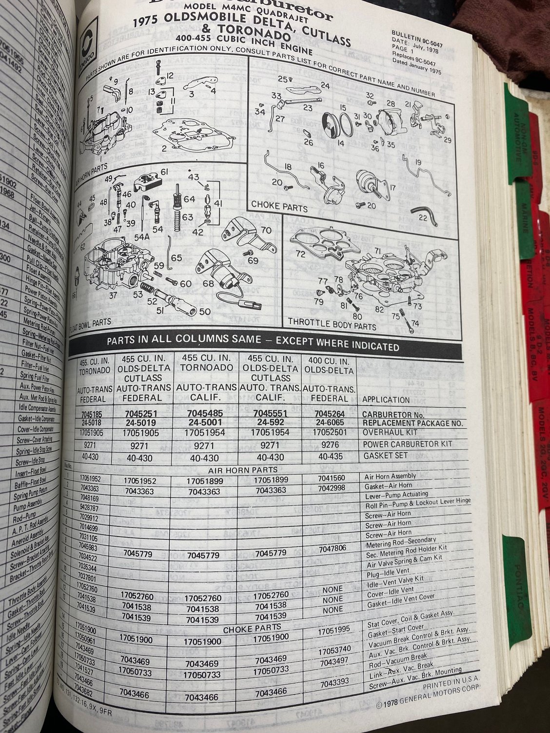

Delco #9 shows.......

Anybody ever seen one? That is the first I have ever heard of that. But then, I haven't heard everything. By the way, we are getting off the subject.

Before anyone starts squalling that there were no 400 engines in 1975 Oldsmobiles, the Pontiac 400ci engine, either 2bbl or 4bbl, was available in 1975 Delta 88, Ninety Eight, and Custom Cruiser.
I don't recall any Pontiac V8's being available in any Oldsmobile full size from 71 to 76, maybe I'm wrong?... What is squalling?

The book shows #7045251 for the correct quadrajet? But if this is kind of rare, what others would work.?

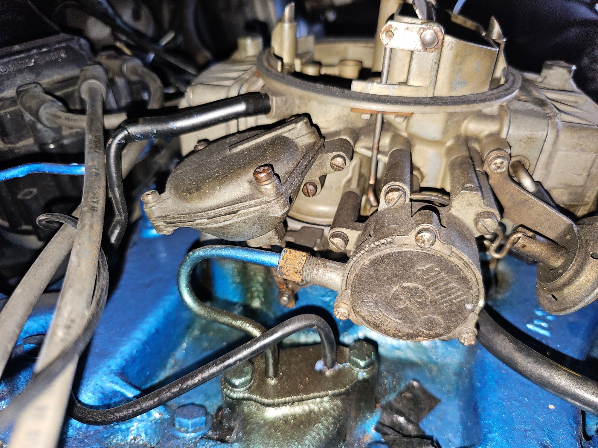

There's a Holly carb on there now. It's working the thing won't idle down correctly with an extra spring on the throttle linkage. I had a previous post about this to see if all these springs were correct (which they are not, but with just the double spring on the foot pedal linkage, it idles at 2000 rpm!!! Prior owner added a 3rd spring that pulls on the throttle to a point on the front of the engine. Rather than have the Holly rebuilt and fixed, I thought I'd try and get an original or a carb that would at least be a Quadrajet!

By the pics in other thread it looks like you have a spread bore Holley now.
Some like them and some dont, but they can be made to work decent.
I myself would opt for the Quadrajet.
Depending on how original you want to get, is it a restore to numbers or if just want a good driver, an era correct 455 core is a good choice or you can opt for a late model APT Quadrajet and get benefits from it.

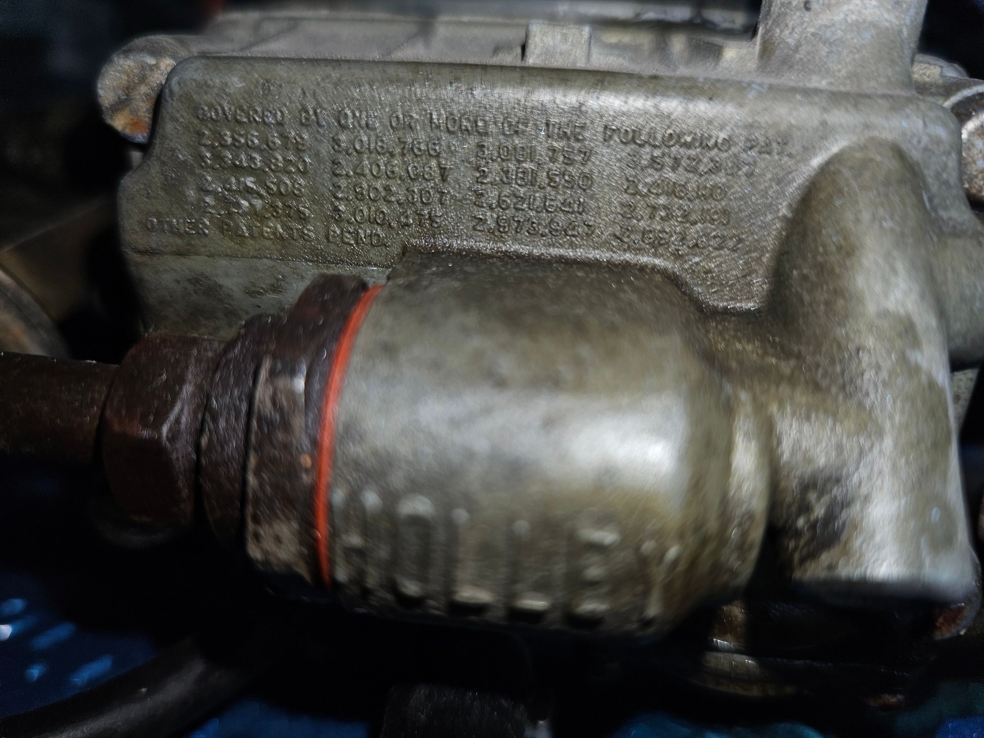

I'm uploading pics of the Holly now.
Old Oct 4, 2024 | 07:58 AM
radiofellow50's Avatar
Joined: Sep 2021
Posts: 265
From: Minnesota
Pics of Holly

Keep in mind that if you chose a Quadrajet that is anything other that a numbers correct, I would avoid the '75 version with the single metering rod/jet power piston set up.

So al lot of what you are saying is beyond my knowledge but I'm gathering that I should steer clear of the model #7045251 and try and find a model 7045184???
Is that correct?
