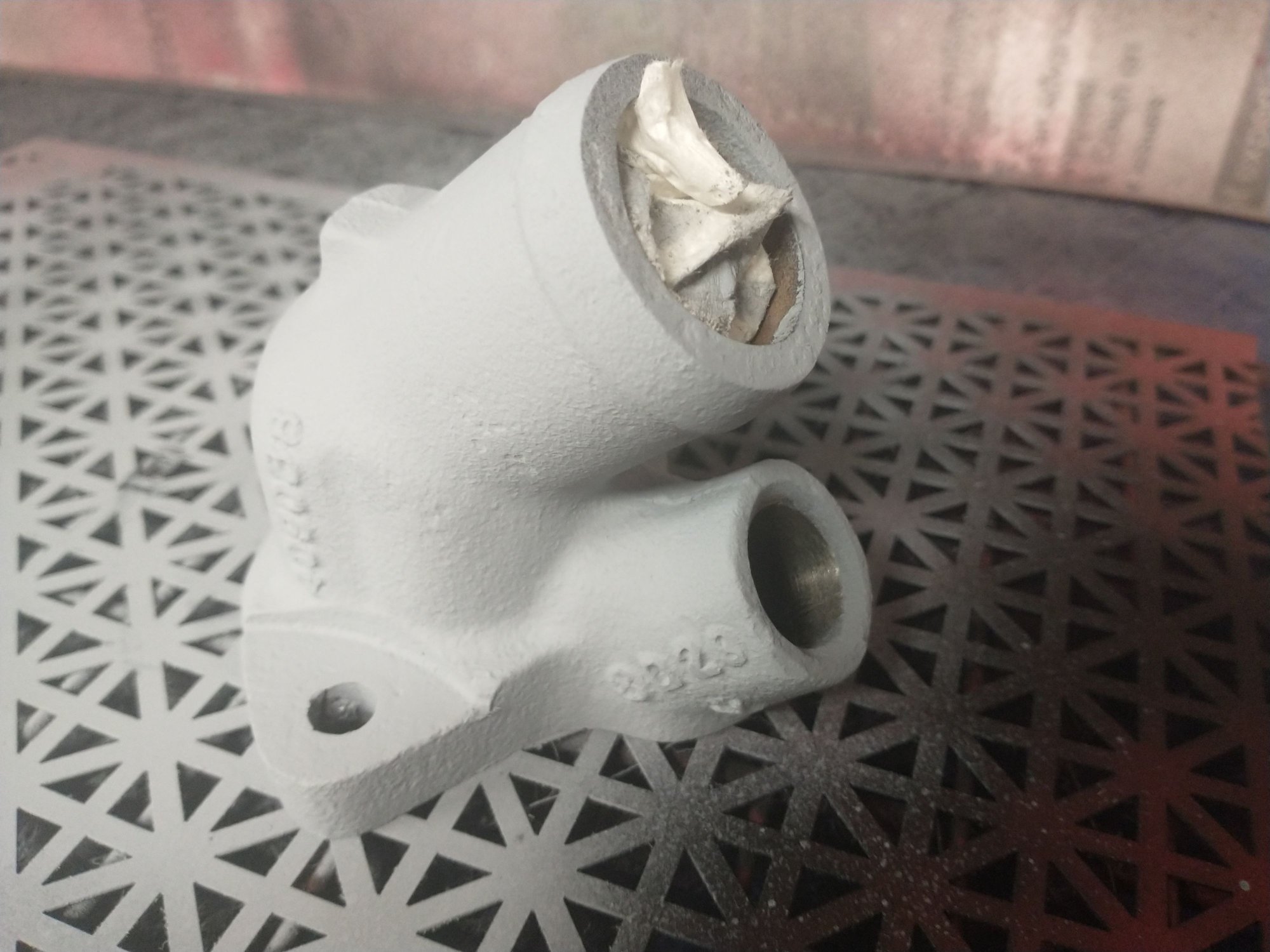

The down tube in this water neck was rusted but I managed to remove it. I've read on this site that the aftermarkets are poor quality or don't line up correctly so am hoping to keep it. But open to suggestions.
Has anyone tried to do a similar repair to install a new pipe and can share tips?
Thanks
Original 455 water neck outlet

Thanks for the replies. Buying new is easier probably precovid or when you could walk into a store and purchase.
After some research, wanted to share what I did. I took a 1/2" NPT tap and ran in through the bottom. Took a Dorman 56360 heater fitting ( 3/4 In. Hose X 1/2 In. Npt X 1-3/4 In. Long Nipple) and threaded it in with pipe sealant making sure it's only on the threads. Fits perfectly but will need to use a Gates 20333 coolant hose like on early cutlasses, etc.
Hope this helps someone in the future.
