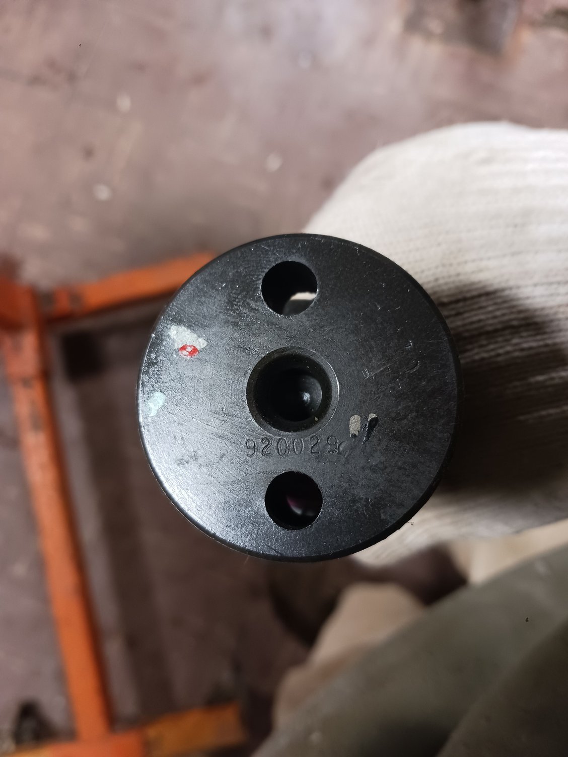

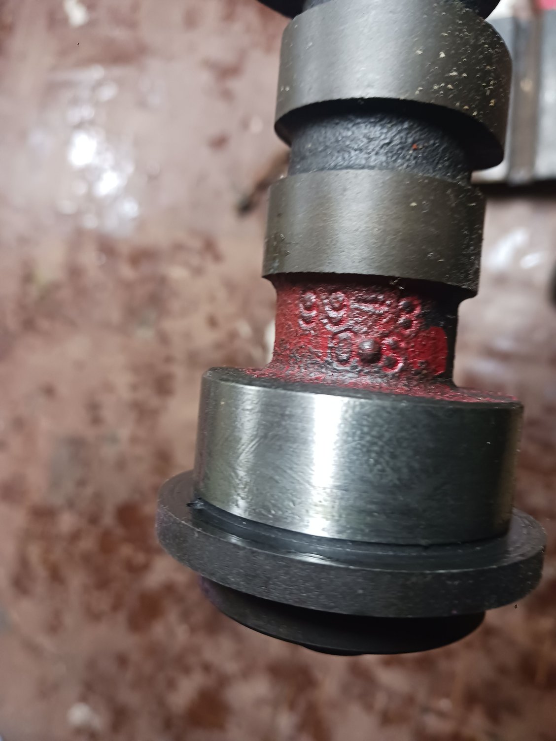

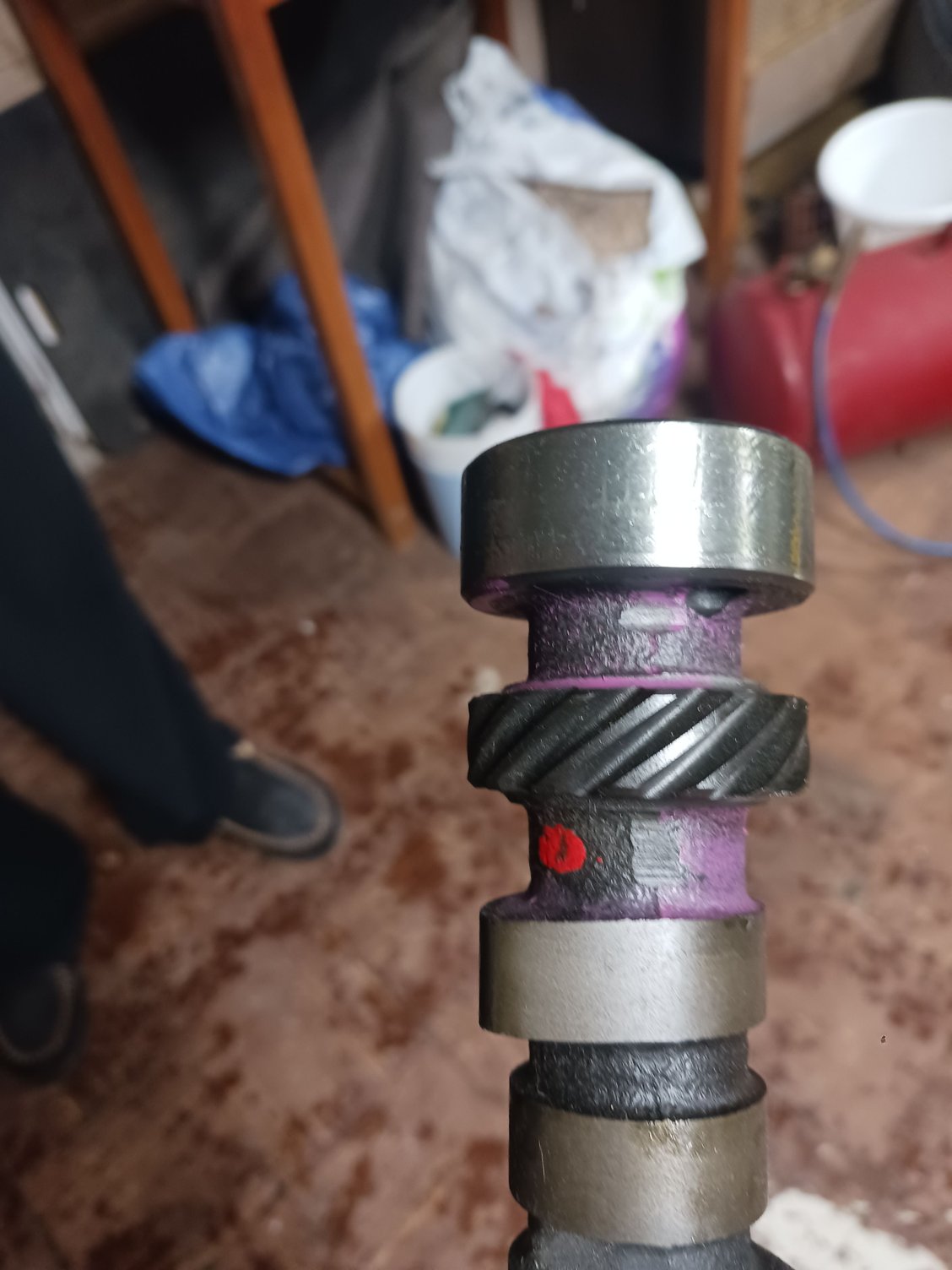

I have a rebuilt '66 E shortblock that I decided to finish building. Pulled the new camshaft out of it to find out what it is. Besides the CMC machine brand core casting between the lobe and bearing journal, there is a number stamped in the back end. 920029. I went through all the manufacturers I could find and none of them have a sku number or part number anywhere close. Even Oldsmobile factory part numbers. What the heck is this thing? Ideas? Thanks!

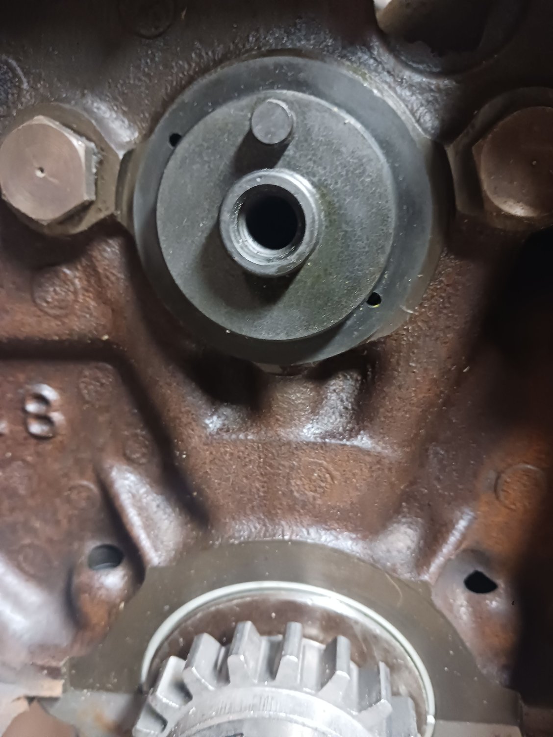

Can you post a picture of the front, where the timing sprocket mounts

Do you have a picture of the back of the cam with the number ?
Post #1, 4th pic.
