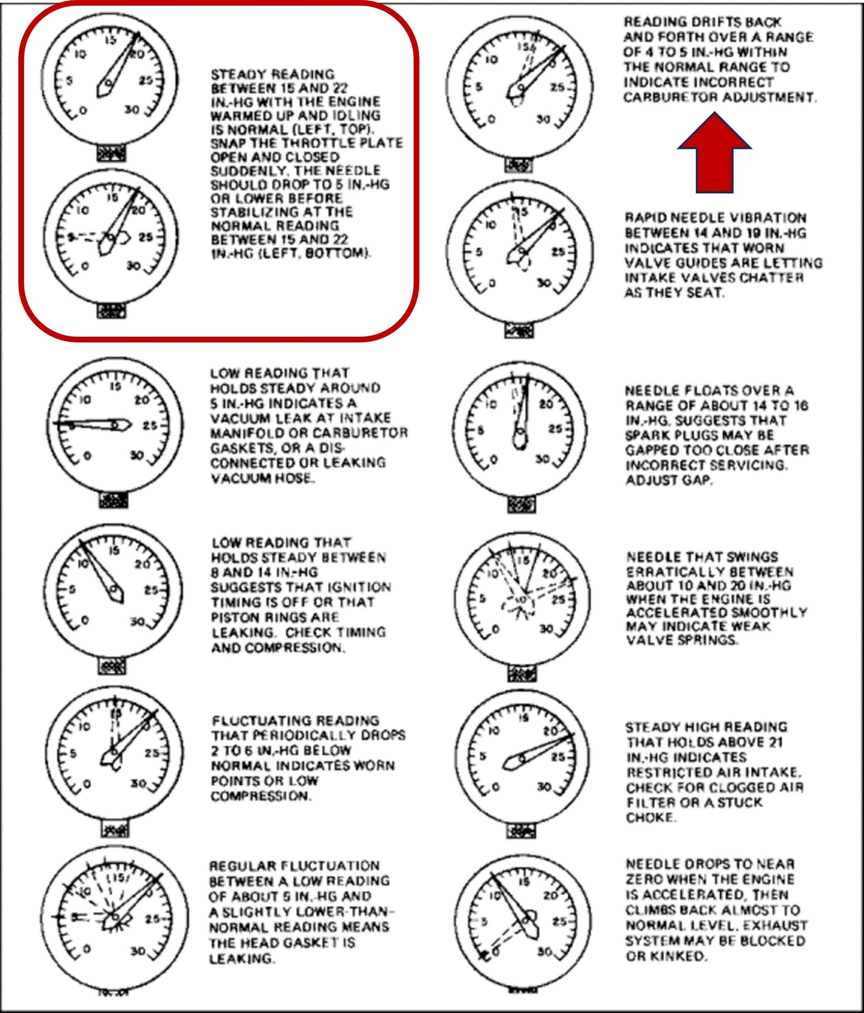

So I was playing around with this today and I have to admit, I don't have the knack for it quite yet.
If I mess with the base timing, the RPMs want to go up and up and up the more advance I give it. It just seems to like more and more advance and I kinda don't know where to stop. I set it where it seemed to be running really nice and I checked the base timing.......yeah, I had it up to 19 degrees! Way too far, I'm sure.
I reset it to 8 degrees to be safe for now which is a touch over the 7.5 spec in the manual. I set the A/F screws to where it seemed happiest and it seems pretty good (in the driveway that is). I'm detecting a slight stumble though when I give it a good shot of pedal in the driveway.

Took it out for a drive today and it seems to cruise ok but there's a horrible flat spot when accelerating away from a stop sign. Falls on its face and then comes right back to life. The dwell is rock solid at 30 degrees, base timing is at 8 degrees, and the A/F screws are both set about a turn and a half out. Looks like a solid stream from the accelerator pump too.......I did tweak the A/F screws a 1/4 turn out a couple times and it got a little better but still fell on its face on initial acceleration especially from a stop and trying to accelerate to regular side street speeds.
Old May 20, 2024 | 04:42 PM
Posts: 25,376
You really need to use a vacuum gauge to dial in the idle mixture screws - one at a time, adjust each one (one at a time) until you achieve the highest Hg" vacuum. You should easily be able to pass the 1st test in upper LH corner and your reading should be rock steady.
Old May 20, 2024 | 04:50 PM
ourkid2000's Avatar
Posts: 1,219
From: Nova Scotia, Canada
Oh I did do this. I followed your advice from before.
I did notice that the vacuum read isn't rock solid but it's pretty solid. There's a slight bounce on the gauge. It's not an inch of Hg but it's got a slight bit of shaking. If I rev it up a bit it seems to be very steady.

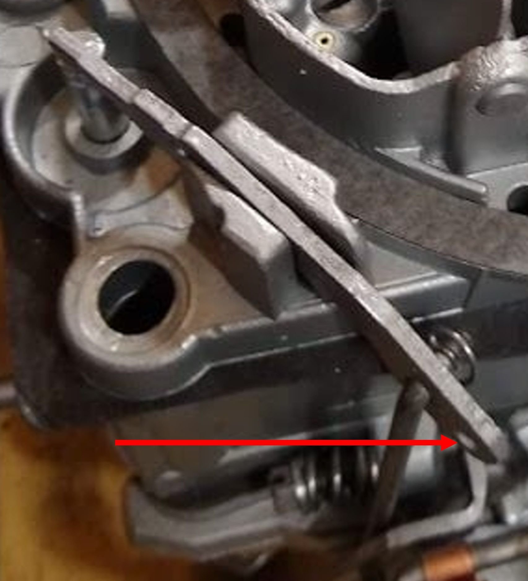

I had the carb apart a while back, here's some pictures of it. It does not have APT adjustment as it's a very early style Qjet that has none of that stuff that came later.

With that description my first thought would be insufficient accelerator pump discharge. What happens when you go full throttle?
Originally Posted by ourkid2000
I'll give it a test today. Maybe I'll make a video, hopefully it will show it better than I can explain. Thanks for your help by the way!
OK. I don't know the exact conditions under which the rear (outer) hole of the accelerator pump is &/or can be used most efficiently. There's various conditions among various groups of people who use the rear (outer) hole (e.g. altitude, non-stock modifications, etc.). The hole isn't there because Rochester had nothing better to do than drill an additional hole in the accelerator pump arm. It takes all of thirty seconds to change the location of the accelerator linkage to fit into the rear (outer) accelerator pump arm. If you have an extra thirty seconds it might be something to try.

Hello folks,
I took some time today to make a couple videos of the issue. I made one showing the vacuum gauge while I did a few throttle snaps. I also made one where I took the car for a short drive. Hopefully you can hear the engine trying to cut out when I give it gas.
Would love your opinions on what could be going on. If you have any questions, I can always make another video if you're not getting what you need. May have to turn the volume right up on the drive video as the phone was banging around making a bit of noise.
Old May 21, 2024 | 03:51 PM
  #33
Posts: 25,376
Your vacuum gauge needle is bouncing around - it may not demonstrate +/- 4Hg"-5Hg" but that is not a steady vacuum.
You said in the 1st video your timing is set to 8° BTDC initial? Try between 10°-12° BTDC.

Norm, I think that outer hole would cause a shorter pump stroke, so less air/fuel enrichment.
Old May 21, 2024 | 04:05 PM
  #36
Posts: 25,376
Kenneth - Yeah, like I said I'm not exactly certain if it would have an affect. With that said (before I listened/saw the videos) I'm still suspicious of a vacuum leak &/or misconfiguration of the vacuum hoses (after viewing the videos).
Old May 21, 2024 | 04:54 PM
  #37
OLDSter Ralph's Avatar
Posts: 5,171
From: St. Paul Minnesota
Fun 71, you are in fact correct.
The spec on mine is 7.5, is it safe to try 10-12?
