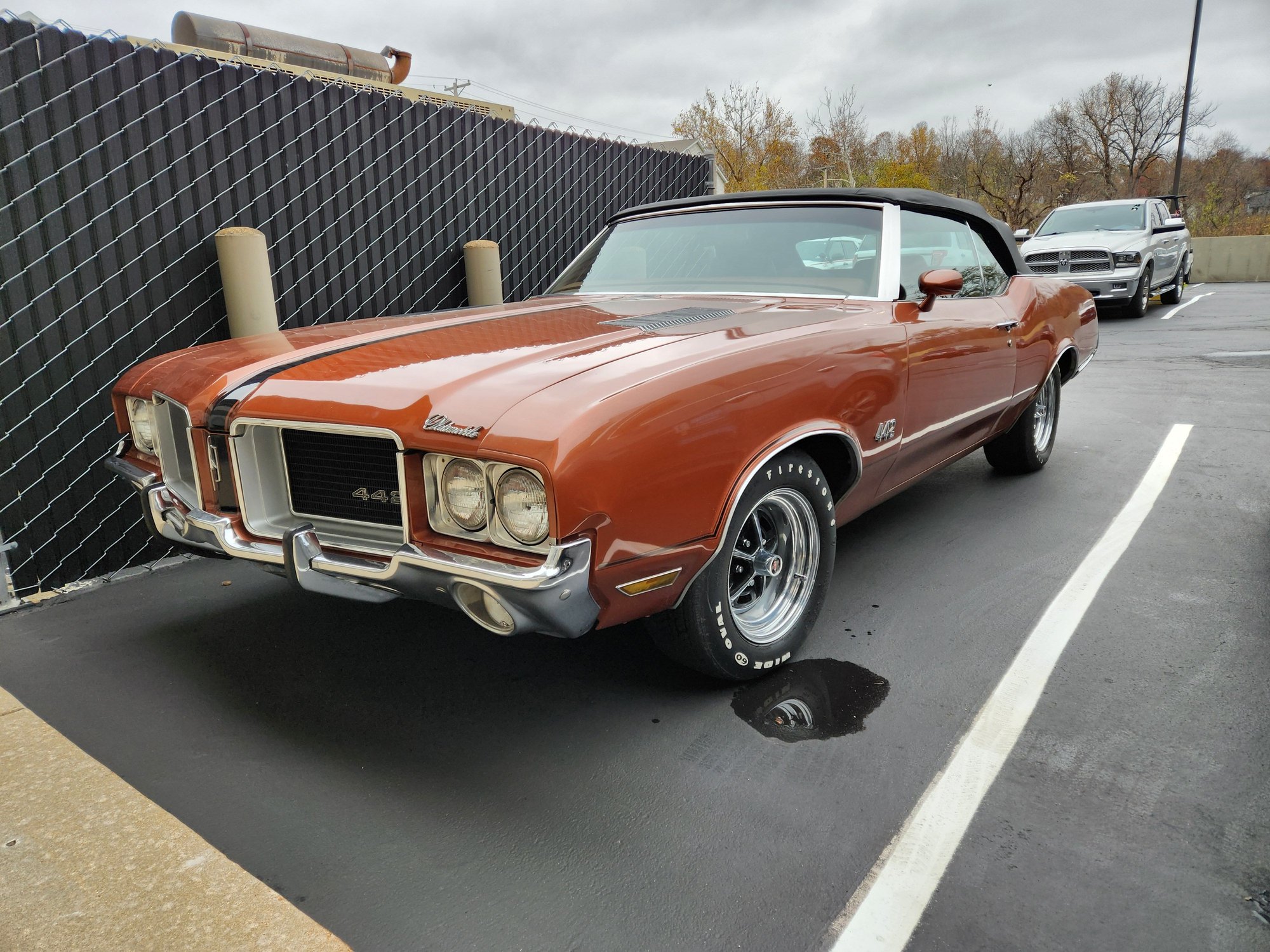

Old Nov 17, 2024 | 07:44 PM
Yagottabkiddin's Avatar
Joined: Nov 2024
Posts: 23
From: St. Louis county
Old Nov 18, 2024 | 08:45 AM
Posts: 16,688
Lookin' good!
