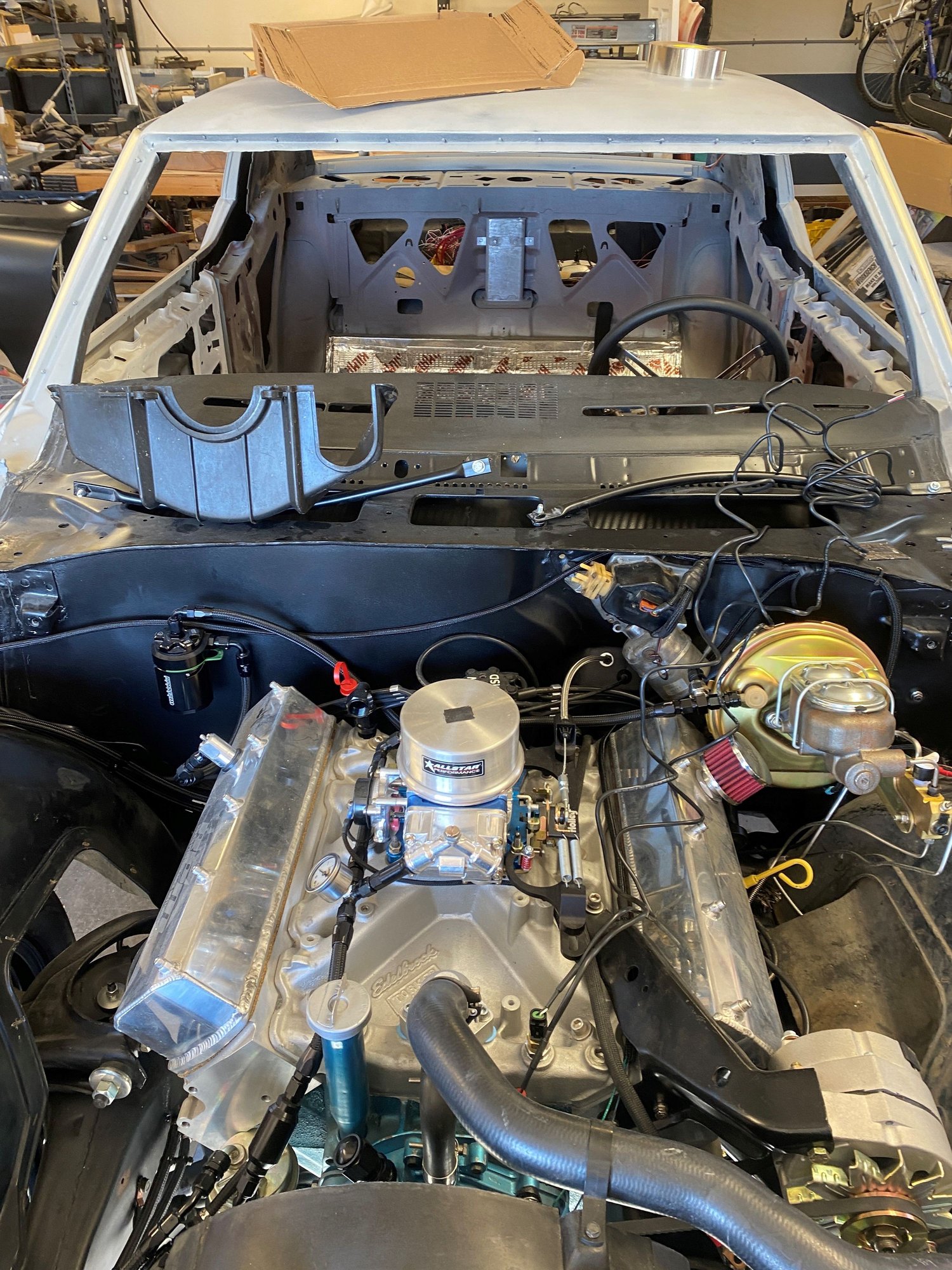

I have used those on my build. They barely clear the booster. I had to notch the alternator bracket to fit. I have air, but went with Vintage Air, so the box wasn't an issue.
Nice looking build you have there.
I'm relocating my alternator. Just need to figure out the A/C box clearance.

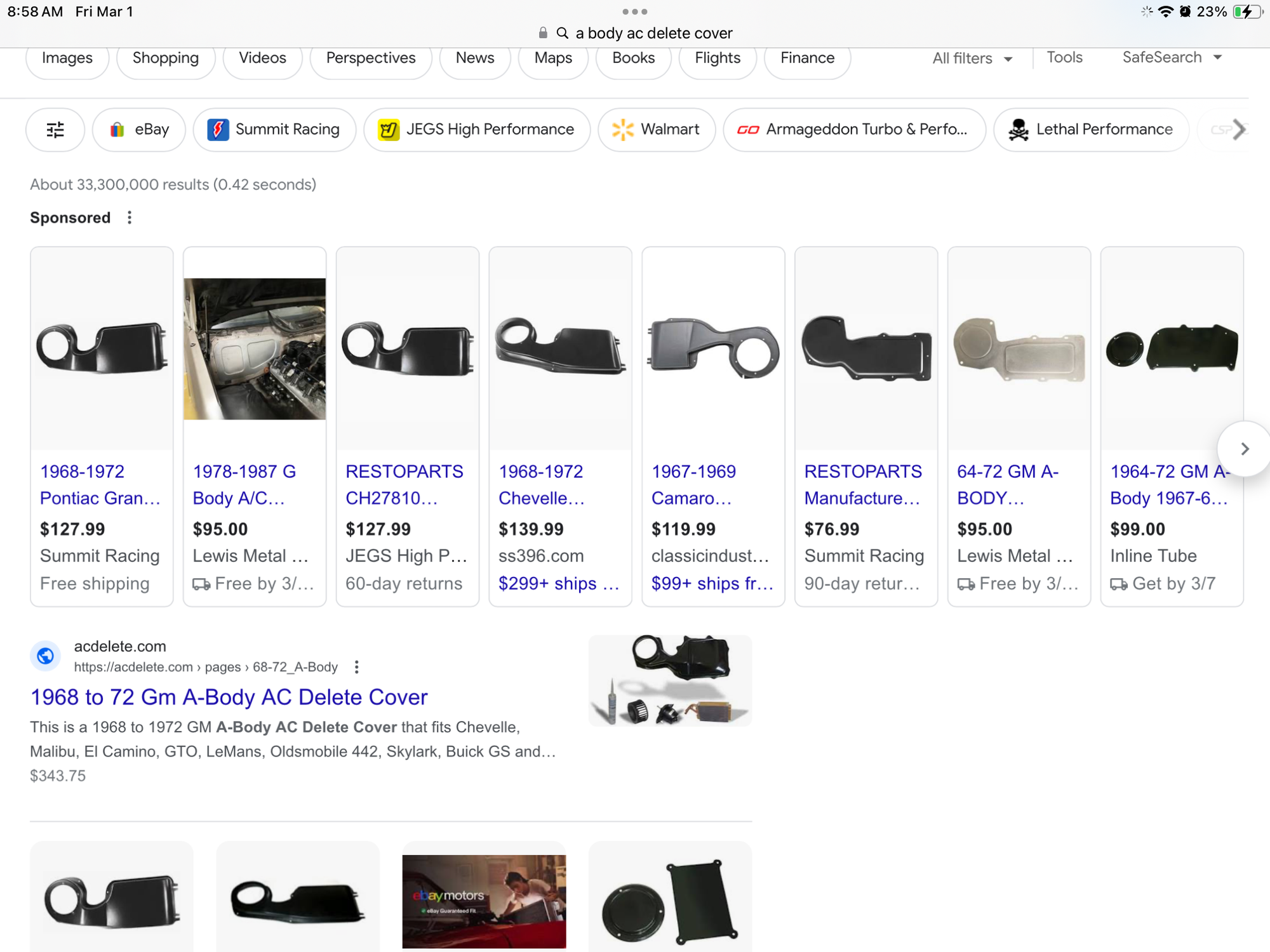

If you’re not going to use the A/C, why not remove the evaporator/box and install the aftermarket “delete” cover?
Good question.
1. It's a numbers matching car. I have every part on a shelf. I don't want to bugger it up too much by cutting or removing the A/C box.
2. I might reinstall the A/C on this engine at a later date. I have all the parts, so I won't buy an aftermarket kit if I don't need to.
