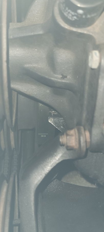

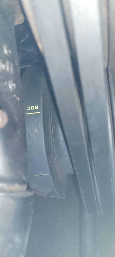

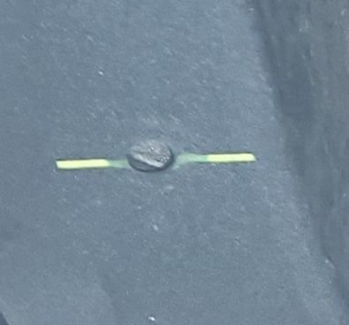

I'm trying to figure out what the markings mean on the harmonic balancer on my '72 455 Supreme, and I'm hoping someone can help me out so I know what I'm looking at when checking my timing.
As far as I know, it was installed in the mid 90s when a PO did the engine work, so it's probably been superceded by a newer version. This would also explain why I haven't been able to find any info on the inner web.
I've included some pics of various markings, and I know there's a graduated scale from (IIRC) 0-36. I will post a pic of that when I get a chance, but for now, here's what I have.
This pic shows (what I believe) to be 90 deg...
...and this pic (taken on the opposite side) shows two lines...one shows (I think) BDC which would (I'm guessing) "before dead center," Th other line is just down from that and has a "nub" right in the center.
...any ideas?

BDC = Bottom Dead Center which is 180 degrees (halfway around the circle) fron TDC.
The markings that you need for checking the timing are the 0-36 graduated marks.
0 = TDC and the marks up to 36 are the BTDC timing marks.

Ok, so next question...how do I use the 0-36 in reference to the timing tab?
