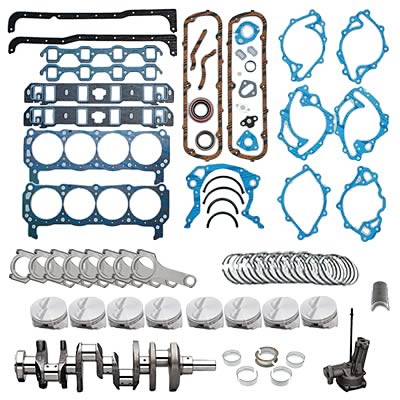

http://www.rebuiltcrateengines.com/o...30-p-2153.html
here is the kind of kit I was talking about

If u dont have money to burn u probably dont need everything that is in that kit. like the crank and rods. those pistons u can get 475$ dished pistons u can get for 330$ . bearings, gasket kit, rings (which might come with the pistons) oil pump, and freeze plugs u can get for less then 400$
so for 730$-875$ will get u the parts u need to get. that much plus the price of machining and ur done.
if u want to bore ur engine out and u told ur machinst that then yeah alot of machinist want the pistons at the same time they are doing the bore job. then they will machine it and match the new pistons to each holes at the same time. incase the pistons are differant or something. the last engine i had done. thats what my machinist explained to me. but i already had the .040 pistons.
