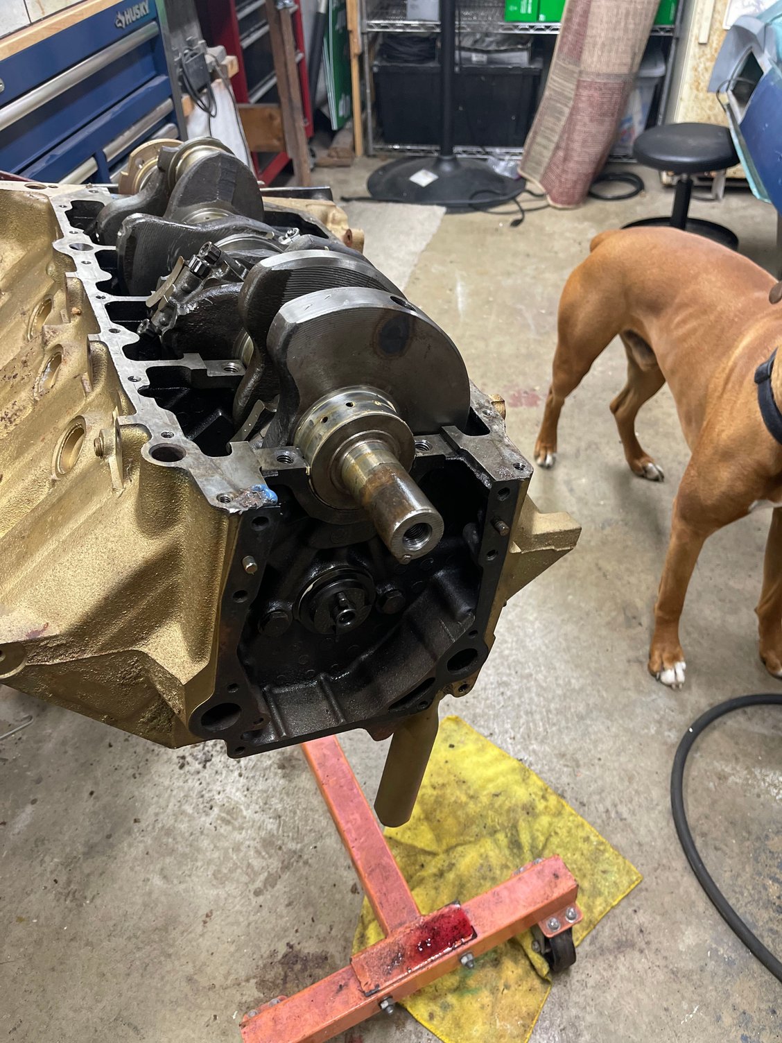

i have a seized harmonic balancer my recently acquired 65 400, what's the best way to get this off with minimal damage? it snapped off one of my harmonic balancer puller bolts, thankfully it came out easily but still no avail on the balancer. with the rubber in these balancers, is it good to apply heat? i have applied PB blaster but not working yet. thinking i'm going to stand the engine on end and soak it with some blaster.
thanks

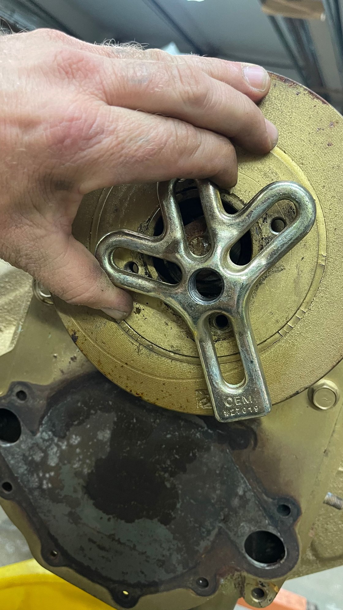

Were you using a puller like this when the bolt broke? What grade bolts did you use to attach the puller to the balancer?
I can't say I have ever seen a balancer that would not come off with a bolt on puller.

Just to be sure, you did pull the big washer behind the bolt as Joe said, correct? I forgot to do that once and sure enough I broke a bolt trying to pull the balancer.

Only two bolts line up, I know I’m supposed to be able to get 3, only one style pulled like this correct?

I've always used just two, I think that should work. Although looking at your photo, you want the puller center over the center of the bolt hole in the crank. Use the other two places across from each other on the puller.

i guess my picture should have been labeled a question. that being, is this the right puller? i did have the main center drive bolt of the puller, over the center of the harmonic balancer bolt.

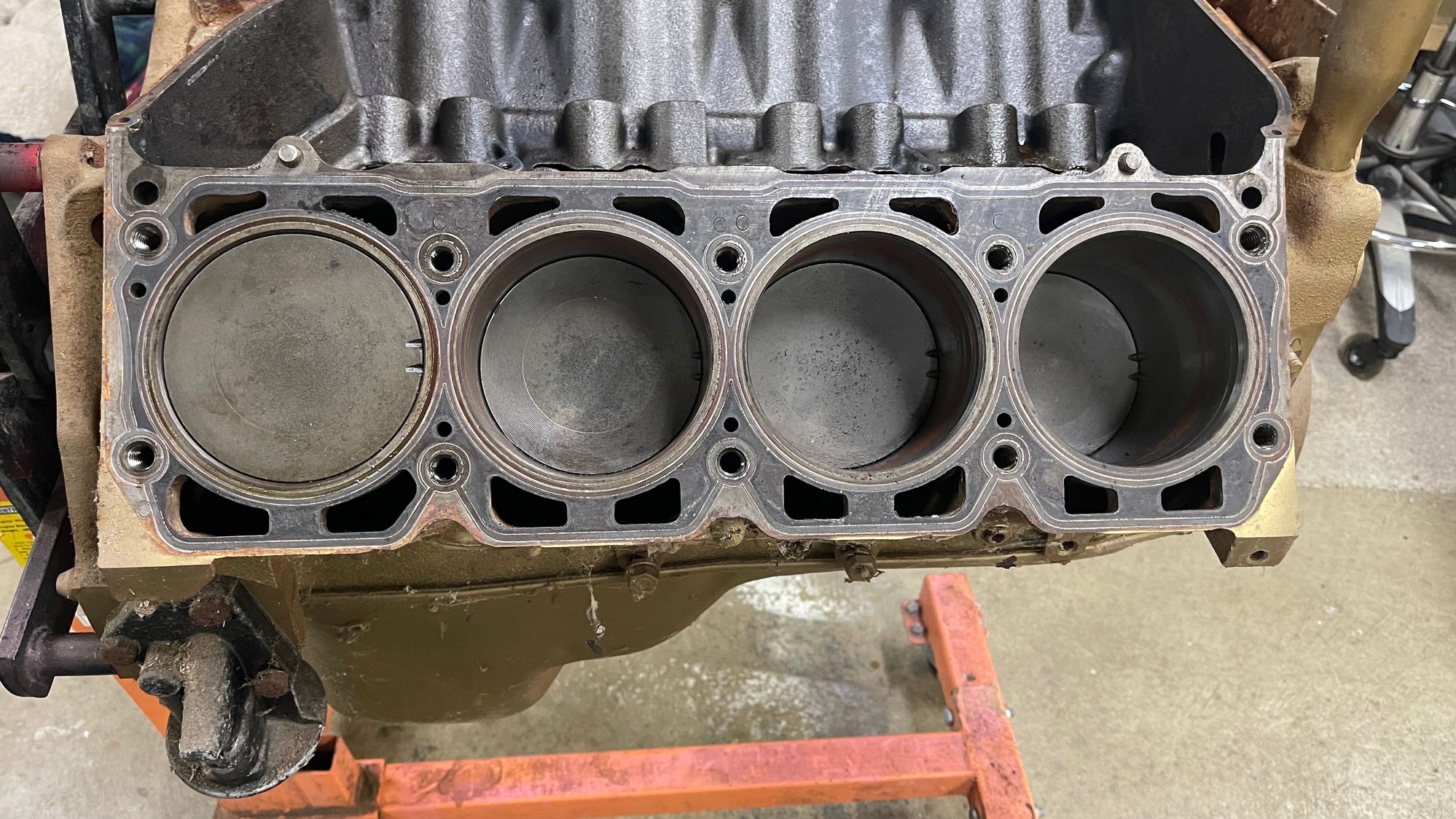

well, i've done everything correct, other than grade 8 bolts, i will have to try some of them tomorrow. this car was tore down and resto started 30 years ago, you can tell the engine was rebuilt and never fired, but it sat empty all these years so i'm pulling it all apart to have it freshened up.

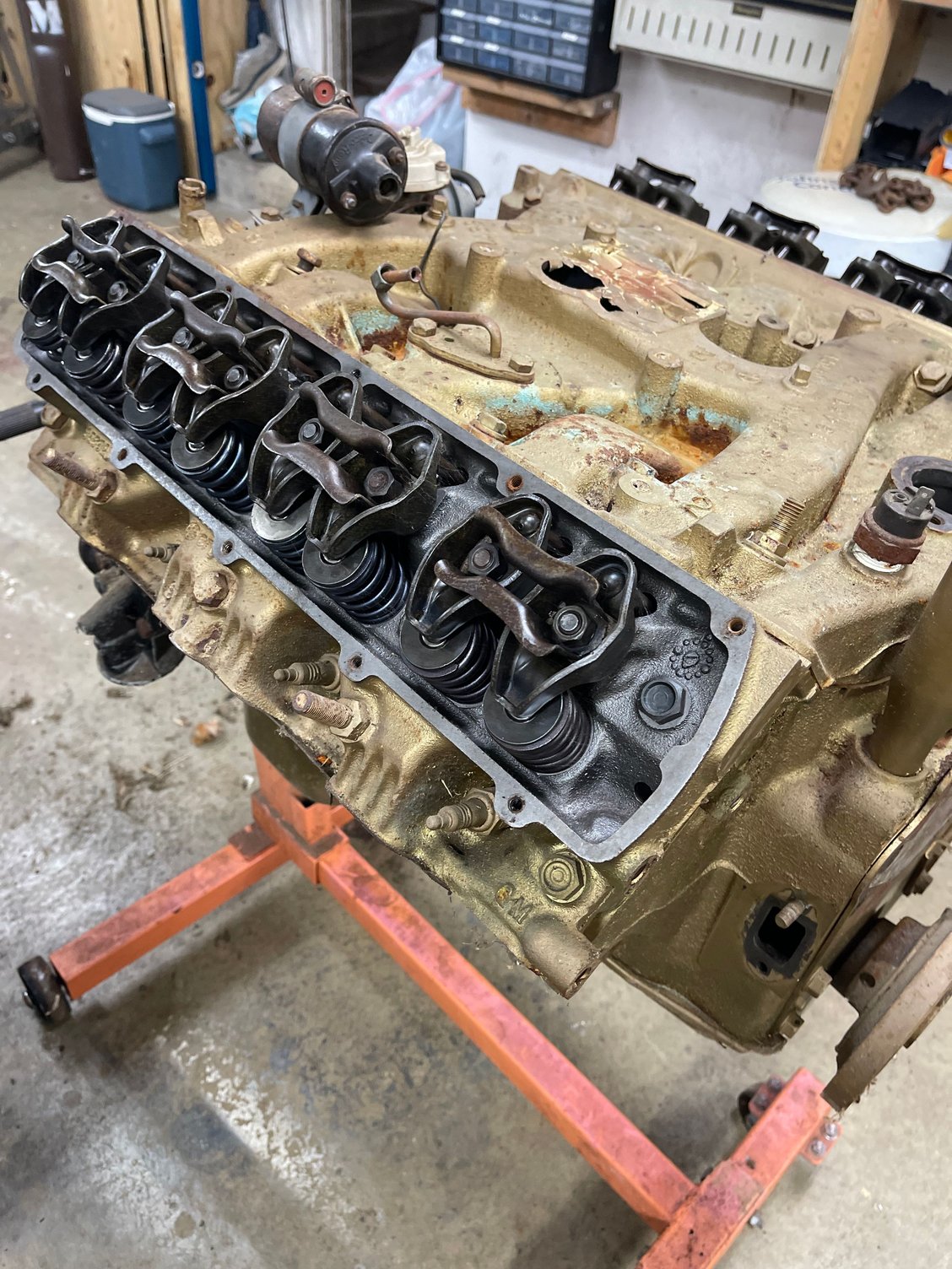

did the 65 400 come with flat top pistons? this engine has flat tops. pictures coming

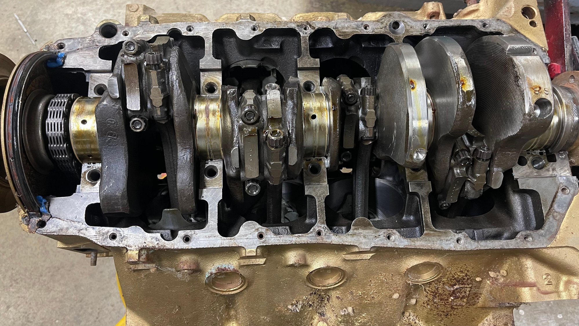

You can see how clean the head is, but the varnishing of oil on the mains goes to show how long it’s been sitting .
Yes, the 1965 400 would have come with flat top pistons. And yes, that's the pulled I use.

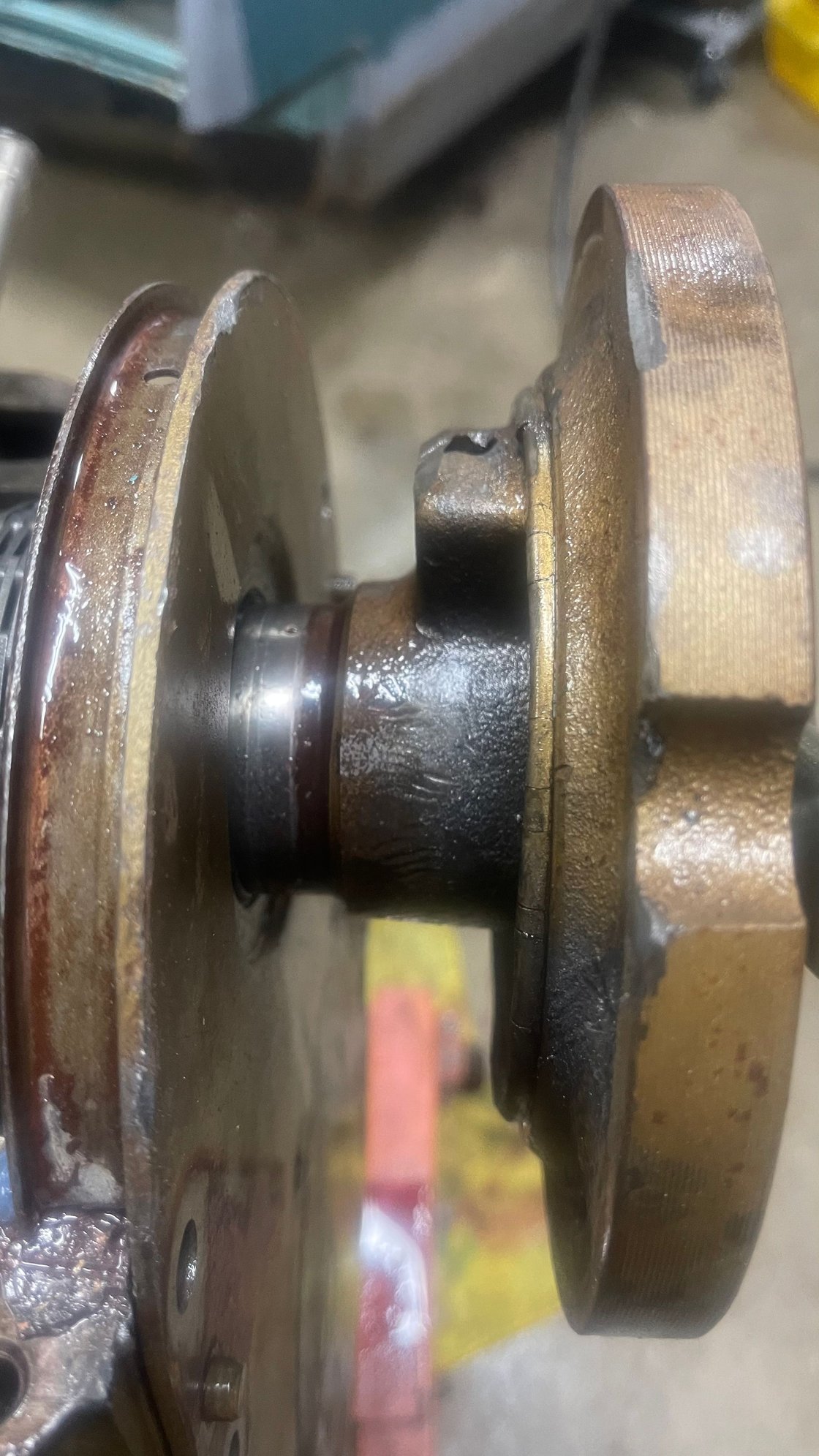

In your pic of the balancer, it looks like the bolt is still in the crank. Looks like there are flats of the bolt head visible behind the puller. Are you sure you pulled the big bolt and thick washer out before trying to use the puller?
yes, the bolt and washer was removed on my first attempt, pointed adapter for puller flush against crank, it started bending my puller bolts so i backed off, re-inserted the crank bolt to within 1/8'' of touching, therefore having majority of the threads of the bolt, into the crank shaft, giving me a more stable base to push off of, but still leaving a gap so the balancer could move when freed, still nothing. it broke one of the 5/16 puller bolts. i've been spraying it with pb but nothing moving yet. i have the puller attached with as much tension as possible without breaking anything, i am going to leaving it there over night with the engine hanging vertical from my cherry picker and pb blaster soaking in the harmonic balancer

Looks like it might have had Loctite on the snout.
my nephew suggested the same thing. with size of the bolt, and depth of the threads, not sure why anyone would ever do that.
