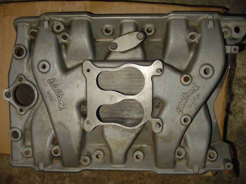

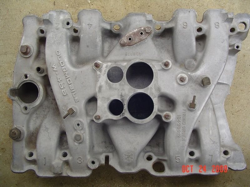

W30 or Edelbrock O4B comparison
Ran across these pics, interesting differences in design..

It's easier to compare when both photos are oriented the same.
The W30 intake is dimensionally identical to the iron intake. The wider runners on the O4B are interesting, but are they the same internal height as OEM or not? Cross section area is what matters, and it looks like the ports in the heads are the limiting area.

Thanks Joe…
The O4B runners are deeper, and the flanges probably seal better…

O4B clearly has wider runners that narrow as they get closer to the heads. Wonder if they thought that somehow helped. Also it appears that the lower plane does not have as tight vertical curvature before entering approaching the heads.

Nice pics of the early intakes. The O4B measures 3 3/4” from the carb flange to the floor, I wonder what the Winters W30 measures?

Although I’ve never done a true back to back, I’ve done similar combinations with both of these intakes. Never saw any real differences in power.
