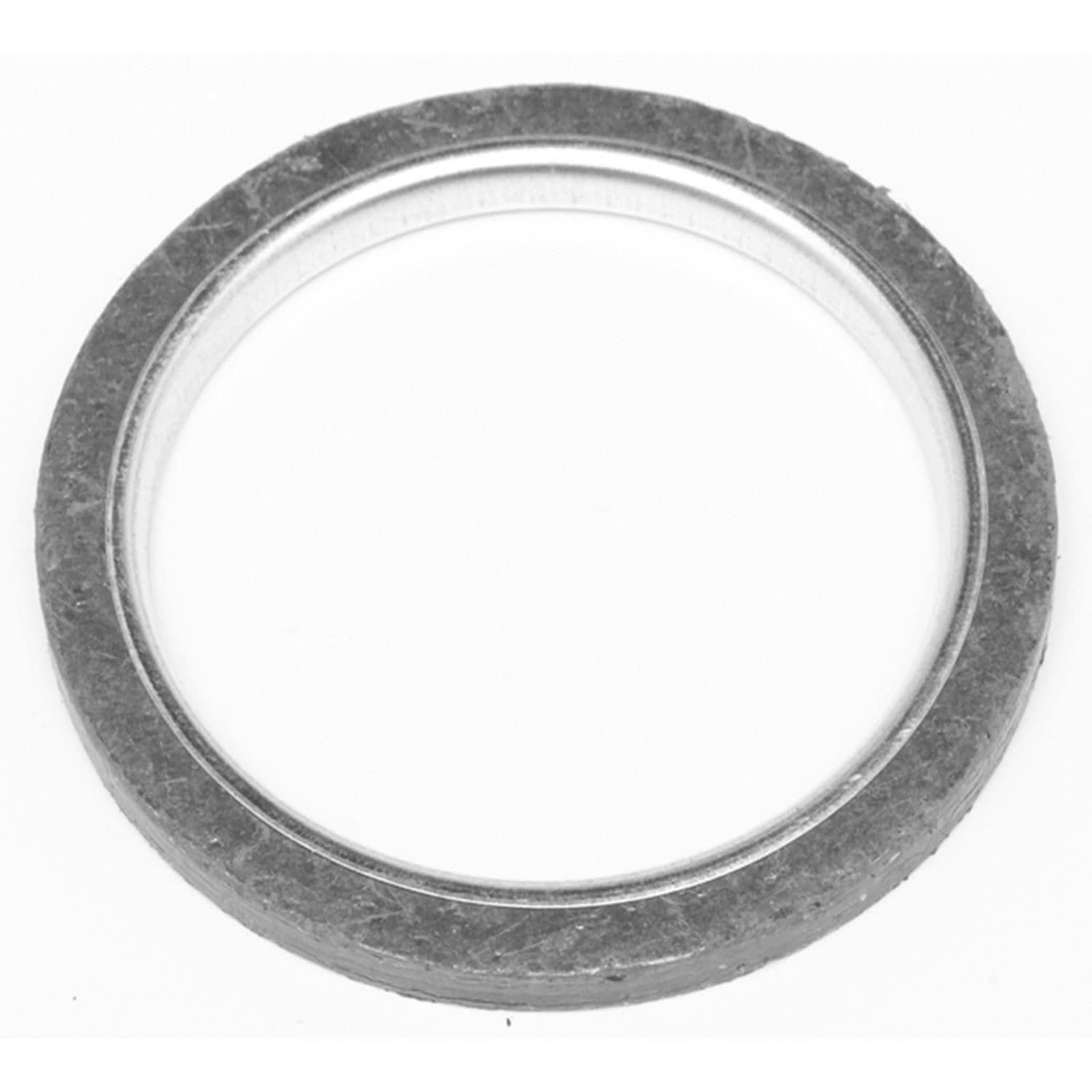

Flange gasket?
Sorry to hear your issue what about using a flange gasket?
