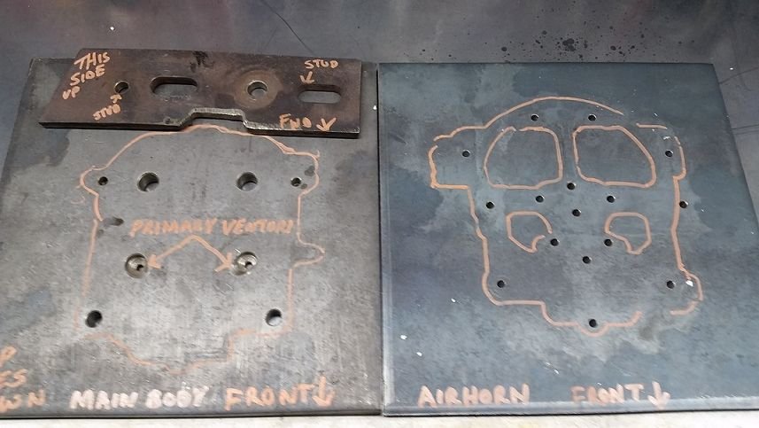

A carb change will also require throttle cable change or adjustment, fuel line change, vacuum line routing. Your 442 may wake up with a distributor recurve and carb rebuild. I hear good things about Everyday Performance they do both. I'm a do-it-yourselfer. Love quadrajets but I also like the new AVS2 design. As 4sp455 said the thicker airhorn gasket will help seal warped top plates, I use a fixture & oven to flatten castings.

Thanks shiftbyear. Everyday performance actually rebuilt the carb a year ago for the guy i bought the car from. I ordered a thick gasket and will try to flatten the airhorn. I like your oven idea. What temp and how long. Car runs great, good throttle response, good performance and still has points but the distributor is something else i was thinking of upgrading but will probably wait till I have issues with it or make other changes i.e., top end upgrade.

300 degrees, I gradually tighten every 15 min. until flat. Turn off oven with carb inside and let cool for a couple hours. Main body plate has depressions for the primary boosters. Afterwords I also resurface the bottom of the airhorn casting 80% flat on a 12" disc sander. The gasket will take up the rest.

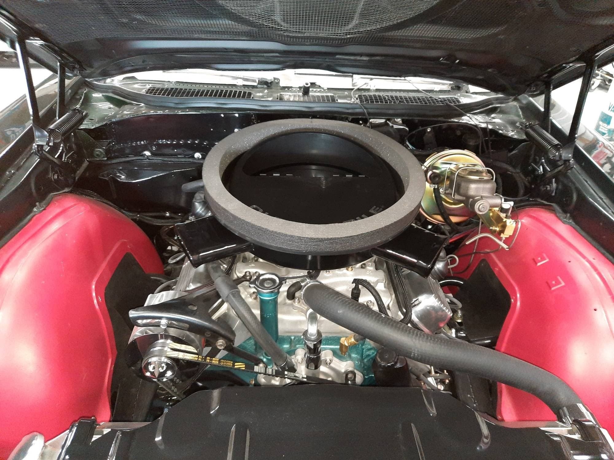

I wanted to answer your one question about EFI and the OAI hood......I just recently finished installing the SNIPER Quadra Jet EFI system on my 1971 Olds 442 Olds (455 engine) restoration and it runs amazing. The throttle body unit is similarly sized to the Quadra Jet carb so everything lines up great with the standard intake and the hood foam seal. I used the W-30 aluminum OEM intake with the fuel injection and we dyno'd the configuration at over 550 HP. The upgrade questions you pose just depend on the investments you are willing to make in the fuel and ignition systems and what your end goals are.
