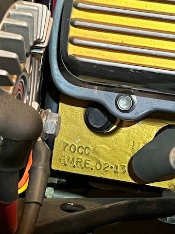

My heads came from Bernard, they are engraved with B.M.R.E. (Bernard Mondello Racing Enterprise) and a date. They were fine for 30k miles, and I would run them again.

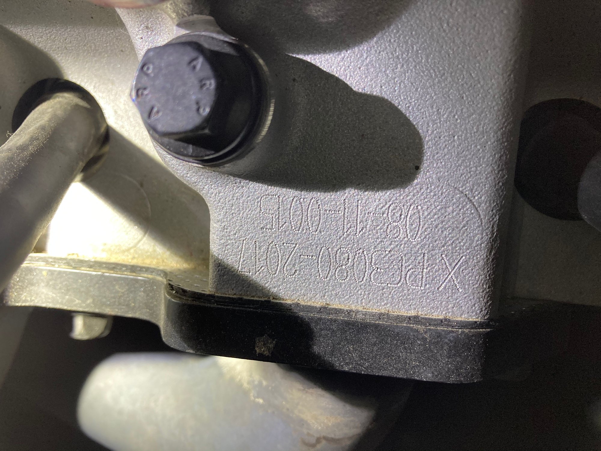

I guess that means they aren’t from Bernard, as these are the only engravings I see anywhere (without pulling the valve covers off):

B.m.r.e.
^^^This will tell you which Mondello did the heads!^^^.
I bought a set of unused but never run ProComp heads from an individual who ran out of steam and never built his car. I called Bernard to get the details on these heads before I bought them. Bernard buys the heads as bare castings and builds them with quality parts with the correct clearances. I asked my machine shop to check out the heads when I built my stroker engine. The machinist disassembled the heads to install new valve springs and set the open/closed spring pressures; he also checked the valve seats, guides and clearances, etc. and found nothing wrong with any of this. If your heads have the B.M.R.E. stamp you should have nothing to worry about.
Rodney

They do not have any BMRE stamp that I can see. I guess that's not a good sign. I am unconcerned about power as this car will be a cruiser. I do want it to run well, so I will be changing the camshaft at a minimum to a more streetable grind to work with the 2.73 gears, but I'm sure I will be fine with whatever power it ends up making. My concern is primarily with quality control, and whether or not these heads are likely to drop a valve and ruin what seems to be a good short block as well.
Bottom line for me is that if these heads come off for any reason, I'll be putting a set of stock heads back on and sell these. The only reason I might leave them for now is because they're already installed and running. But they aren't the direction I would go with this car if I were starting over from scratch, and they will definitely come off later down the road when I decide to restore this car. Only reason I'm considering leaving them for now is because I just want to drive it mostly as-is for the time being.
