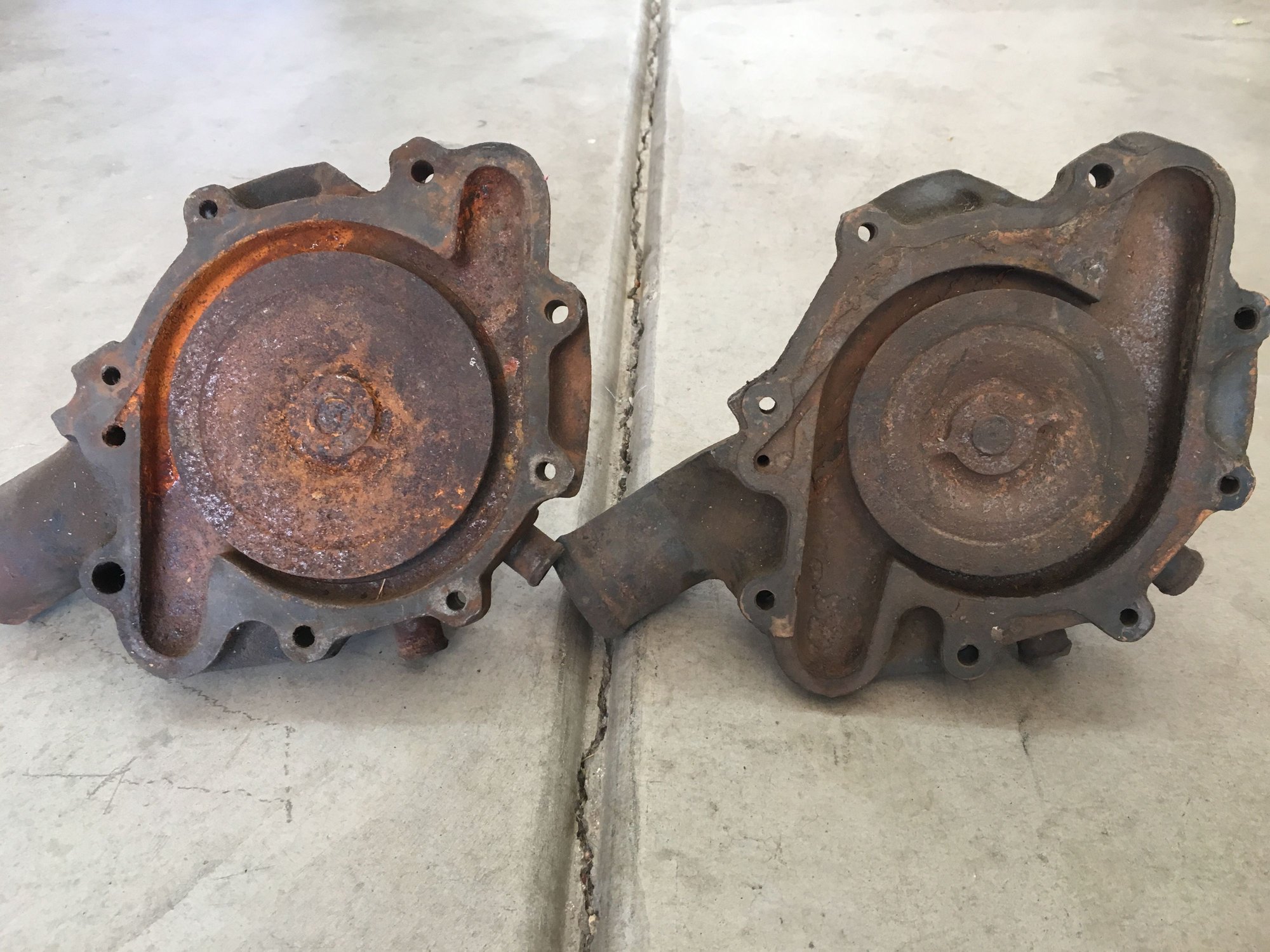

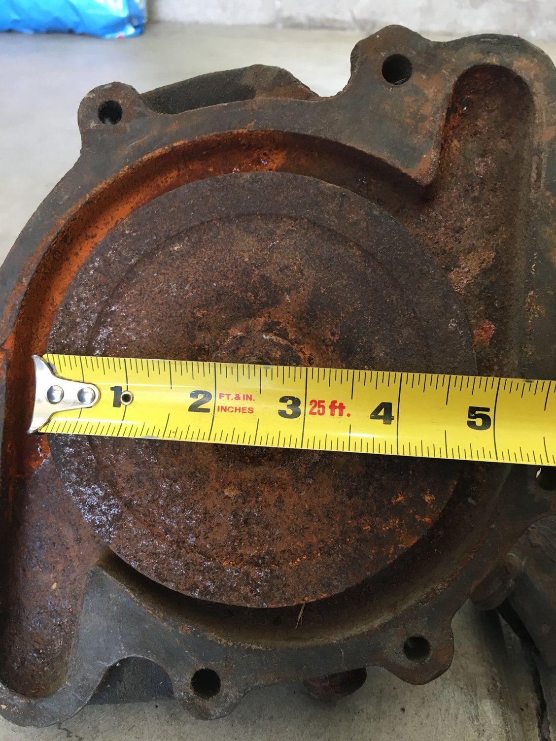

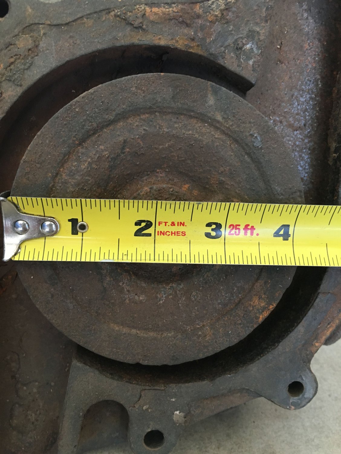

Old Apr 10, 2020 | 12:28 PM
  #55
Posts: 15,394
These are pictures of two factory closed impeller water pumps that I have in the garage. I don't know if the differences are the same for all years or not, though.
Non-AC water pump with large impeller on the left, AC water pump with small impeller on the right:
Non AC water pump with large impeller:
AC water pump with small impeller:

I second the support of flowkooler water pumps. They have great impellers & are quality parts. I use them on both of my big blocks. Looks like I last messed with this stuff in 2016, so that's a point for parts durability too. The data below is from 2 66 big cars, so it may be a little different for your A body. One of my cars is a '66 425 with no A/C, the other is a '70 455 with A/C. Both have 4 core brass radiators.
I hate over heating old cars so much they both have 160 degree robertshaw thermostats and 74 Eldorado puke tanks. I'm getting to believe 160 might be too cool, but can't quite bring myself to return to the stresses I felt long ago when I ran a 180. The cars get up above 180 anyway on longer drives, so not a big deal, just a question in my head.
Be sure the fan shroud rear of the radiator is in good shape. If you want, add a rubber seal to the leading edge of of the shroud to really seal it tight agains the radiator. Not stock, but it might help. See the Trimlok catalog for seal shapes, measure the width of the lip and get a seal with a U channel that more or less clamps on the front of the shroud. My guess is your radiator is 1/4" thick plastic for reference. Just a guess.
Next there should rubber pieces in front of the radiator. My '66's have 3 - left, right, and lower. You can get mastic rubber from Fusick by the roll & remake yours. The idea is to have those seals tight enough to force air into the radiator and not around it on the top, bottom or sides. I've just redone my Starfire and the bottom one was original factory and full of holes and tears -- meaning air leaks. If you want to get creative, cut the side seals extra long so that you can tuck the top "ears" in under radiator top plate and really force air through the radiator. With those seals tucked under the top plate, it creates a really clean look when you pop the hood too.
I think you have the word on the fan itself, my advice would be to go stock which I think is 19", maybe 19.5. I prefer the 7 bladed fans over the 6 blades, but that's just instinct, not testing. More blades = more airflow? Don't know, but I'm running 7 bladed fans now.
There's magic in the clutch fans though. Hayden has a whole catalog of clutch fans that fit our 455's. My old test resuts refer to the 2705 standard duty, 2747 heavy duty and 2765 standard duty parts. What I learned on my mid 60's big olds (can't remember - probably the Starfire with A/C) is that the 2765 runs quieter but hotter, the 2747 is noisy and cool. I'm running the 2765 now and have since 12/2016. It looks like the 2772 and 2797 may also fit mid-60's big olds. What Hayden varied in standard vs. heavy duty was the cut in temperature, length of the clutch fan fore/aft, and depth of the clutch fins. HD clutches cut in at a lower temperature, SD clutches run quieter and cut in at a higher temperature. Then the question is how long the clutch should be. The rule of thumb I recall is to have your fan blades halfway in the shroud, with the rear half of the blade out. Mine aren't quite that, but close.
Here's an online catalog for Hayden cooling parts: https://www.pageturnpro.com/Four-Sea.../sdefault.html
FWIW I briefly tested some Dorman plastic modern fans to see if 11 or 12 smaller blades would pull more air. They didn't help. Factory style was the way to go for me.
