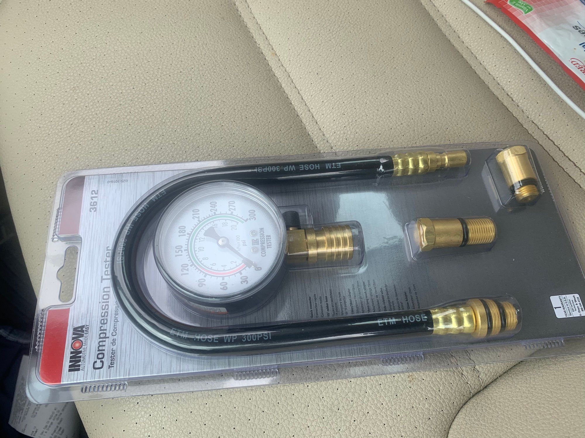

Ok went down and bought one of these. It did not say it works on 70s Standard non metric threads. But does say “domestic”.
i am guessing I plug it in each spark port and crank engine with coil disconnected? Or do I hand turn engine?
Old May 30, 2020 | 11:44 AM
  #43
Posts: 25,789
Yes. Disconnect coil wire to eliminate off chance of starting (and random voltage/amperage). Eric (video) does a decent job of performing a basic compression test. Often times, many of us will perform a dry & a wet compression test. That is completely up to you. But, I will say this. If you're going to the length of performing a compression test, you'll be able to better gauge overall condition of the engine if you perform both a dry & wet compression test (since you're already spending the time to do the dry, it makes sense to do the wet at the same time). Perform the dry compression test on one cylinder. Insert ~1 tablespoon of automotive oil into the same cylinder you just performed the dry compression test - best if you can 'spray' the oil into the cylinder if possible (you will now be performing the wet compression test). Record your readings for both dry & wet for each cylinder. At the end of the day, you'll gain some insight of 'possible' issues you may have w/ (as an example) piston rings. Should the wet compression test indicate a higher compression than the dry compression test, it might suggest piston rings are failing e.g. not sealing (since the oil will act like a seal between the cylinder walls and the rings increasing the compression w/in that cylinder). There are other possible tell-tale signs of engine wear, but don't worry for the time being, perform both a dry & wet compression test on each cylinder recording your findings of each. The numbers can be addressed once you have obtained them.

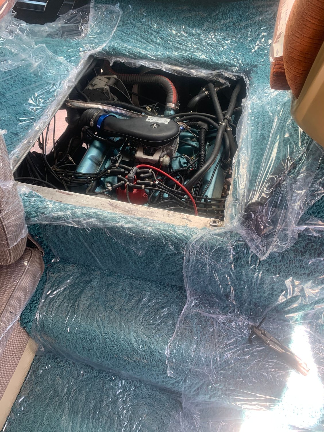

Ok. Catching up on mornings activities
1. Yes. I took the mechanical fuel pump totally off. It was only ever used to break in engine 3 years ago. It just sit there pumping air in and out. Neither end connected to anything.
2. The probing with broom pointed at 1 or 3 area of the engine. Loudest near top of block just below the Head.
3. once my battery was fully charged again I tried cranking. I heard the noise CLUNK while cranking. Since my previous efforts eliminated the pulley system, the flex plate, and there harmonic bal is free and clear to move with no binding.... and taking each spark plug out revealed the sound is there with or without firing... it is something INSIDE the engine.
4. This morning I started stripping the engine of accessories, throttle body, hoses, drained fluids, removed starter, disconnected flex plate (again checked it and looks fine. No cracks. Put a Engine lift plate on top and I am ready to yank it up and out.
5. I need an engine gantry and trolly system to do this. I borrowed one when I lived in CA but I am now in Central NY. So I am going to local metal sales and fab shop to have one welded up. Once that is ready I can take the motor to machine shop and have a pro rebuild it.

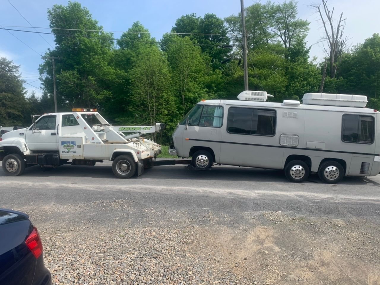

Old Jun 5, 2020 | 12:30 PM
  #76
CuttyShark's Avatar
Joined: Feb 2015
Posts: 356

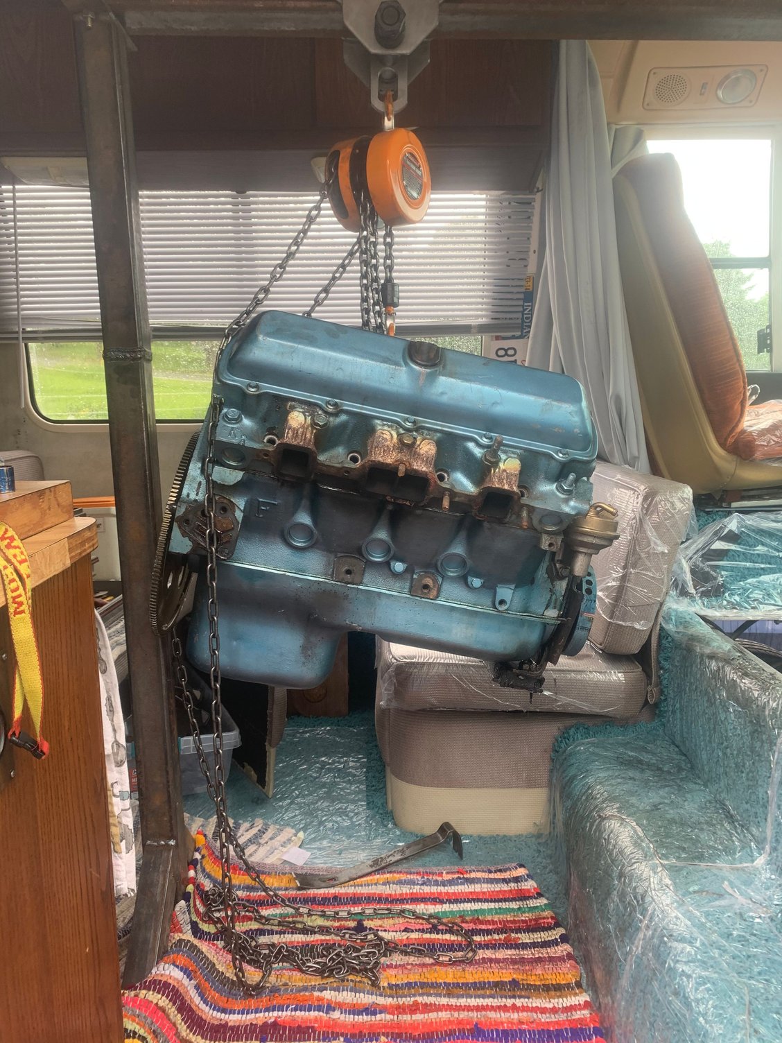

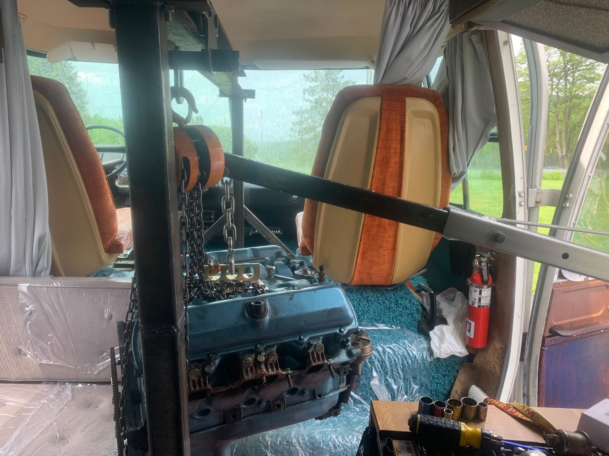

Up and out it goes

Looks like quite a project getting that out .
Old Jun 5, 2020 | 01:49 PM
  #78
Posts: 25,789
I'm betting lifting it out of the vehicle was the easy part - getting into the motorhome looks like the real challenge. Happy for you you're moving onto the next stage.
