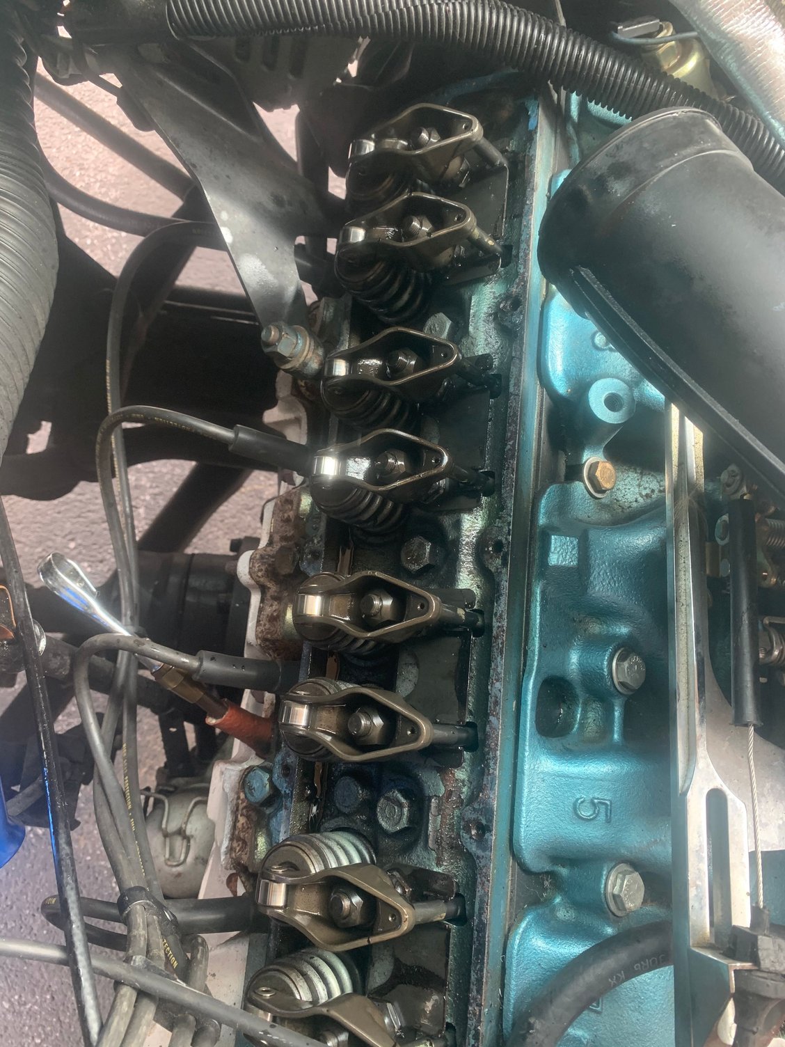

Just disconnected distributor and cracked engine watching the rockers. They all move up and down.

seems fine. They are ARP. Torqued to spec. Each rocker was zero lash when installed. Looking at the wear on the push rods against guide plates seems to indicate they are all moving.
You say zero lash, if your not running a solid lifter cam hydraulic cams require at least a 1/4 turn in from 0 lash.

I was just thinking, is there a heat riser on the exhaust manifold?
nope. Never had one.
is there such a thing as an intermittent stuck valve or any reason an occasional misfire would happen?
what does a burnt valve do?
Old May 30, 2020 | 10:08 AM
  #40
Posts: 25,789
Originally Posted by CuttyShark
Sound is coming from front driver area of the block. I dont hear anything odd in the valve cover. Not sure but that looks like paper is getting sucked in?
Could be. You'd need more 'tissue' rather than paper to demonstrate if it's really getting sucked in. Check out the (below) video. Also, perform a compression test you should see a noticeable difference in compression (or, a leak-down test). That should help determine if you're heading in the right direction regarding a malfunctioning exhaust valve. Although, I'd think the sound would be more rapid than what it appears to sound like. At any rate, perform a simple compression test and possibly fine-tune your probing.
