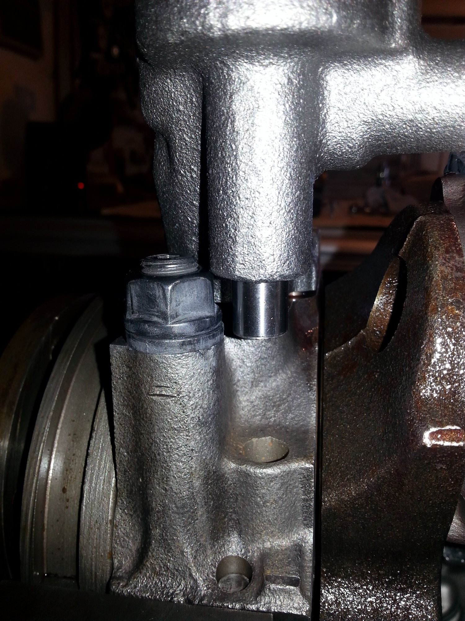

I purchased this sealed power high-volume oil pump for my 455 build but it has a couple clearance issues.
https://www.summitracing.com/parts/slp-224-41203v
It's hitting the ARP main stud nut. I found a 12 point nut that is much smaller but I'm also having clearance issues with a rod cap, or I will if I get the pump to sit properly on the block.
The stock pump also has clearance issues with that stud nut but would not with rod cap.
Anyone know of a pump, preferable high-volume, that won't have the issues?

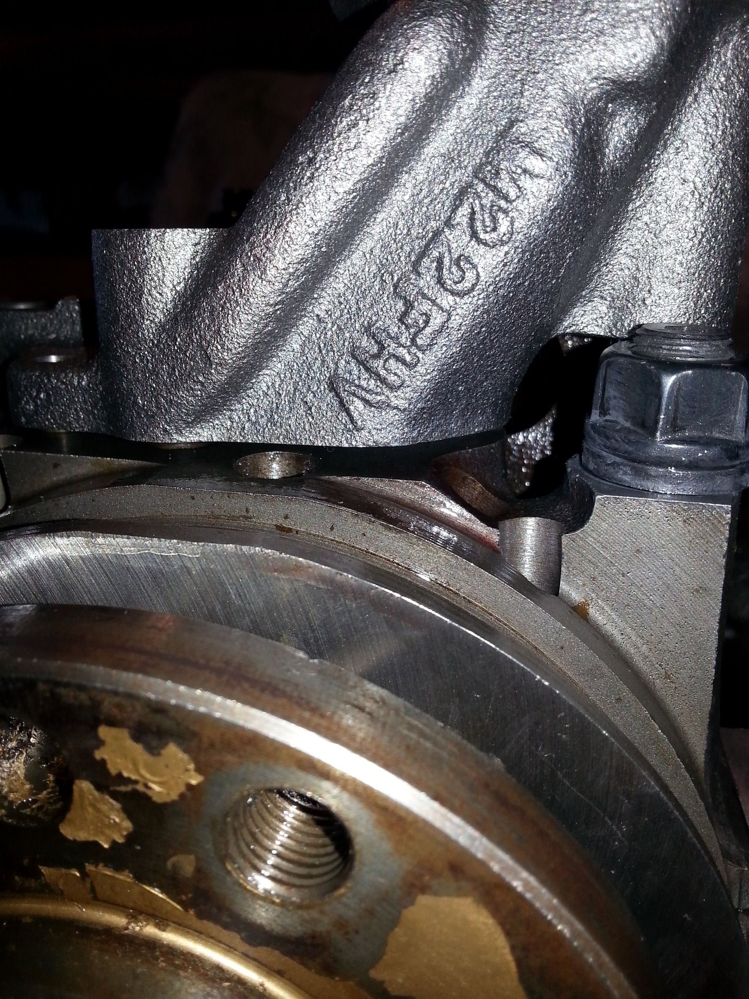

Look at the 2nd pic. M22FHV
Melling part # on Summit: M22FHV
https://www.summitracing.com/parts/mel-m22fhv/reviews

A die grinder and about 2 minutes and problem solved.
Just be sure that the pump sits flush and tight to the cap.
That is a very tedious problem to fix once the engine is in the car.

X2. Melling/Sealed Power/Clevite are all the same pump.

Grinding down the pump housing yes? But in the two different spots? I'll take another look but I think I'll get into that axle behind the cotter pin before I get clearance there.
Surely you're not talking about grinding down the stud nut.
I don't suppose I could get away with (safely) a stock pump with just under 3k clearances at the crank. Closer to .0028". Less grinding on a stock pump.

Hmm, ya got me. Not sure why a bolt will clear with no problems but not a nut?

If you can fit the thickness of a tie wrap between the rod bolt and pump then you're finevthere.
As for the main nut clearance, disassemble the pump and grind it. It's not a difficult task. I do it on every engine I do.

Alright fellers, problem solved. It just took me a minute to wrap my head around grinding on a $100 part.
@Mark: Thanks, I was just going to ask that very question. I would say I have more than a ... wait...what's a tie wrap? A twist tie? Lol.
The counterweight became an issue as well but Had a lot of wall thickness to work with on that part of the pump.
I'm good to go now. Thanks guys! I guess this is the stuff they don't put in the CSM.
