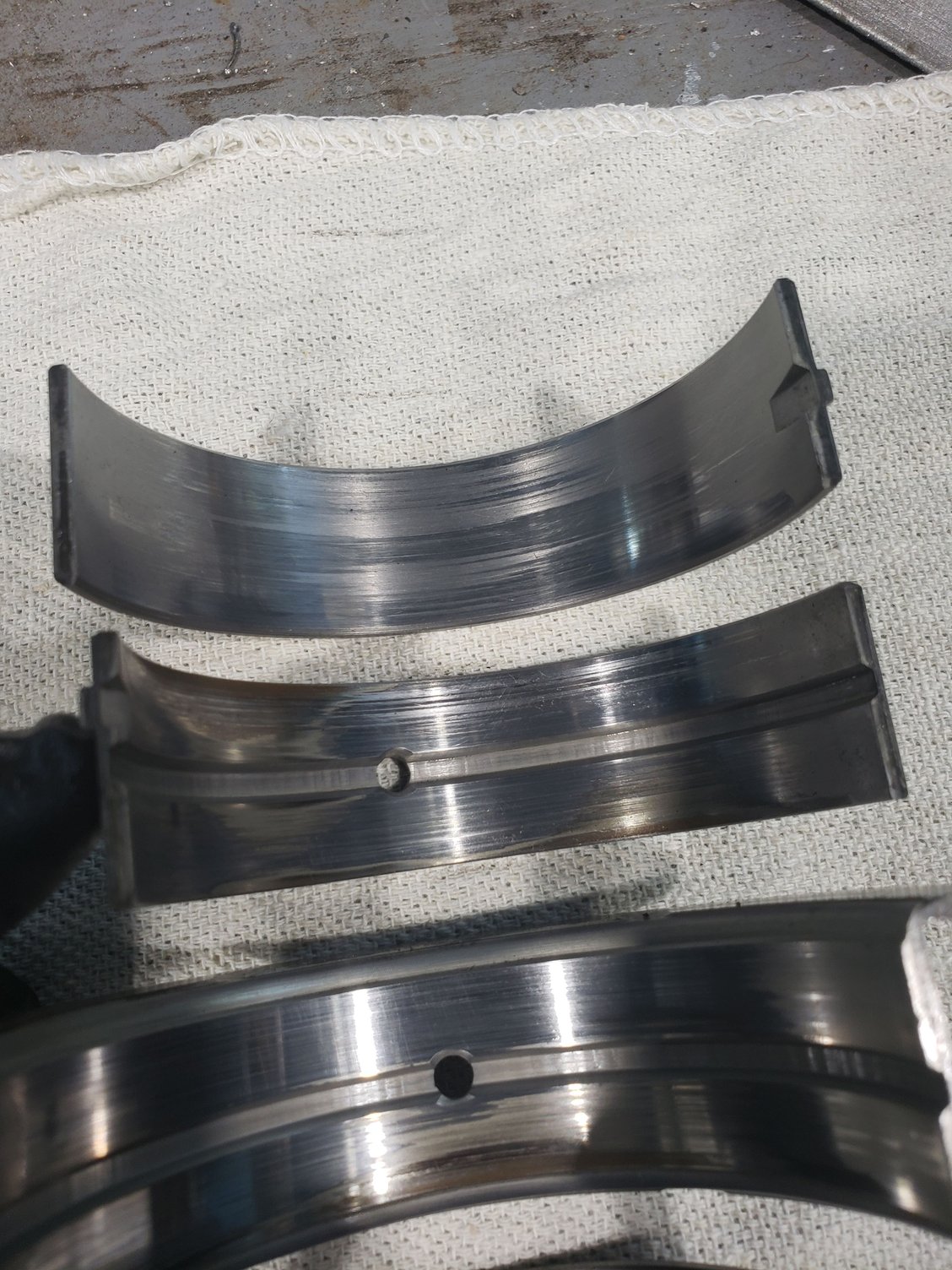

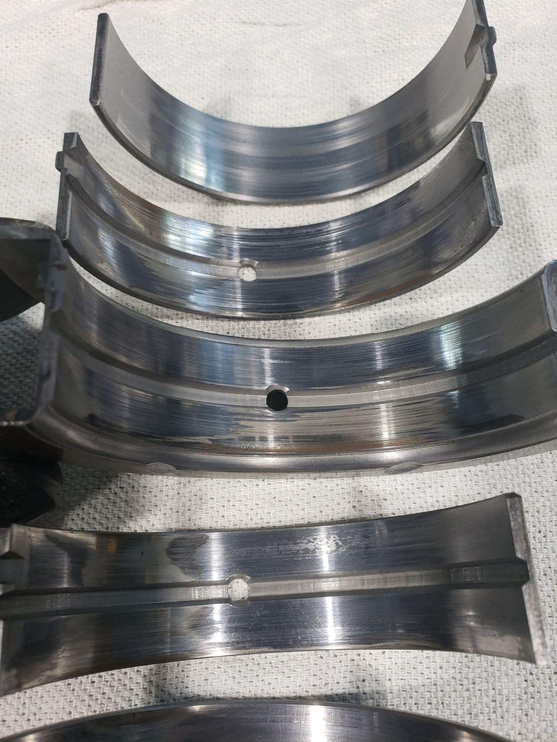

Hey guys, hoping to get some insight from y'all.
I recently pulled the 455 out of my 67 CS so that I could convert the car over to a manual tranmission. I took the crank out so that it could be machined for the pilot bearing/input shaft. I was cleaning up the caps and bearings and noticed some wearing of the lower portion of the bearings. What do you think? I had the engine rebuilt about 9 years ago and has maybe 1500 miles on it. Would you reccomend replacing the bearings at this time, since its apart?
I am picking up the crank on Monday and will inspect the journals for wear here. I assume if I do see wearing on the journals I should have it addressed while at the shop.
Any feedback would be greatly appreciated.

Did you measure anything to determine the bearing clearance you have ?

If you're concerned you can get some Plastigauge to measure your bearing clearances. I'd call that wear normal for 1500 miles. Just use assembly lube and put it back together.

I dont like the fact that the thrust bearing has copper showing at 1500 miles. You need to properly check the main bearing clearances with a bore gauge. Plastigage is ok for a quick check but really not that accurate. Do you feel comfortable with the machine shop that is doing the crank for you ? Ask them if they will check it for you. If nothing else clean it up real good and put a new set of bearings in and torque the caps down and ask them to check it with a bore gauge and compare it to the crank size.
Most of the bearings look like there is not enough clearance.

This was what concerned me as well. Once I get the crank back I will get the clearance measurements.

They all have copper showing, except maybe #1
looks way to tight by the wear being all the way to the parting line.

Take the bearings with you to show the machinist. You may want them to polish the crank while it's out. Then again a good shop would recognize rod/main surfaces that need work.

Ok, so it took me some time but I was able to measure the main bearing journals and determine the current clearance. Below is what I was able to come up with.
1) The crank at some point in its life was ground down, I found "010" marked on the counterweight. When I measured the main bearing with the mic I came up with 2.9892 for journals 1-4 and 2.9949 for #5, which I believe confirms it was previously ground down.
2) The existing main and rod bearings are all .010 (all lower half of the bearings are showing signs of wear)
3) Main Bearing #1 = 0.0004 Clearance
Main Bearing #2 = 0.0003 Clearance
Main Bearing #3 = 0.0003 Clearance
Main Bearing #4 = 0.0003 Clearance
Unfortunately at the present time I am not able to measure #5 but I will. However, from what I am able to tell from the service manual all of these are well below the allowable clearance range of 0.0005 - 0.0021 (#1 -4) and 0.0020 - 0.0034 (#5). I also plan on measuring all the rod clearance as well but I wanted to provide this information.

You are correct, the numbers you have provided show insufficient clearance.

That is definitely tight which explains the way the bearings were wearing. The #5 journal is also way too big, it should be the same as the others.
How are you measuring the clearance ?

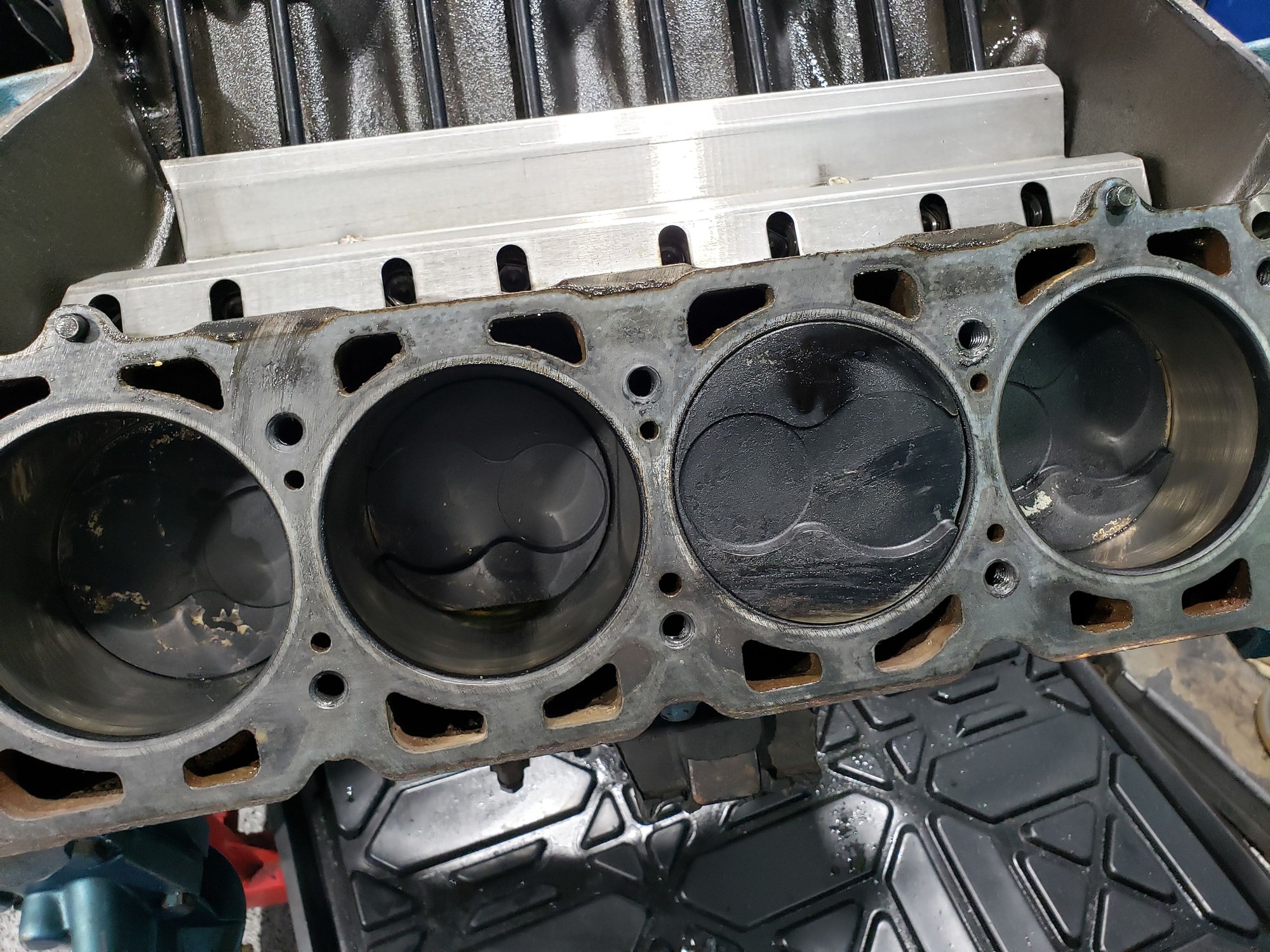

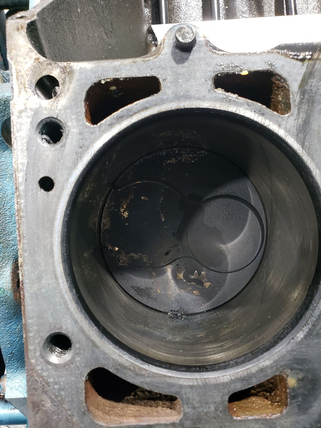

Unless I am looking at this wrong, those look like the Icon forged pistons with only 14.4cc dish.
here: https://www.jegs.com/i/United-Engine-Machine/648/IC886.030/10002/-1
With an 80cc chamber, that puts you around 9.89:1 compression with a 4.155 bore, .010 deck clearance, and a .043 thick Fel Pro head gasket…. +/-
corrected above, thanks Bubba!

Originally Posted by Battenrunner
Happy to help get you going in the right direction!
here: https://www.jegs.com/i/United-Engine...6.030/10002/-1
With an 80cc chamber, that puts you around 13:1 compression with a 4.155 bore, .010 deck clearance, and a .043 thick Fel Pro head gasket…. +/-
Was it rattling from detonation like crazy?
what do the rod bearings look like?
You fudged a number there. Using your assumptions its a 9.89:1 compression ratio. If I had to guess I'd say you subtracted the piston dish instead of adding it.
Yes they are Icon premium forged pistons IC886 .040
https://www.summitracing.com/parts/uem-ic886-040
The rod bearings are also showing some pretty gnarly wear similar to the mains.
Argh!
you are right, I put a - in front of it, but it didn’t insert it in the calc
looks like 9.89:1 to me also now
I was getting all excited
The block was bored 0.060, If I did the math correct I think it is 10:1.
