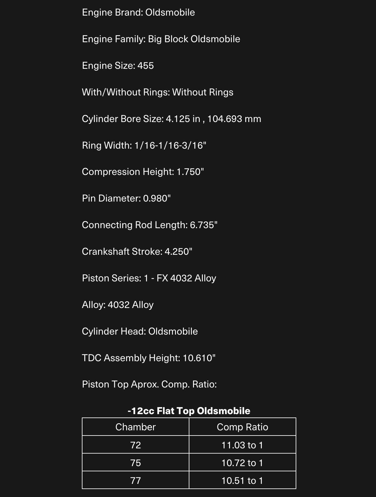

Hey guys, I'm currently restoring my olds which has a 1974 455 engine with 8.5:1 compression. How much can I bump up the compression numbers by replacing the stock dish pistons (40cc i guess)
with aftermarket pistons on a stock engine block? I found these Forged pistons by DSS Racing are they correct for a stock block and what do you recommend, i'm open for opinions as this is the first engine I build. Andrew

You’ll get about a 1.65 point increase in comp ratio to 10:1 with those pistons…the actual measured comp on the late 455’s is approx 8.35
thats with an 82cc head and the stock type fel pro head gasket.
Thanks now I have a clearer idea, is it healthy to run this compression or should I is it better to go for slightly lower numbers? Lets say I will add headers, port match and polish the heads and intake manifold, would this have any effect on the compression and have it to high to use with regular fuel?

Andrew, doing those things will improve the engines breathing ability but not change the compression ratio and no it would not negatively effect the use of regular fuel (still using pump gas per post 2)

There is nothing wrong with running 10:1 , you just can’t go to small/mild on your cam choice..
once you know what heads , gears , converter and a few other things, we can give you a ballpark on the cam choice.
