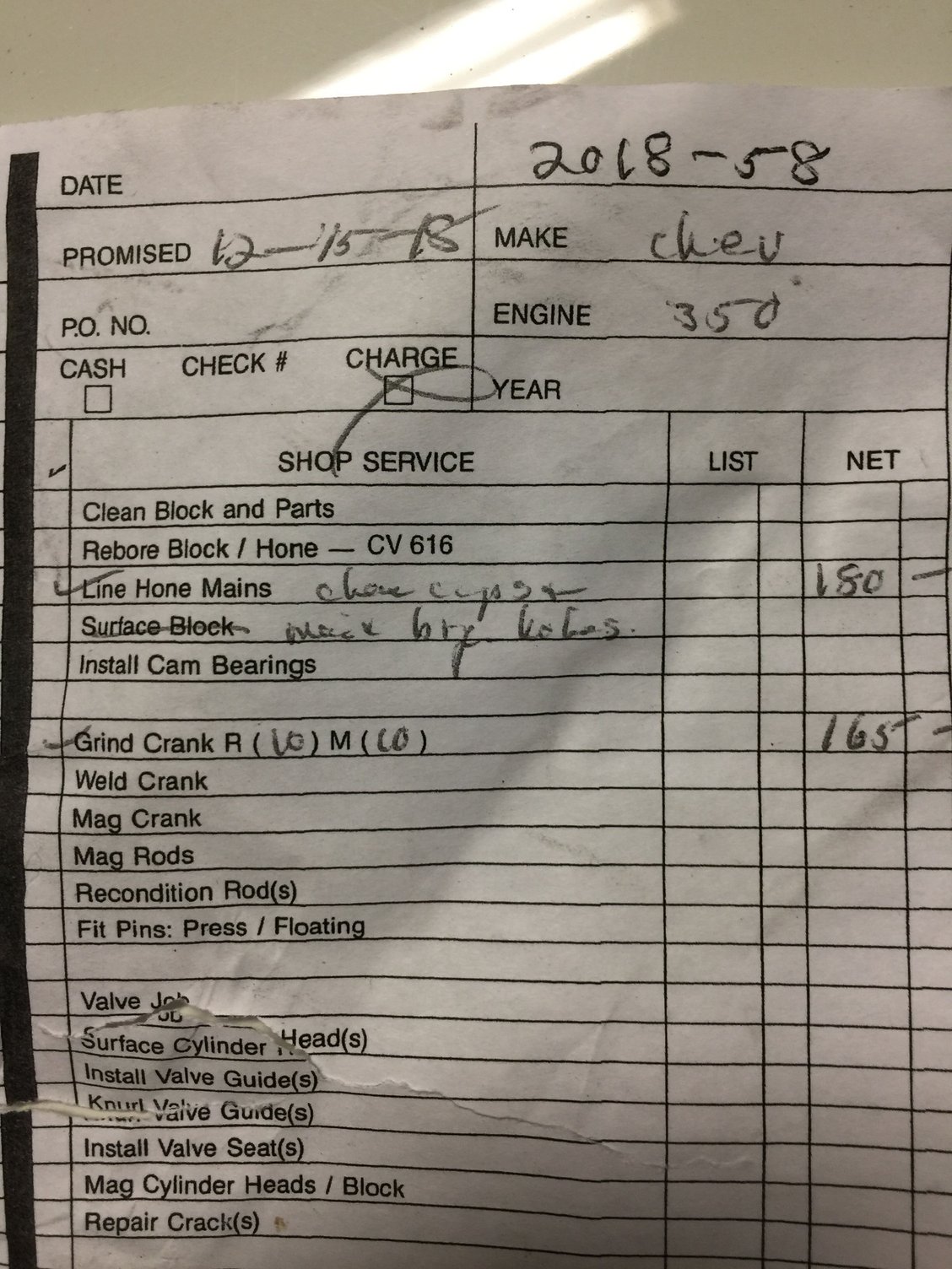

Here's the variation I measured after the line hone.
1 - 3.1886”
2 - 3.1886”
3 - 3.1890”
4 - 3.1892”
5 - 3.1892”
On the other hand I found the main bores on the factory block all measured within .0001"
My ARP 185-5001 instructions specify only ARP lube to 100 ft lbs.

Unacceptable variance plus you’re over the high on 4 and 5. Like I said he did a crappy job. His stones are tapered on the arbor, he should’ve flipped the block around. I’d have him redo it.
Thanks for pointing that out. What's the acceptable range? The engine is already in the car and running. But I was planning to pull it in the next few months, anyway.
Old Oct 15, 2019 | 05:07 PM
cutlassefi's Avatar
Posts: 8,485
From: Central Fl
Mine are held to no more than a couple of tenths.

So essentially the stones are cone shaped and honing from both sides would average out the bores within 3 tenths. Because right now I’m out 6 tenths

Most shops around here don't even have line hone at all.
He did a good job on my Chevy 4 bolt main 3970010 block that he worked on a year after the he did the 455. Chevy block was within .0002"
I'm sure he'll redo the 455 block for me when I bring this to his attention.
