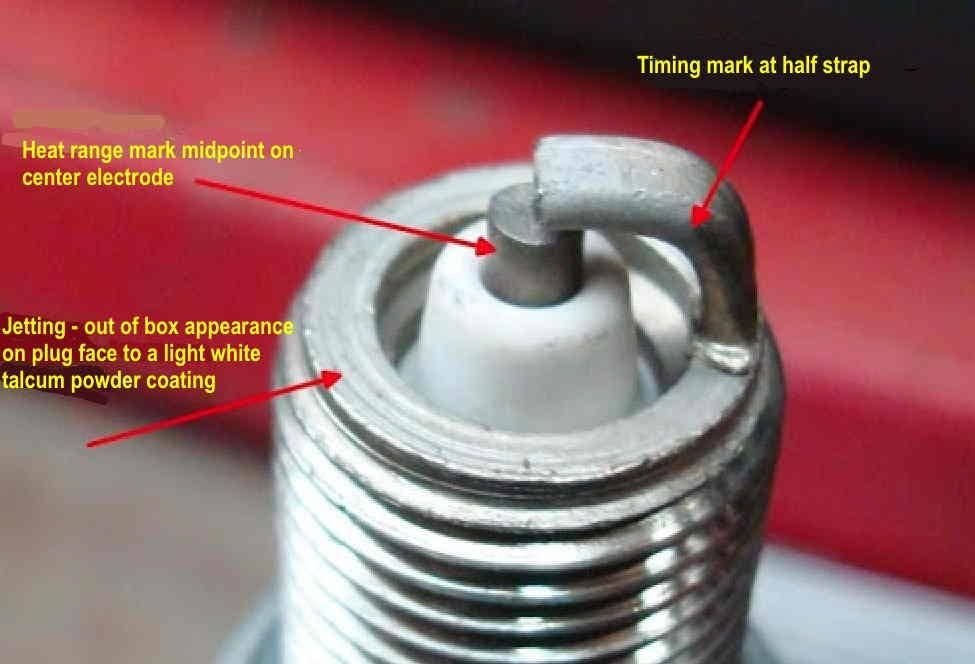

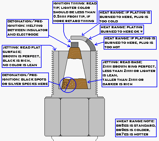

Curious as to what could contradict. You're getting a definite result directly from the combustion chamber. I'll admit; it can be a rabbit hole, but the fundamentals apply. You don't need to get crazy and cut the threads off to see the base of the porcelain for a decent read on what's happening.
Link for this one, as the text is separate from the photo:
https://fboignition.com/articles/sparkplugreading
All of these say something different about where to read jetting, timing, and heat range. One claims you can read idle, midrange, and WOT jetting off the spark plug whereas others, on this forum even, will say the only way to read a plug at WOT is to shut it down immediately after the pull.
So which is right? And what authority is there to your answer over any of the others? I'm unfortunately coming across more harsh and argumentative than intended here - its just that reading plugs does not seem to have any kind of consensus other than what they look like for VERY bad tunes. So I find it hard to trust this as a meaningful way to diagnose much of anything.
I'm not trying to start anything, but every good tuner on the planet will at least look at the plugs. Lean is white to off white as shown in the second pic. The first involves removing the threads. Let's call that the advanced class.
My point is about data collection. The more you have that agrees, the better chance you have of finding the problem. Let's say your AFR gauge is reading lean, as it is, but your plugs are wet and fouled on a couple of cylinders. Are you more likely to believe the gauge or the plugs. Personally, I'll take the plug read.
When I was tuning my idle, I called the Holley tech line, and was told to ignore the AFR and use a vacuum gauge. It makes sense to me. AFR is helpful when doing part throttle stuff. However, if there's a leak around the O2 sensor or it's too close to an opening (open headers), they're pretty well useless.
I also was not trying to start anything, just pointing out my frustration with the whole "reading plugs" thing and how many conflicting versions there are of reading them.
We also may be talking about very different applications for an AFR gauge. My car is fuel injected and it is critical to have no leaks around it and plenty of exhaust length behind it. It works perfectly fine at idle, off idle, cruise, and WOT. If you're running open headers, then yeah, it isn't going to work well. Huge cams also can cause issues at idle but smaller cams generally don't. Even then, I can definitely concede that you're only getting an average of one bank. It won't tell you if one cylinder is super rich and another super lean. Again, I think reading plugs is certainly useful for horribly out of tune situations. I just can't buy into fine tuning with them until there's an actual consensus on how to read them.
