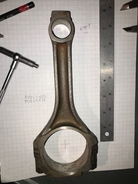

Next question, a set of rods came with engine, how to identify them? I quickly miked them Rod: 2.625, Pin: 0.978, Length (center to center - rough): 6.75, Big End Width: 0.937. Looked in Travato's book and my numbers pretty much match his except for length which I just estimated using a ruler and graph paper - could easily be 6.735. No numbers that I can read except a "GM" cast near the big end. I assume they are press-in bolts with either an "S" or "N" stamped on top.
I guess the real question is, according to Travato stock rods aren't good for much over 400 hp, so if these are BBO rods, and if I'm going to shoot for 450+ hp, should I bother with them? Thanks for any info.
