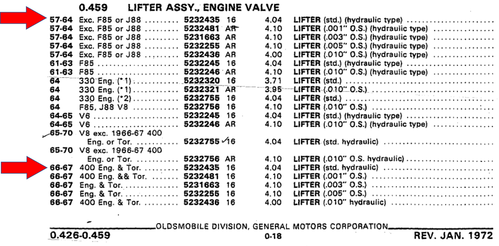

Need help to confirm what lifters I have.
A box that everything was in was labeled .941 lifters, but from what I'm reading should be .921?
The sealed power federal mogul part number references early 400 lifters, but GM part numbers pre 64 then skip to 66-67 400.
​​​​​​I see many threads about poorly made lifters.
I'm asking the group if both kinds are actually .921 lifters for early 400 and if either of them are good quality.
Thanks

The parts book shows the same 0.921" lifters for the first-gen 371/394 motors and the 66-67 motors. The Sealed Power lifters are their replacement for the OEM parts, so should be equivalent. I would not hesitate to use Sealed Power parts.

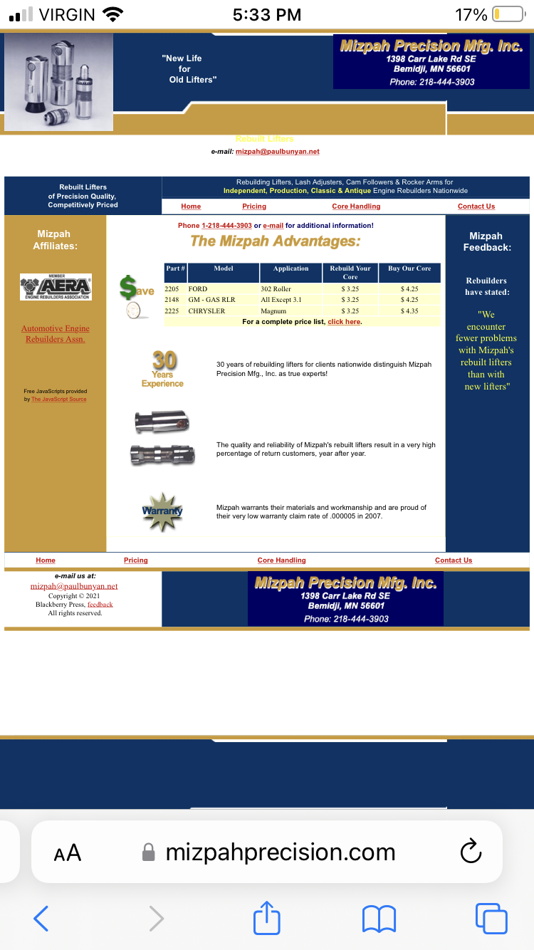

The factory original ones can be refaced. Send the bodies to Mizpah, they’ll do the correct crown
Put the original guts back in to the original bodies…good to go

If you send 16 complete lifers to them it’s expensive..they have to strip each one down , mark each internal piece to each body
its time consuming
they did have a quick turnaround.
i sent an original new body and told them to make the crown the same. I do polish them myself after and bake on a moly coat for extra insurance

the GM 5232435 lifters are.921” uesd in early Oldsmobile 400 engines, some Toronado 425, 1957-1964 371 & 394. They are original equipment.
