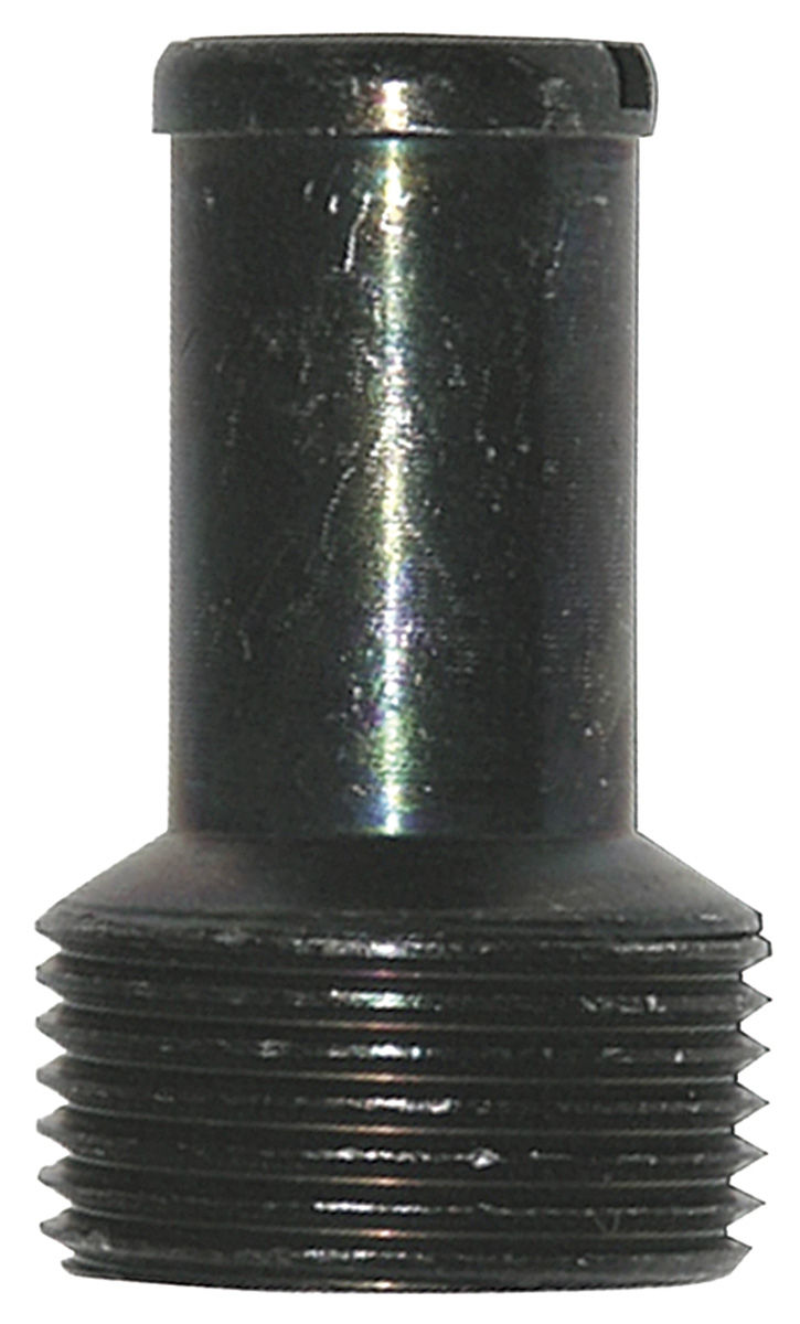

Heater hose nipple in the intake
Looks like a giant screwdriver might drive it [in, when not rusted]...
Anyone know where to find a tool for these?
What said tool is called?
I have always used the vice grips method after placing a dill bit inside to prevent collapse method. apply heat. and/or break the corner of the 2-bbl intake off.
Here is a left hand thead example [durr...]

Old Aug 3, 2014 | 04:44 AM
m371961's Avatar
Joined: Mar 2012
Posts: 2,163
From: Sistersville, WV
You may be able to use this. Drag link socket.
Old Aug 3, 2014 | 04:46 AM
m371961's Avatar
Joined: Mar 2012
Posts: 2,163
Sorry, post didn't seem to work. Worked ok in preview. Drag link socket, various sizes are out there.
Old Aug 3, 2014 | 09:22 AM
Posts: 50,770
I actually own a drag link socket, as it is needed to replace the idler arm on my 62. Great idea. I suspect that adding a tight-fitting tube over the socket and nipple will probably prevent "camming out" and save your knuckles.
Old Aug 4, 2014 | 04:01 PM
BlackGold's Avatar
Joined: Feb 2010
Posts: 1,587
From: West Michigan
Whenever I need a really broad "screwdriver" I grab a putty knife or scraper. If the nipple is rusted in place, I don't know if it'll give you enough leverage, but it's worth a try. Otherwise, how about a 6" piece of bar stock that's the right size to fit the slot? That would give you leverage.
Old Aug 10, 2014 | 02:42 PM
Octania's Avatar
Posts: 7,286
Thanks guys
I *never* would have guessed that "drag link SOCKET" is the term for that tool, since a "socket" by definition has a cavity and not a protrusion.
I have seen those and never knew what they were for. There are dozens available on feepay. I ended up using the giant screwdriver / prybar and since I was installing new parts into clean threads, with sealer, it went smoothly.
I gotta get me one of them screwdriver "sockets" I guess.

Originally Posted by oldolds88
one side of it does have a cavity, for the ratchet.
Well so does an extension, and a Hex Drive bit, and a #2 Phillips driver bit. But we don't call those "sockets" as far as I know. Since every tool that fits a ratchet has a square cavity or "socket" to accept that drive tool, we generally differentiate among such tools by describing the other end of the device.

I have 3 or 4 in different sizes I picked up through the years. Some cars and a lot of trucks used a drag link that attached to a ball on the pitman arm. The drag link had a threaded cap that held in a spring and two socket like pieces that locked on the ball.
I would put tape on the sides of the bit to make it fit tight in the slot and tap it in with a hammer.
Aha, so it's a "(drag link socket) tool" and not a "drag link (socket [tool])"
That explains the perceived glaring discrepancy in naming conventions.
I expect to grind or fit a tube to the OD of one of these tools to keep it centered on the nipple, and we'll see if an impact removes a rusty nipple or destroys it. Someday.

m371961's Avatar
Joined: Mar 2012
Posts: 2,163
I don't know about the impact. I make it fit tight in the nipple slot, use a breaker bar and heat the manifold around the threads.
