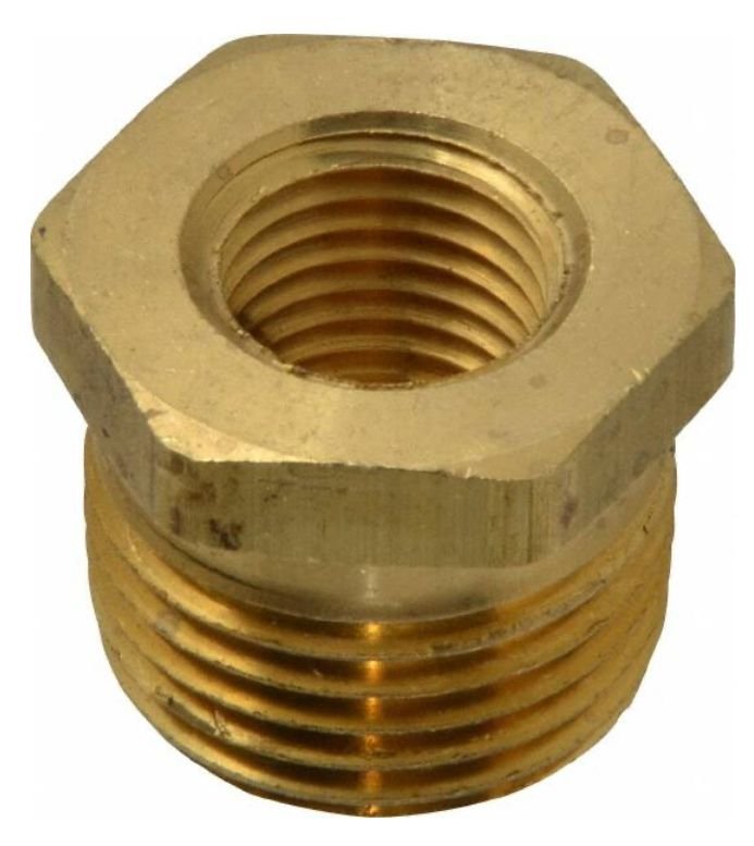

So i would need a pipe thread reducer to make that work Correct?
Old Dec 17, 2023 | 02:06 PM
Posts: 15,394
I used one of these.

does any one know the size of reducer i need to put the 1970 valve in the 1974 intake?
Old Dec 20, 2023 | 11:28 AM
Posts: 15,394
3/4” outside diameter
1/2” inside diameter

Remember these are pipe thread sizes. Probably would be 1/2 inch pipe and 3/8 pipe thread, or 3/8 and 1/4 pipe.
