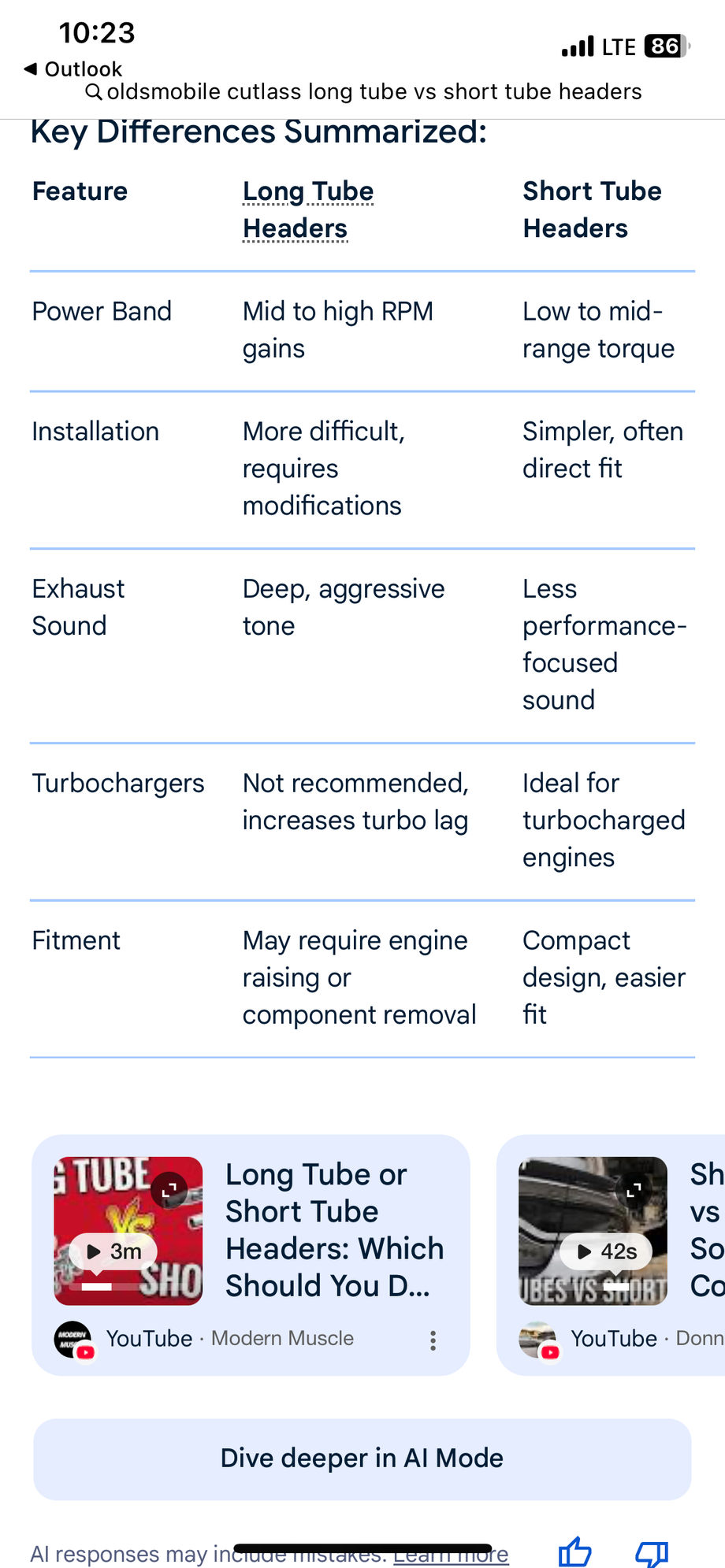

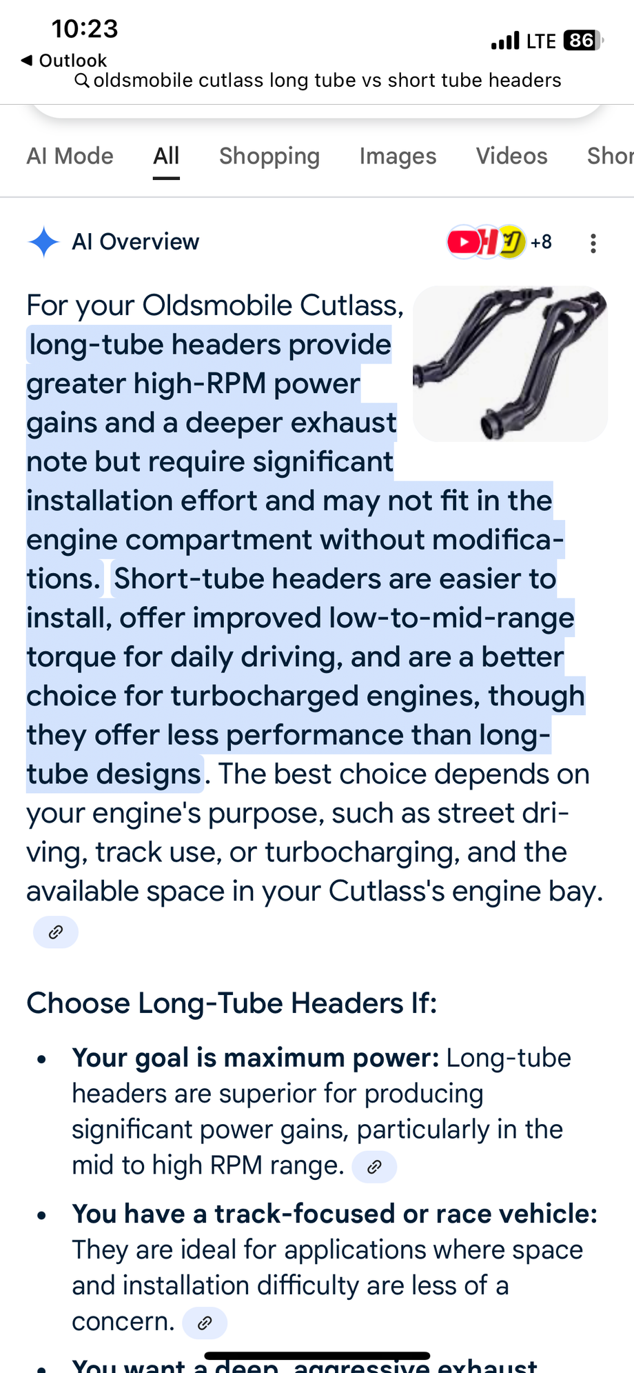

Where did you learn this ?
research

Either your research or your assumption was flawed, or both.
Shorties add very little if anythng over stack cast iron exhaust manifolds. The "Long tube headers" give a boost in al ranges compared to "stock". "Shorties" and long tube headers have been compared on a dyno before. Cutlassefi is one who has done the comparison and I believe posted results on here. .

If you believe internet for "research", why ask the question here ? Just go for it.

There should be examples in previous questions. I have used Hooker, JR Headers, and I have a set of "off brand" headers that work well.
On this site, we all try to make sure correct information is available. Its quite common for people to post BS and claim they found it by "research". Some people also claim "people they know" told them. Trust me, I have been corrected by JoeP and some others.
My post about Shortie and long tube headers comes from reliable sources that have posted results. Sorry if I ruffled your feathers, but facts and truth are important.
