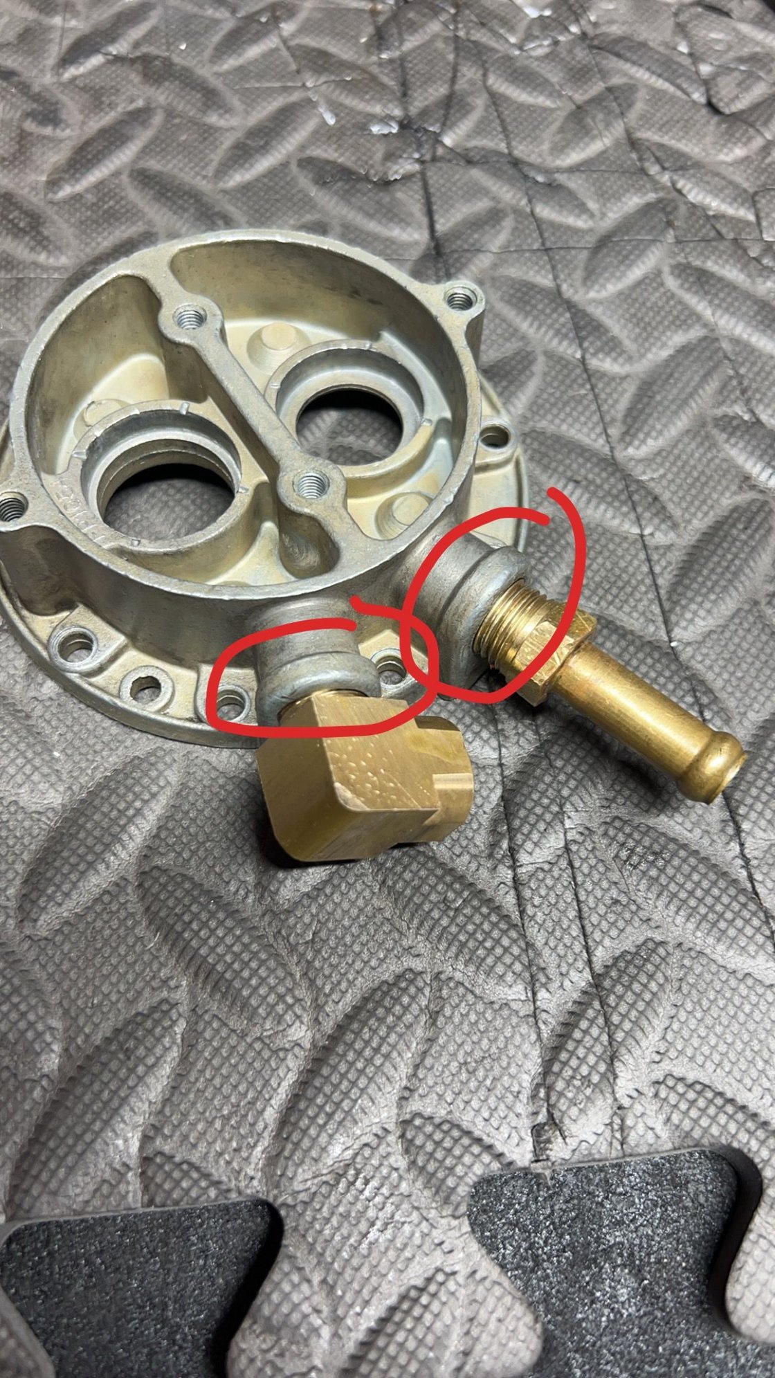

Getting input on whether to use or not use pipe tape, goop, or nothing on these brass fittings to inlet and outlet of the fuel pump for my 61 Olds 98. Don’t want any leaks after the fact.

I use Teflon tape on that type of fitting.

The threads aren't the sealing points on these fittings, the flared seat is the seal area. I'd slide the nut back a little, put never seize on the tubing and then use teflon tape on the threads as a lubricant.
Look again. There are two brass fittings that screw into the pump body. I suspect the threads are tapered pipe but not 100% sure on that.
I think you might be correct, thanks Fun71. To the OP if they aren't flared seats I would use teflon tape.
Correct they are NOT flared. I will go ahead with the teflon tape, avoiding the first few threads.
