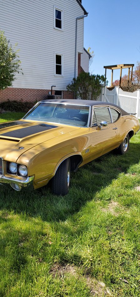

It is a 1972 olds 442 455 4 brl. Auto trans stock engine

It is not a u code it is a w29 option I am told it is a 455 out of a 73 442 and yes has points
