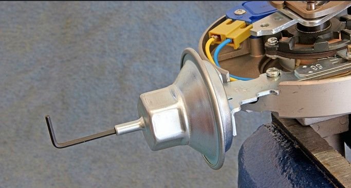

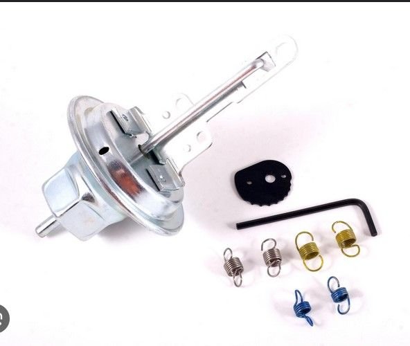

I continue to marvel at some of the answers on questions like this. I’ve built dozens and dozens of aluminum and iron headed 10:1 big blocks that run on 91 octane all day long, no problem. That’s because they were tuned right and I don’t do stupid **** with timing.
Next, no one has mentioned cooling system or air/fuel ratio.
Op- what is “operating temp” on this? Do you know that you have good air and water flow thru the cooling system? Verify that first.
Today’s fuels aren’t blended the same as they were yesteryear, whether they have added ethanol or not. Hence you could have a lean condition somewhere in the operating range.
Lastly, throw away the “all in by 3000” notion. That’s not optimum in every application. Get a timing light, see what your total advance rpm is, and how much with the vacuum canister disconnected. Then go from there.
And adjusting the canister limits the total, that’s what you want. Most have too much in them to begin with.

Once you think you have the timing where you think it should be, and it still pings, consider fuel system heat soak. The line and the carb.
The exhaust gas crossover in the intake & heads can be blocked off to significantly reduce the carbs heat soak. This crap gas today boils off more readily than it did in 1966.
If the centrifugal weight springs are too light, the full advance event could be "coming in" too early, causing preignition.
Look at the springs in the old points distributor. If they are heavier, which I suspect, if they are OEM, install them in the HEI and see what that does.

Thats what Im thinking but didnt have this issue last year. How do I limit it? Im still debating unhooking and tuning without it to see.
Old Jul 23, 2025 | 07:19 AM
  #31
BlackBetty425's Avatar
Joined: Nov 2023
Posts: 24
My cannister is adjustable but Ive never done that before. I could put my vac gauge on it and see how much vacuum it takes to affect the timing and go from there?
Old Jul 23, 2025 | 07:32 AM
  #32
droldsmorland's Avatar
CH3NO2 LEARN IT BURN IT
Posts: 5,628
From: Land of Taxes
Use the vacuum gauge to tune. I use it to achieve the highest vacuum reading at idle by adjusting both the A/F and timing. Then, limit the vacuum canister to 8-10°. Get a setback timing light.
Generally, the "adjustable" canisters only adjust the rate at which it moves and don't limit the total travel. Install a limiter. You can make one or buy one. See below.
Old Jul 23, 2025 | 01:50 PM
  #33
Posts: 6,095
Give the engine what it wants, not what you think it needs.

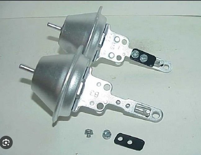

For now, disconnect and plug the vaccum advance. Concentrate on getting the initial and centrifugal advance sorted out.
Start by either marking the balancer as described, using a disk back timing light, or a timing tape. Set the TOTAL advance to around 32-34 degrees. See how it runs, if it runs well and no pinging, add a couple degrees and see what happens. When it starts to rattle, back off a couple degrees from the previous no pinging setting. In other words, if it pings at 36, but not 34, set it at 32 to maintain a safety margin. Drive it like that for a couple days and see how it runs. If all is good, leave the initial/centrifugal advance along, do not move the distributor from that point!! Now you can
play around with the vacuum advance.
There is nothing wrong with running 40-45 degrees of total timing, as long as the engine doesn’t rattle. SLIGHT pinging under mild acceleration is acceptable, but it needs to stop if you crowd the throttle more.
Get an adjustable vaccum advance and a limiter, or fabricate your own. It’s not hard, just time consuming.
