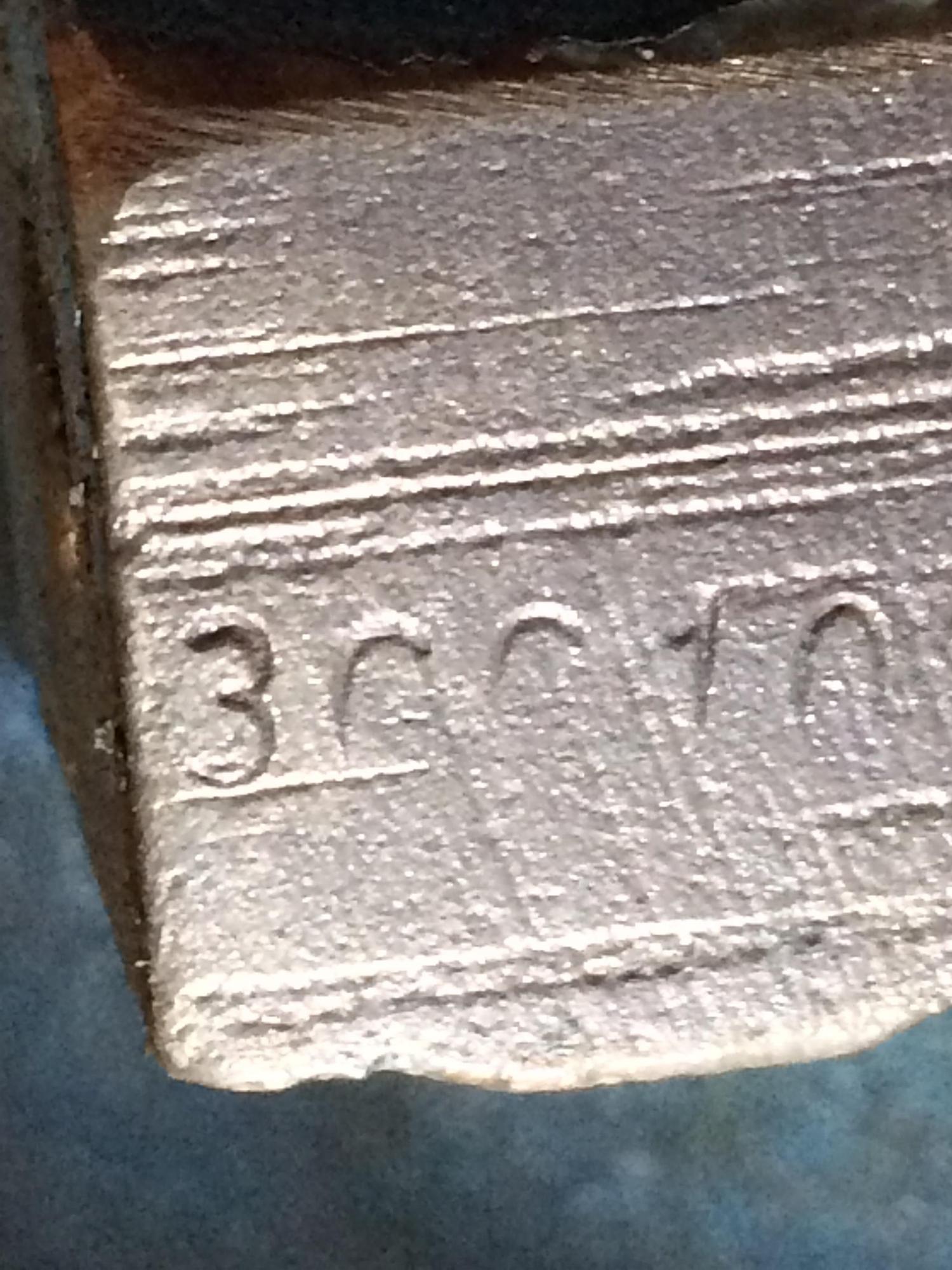

https://i.imgur.com/4P2MIjW.jpg
Hi all.
I am trying to decode an engine casting.
F block E heads. 396021
The stamping is on drivers side
Of the block at the front
It is really hard to read but looks like 30_10_4_1
The first number looks like a zero and the last two like 8s
Which would give us 300108481
But I don't think that can be correct. The last six are the last six from the bin right? They don't match my car which is fine it wasn't sold to me as
Matching. Isn't the third spot the assembly plant?
The car is a 70 442 made in Fremont ca but then at some point went to Canada

The third character of the VIN derivative is the assembly plant. In the 1970 model year, that could be either a "C" for Southgate, CA, or a "G" for Framingham, MA. Southgate built full size cars (Olds D88 and Ninety Eight) in 1970. Framingham built A-body cars. The VIN derivative on your block is either 30C108481 or 30G108481.

I think it's a 109481 as the size of the circle is larger in what I think is a 9 than the 8 is.
Good eye. I think you are correct.

I agree, 109481. But Joe, blow up that second character and it sure looks like a "G". And the tops of both the second and third characters look different than the 0, 9, and 8 later in the sequence. Comments?
What bothers me is that the second character LOOKS like it wants to be a "C" or "G", but we know it must be a digit, so the only possible digits are "0","3", "6", "8", or "9". It clearly looks nothing like the "3" in the first position. I discounted "8" or "9" because there is no evidence of red paint under the blue, but I am reconsidering that possibility. It's an "F" block, not an "FA", so it isn't a "6". That pretty much leaves a 1970 block.
EDIT: I don't think it's a "2", but I could be wrong.
The third character must be a letter, and the only possible letters that fit are "C" or "G". Could be either - I'm not hard over on which it is.
I agree with you that appears to be a 9. A ten power magnifier might tell the story. Maybe the op can get one and let us know.
I agree, it helps. Here's a pic of a real nasty one.
Imop, the op's #'s look to be 3G9109481 in my eye.
Looking back at my pic, looks like I should have been closer
to magnifier with my camera maybe. Hope this helps.
The more i look at it i think you hit the nail on the head.Maybe the op can get a ten power and post back.

Hey, guys, I know that the second character is supposed to be a number, as stated, but, man, it sure doesn't look like one. That cutoff is way too distinct:

I am sure that is a G

So, Is the consensus 3G9109481?
If so, what does it mean? Was it mis-stamped?
From what I've read here
3 is OLDS , next number should be year, third place should be plant, right?
I went and looked again, on the back of the block is says
68
F4
This is behind where the flywheel would be.
Old Oct 16, 2015 | 02:13 PM
wr1970's Avatar
Joined: Sep 2013
Posts: 3,645
68
F4
If you look close there is the slash for the g and faint imprint of lower part of the G is kinda hidden because of a scratch! I am in agreement 3G9109481. As for 68 F4 some think that those blocks are higher in nickel! I really am not buying into that speculation no proof i have ever read supporting!JMO
