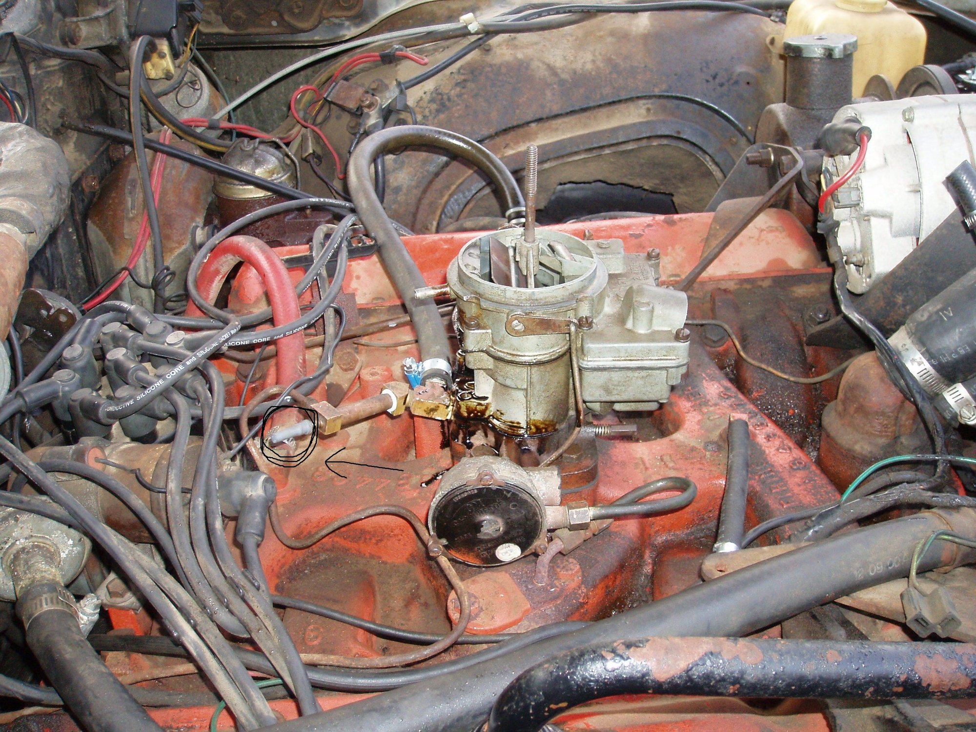

Hi just wonder where the vaccum line to the distributor should be connected
on the engine.On my car the vaccum hose is connected at the arrow on the picture(where the gray rubber hat sits)
The car have ac system.Would also be great if anbody knows how to connect
the vacuum hoses to the heater system.

the circled gray hat area there appears to be manifold vacuum which I believe is correct for the '65 2-bbl application seen.
It will provide good performance and economy, when the timing is correctly set and the proper octane fuel is used. Easy starting too.
