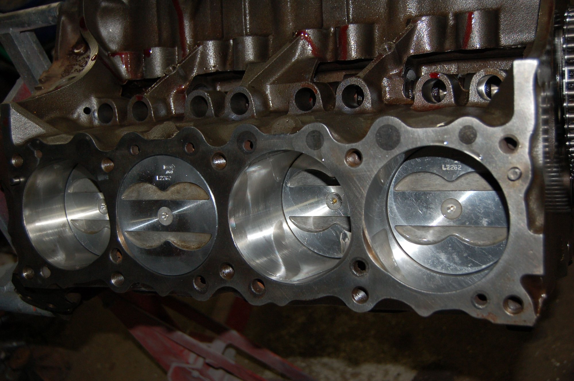

This is a Pontiac 400 that was sitting in my unheated garage in PA for the last 6 years or so. It belongs to a 67 HO 4-speed GTO. It came with the car when I bought it as a freshly assembled short block. I sprayed it down with WD-40 and and wrapped it back up in the plastic bag it arrived in from the machine shop. This is what it looked like when I pulled it out of the bag after sitting in the corner for 6 years.
