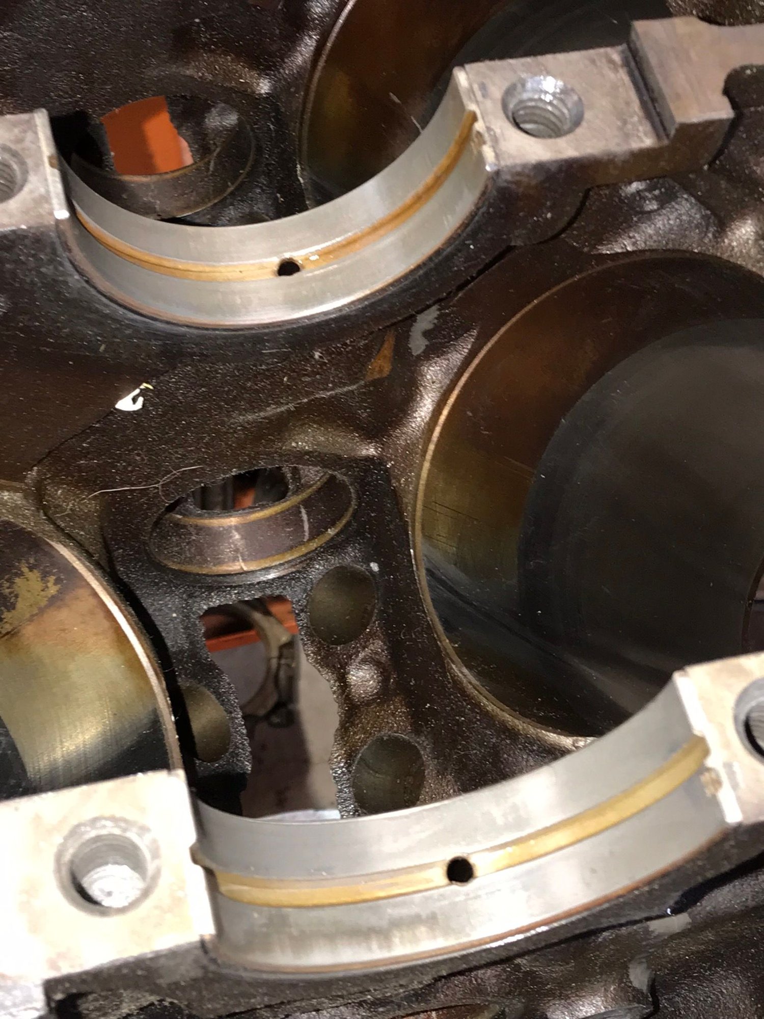

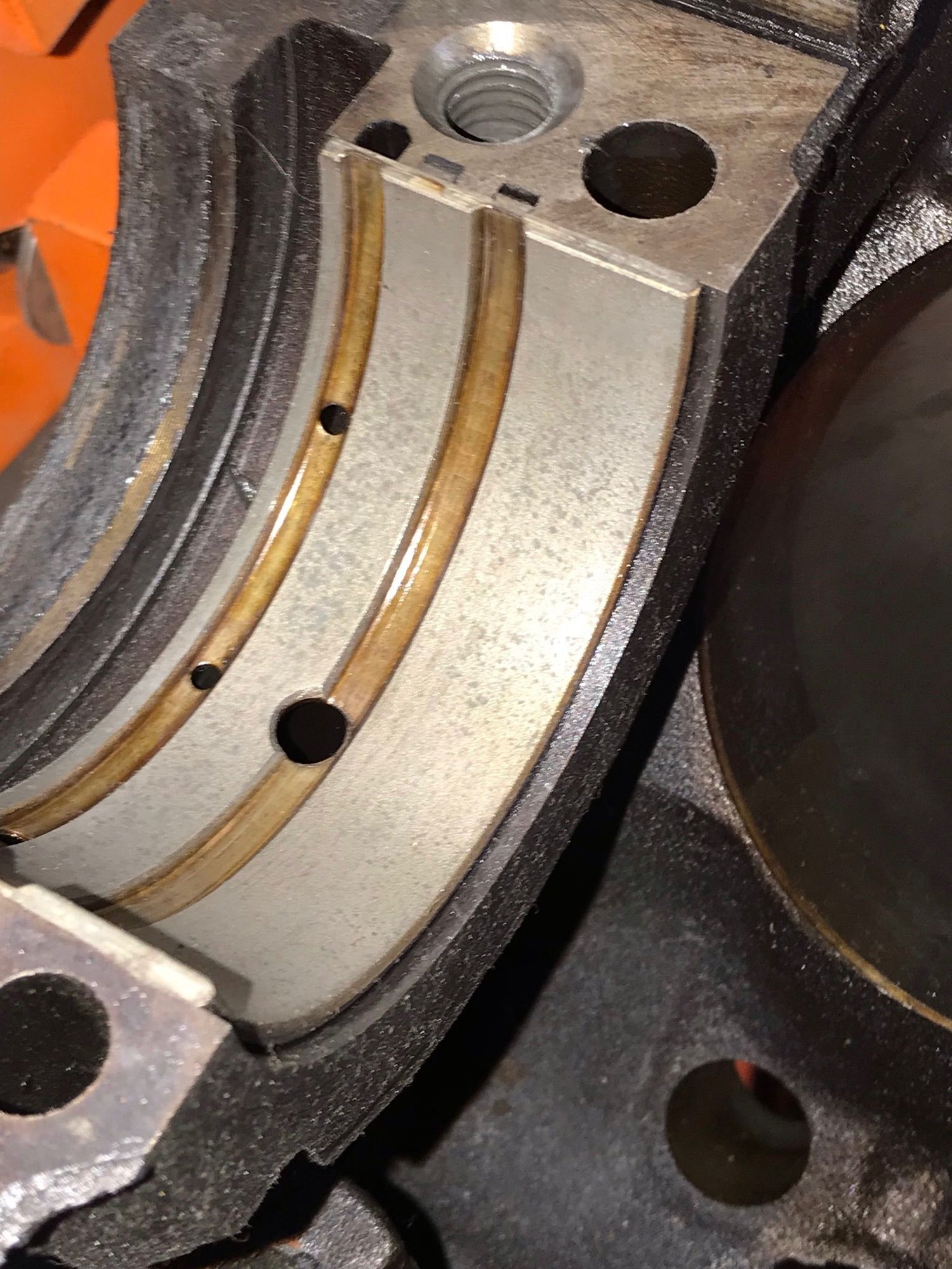

I am taking a core 68 455 to the machine shop tomorrow. Hot tanked, magnafluxed and bores measured. Mileage of this motor is unknown, I attempted to measure the cylinders with a dial bore gauge (thanks utube). From what I can tell 1.5-2 thousandths on them with barely a ridge at the top. But the shop will verify.
Here are a couple pics of the mains, do they look normal or “Abby” normal?

They look very good. What will the motor be used in?

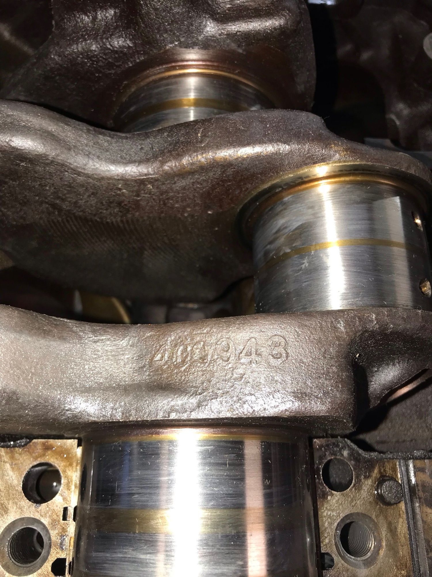

You did ok there. That looks to be a forged 455 crank. You can get decent money for those if desired. Good luck in your build. Let me know if I can be of help.

Bearing look nice, maybe you will get away with a relatively cheap rebuild.
Hey Mark, just the guy I was hoping to chime in. A couple of questions, I know you aren't a fan of the Speed Pro Forged pistons, but I have a set of Standard L2323F's I was hoping to use these. Of course will have to wait for word from the machine shop on the bores. I was looking through this thread about PTW clearance. https://classicoldsmobile.com/forums...arance-132623/ Good info there. I also have a new cam (OE #406768 1970 442MT) I'm wondering if I'd be better served with a modern profile? just looking for a good strong street motor. That is a forged crank, I have a N crank I could use if someone needs that forged one!

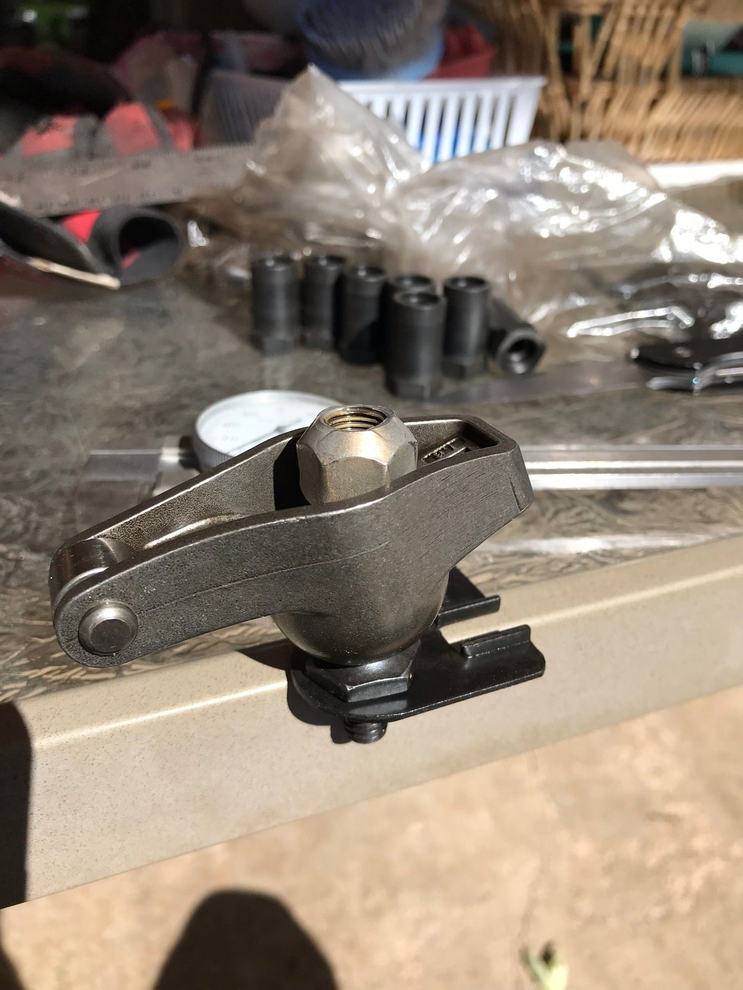

Poly locks? What’s a good one to use on these Comp Cams rockers? The lock nuts are used and I’d rather upgrade to short ones but still want stock valve covers.
Is .080 off the pads for comp cams guide plates? or just the thickness of the plates(.063)?

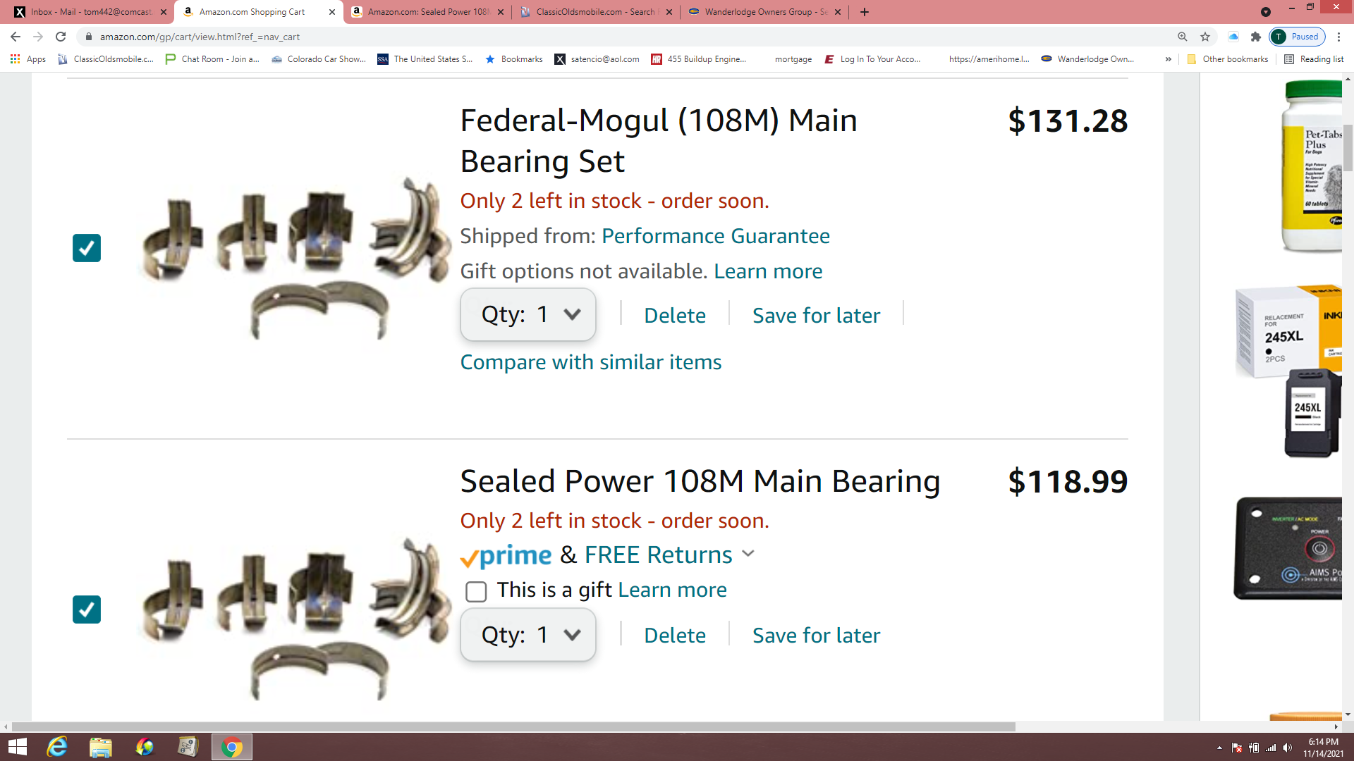

Are these the same manufacturer?
I am wanting to source new main bearings and found these... looks to be the same photo. Federal-Mogul and Sealed Power the same outfit??

Yes.

Same bearings here also.
Main Bearing Set 108M: Advance Auto Parts

The bearing pics are all the upper halves, that can’t tell you very much. The lower halves , especially #4 is what you need to look at.
you don’t need to cut the rocker pad surface to use those guide plates
