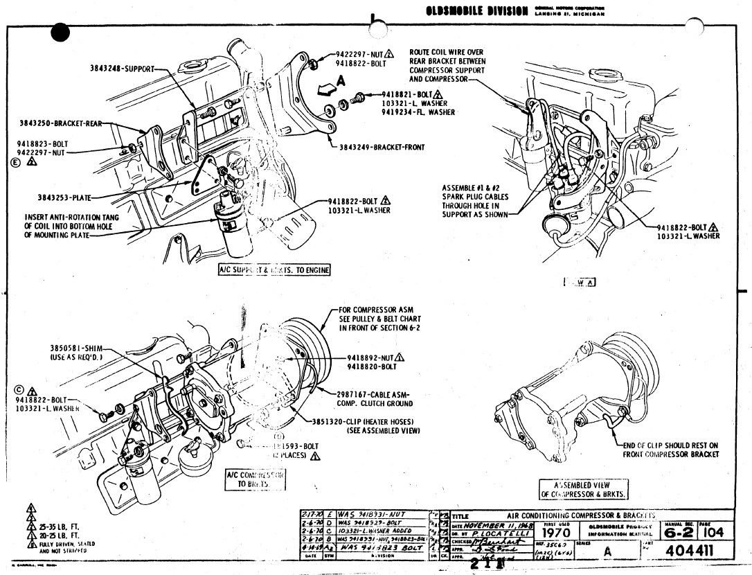

Does anyone have a picture of how the coil bracket ggoes on a 455? I have mine off and can not seem to get the correct orientation. Thanks guys

I might be able to find an image, but location may vary among model years? At any rate, it's always best to state the year & model when asking.

This help?

Only if he has the Chevy inline six.
Here's the coil mounting for the 455. Note that View A is for Toronado only. The figure below that is for the RWD cars.

Joe, THANK YOU !!!! This is exactly what I needed. Much Appreciated
