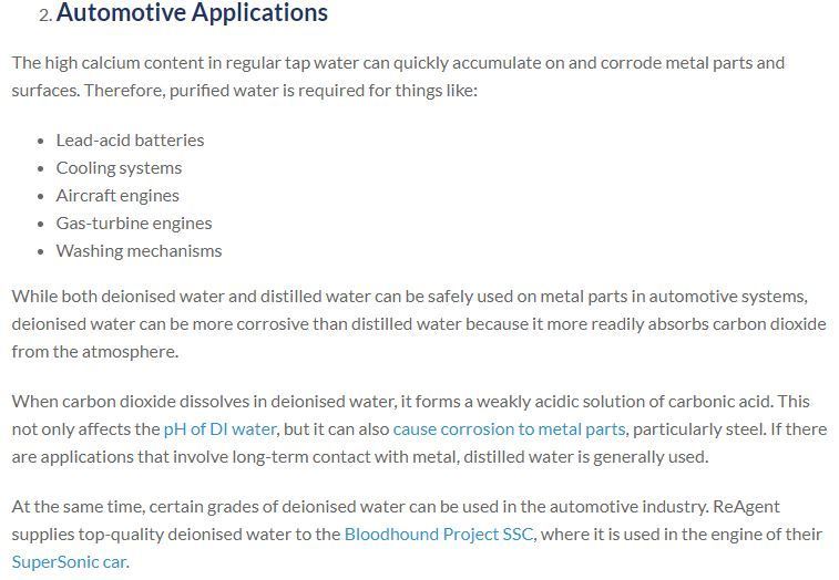

Originally Posted by gs72
Read this regarding distilled water in cooling systems.
https://rislone.com/blog/cooling/why...ooling-system/
This site actually says distilled water is preferred for automotive applications. I have used DI water from work and never had any issues in my vehicle's cooling system.
https://www.chemicals.co.uk/blog/dei...istilled-water

Engr
Kenneth, that's the case when you use coolant (anti-freeze) with the DI water.
Those two articles had mostly good information, but some doesn't apply to our cars unless we are using 100% water.
With a coolant/water mix, there is no difference in corrosiveness or deposits whether you use distilled, DI, or softened water.
This is from accumulated wisdom, both from educational and industrial experience. I'm a Registered Professional Engineer with a degree in Chemical Engineering and I've designed many cooling systems in the last 50 years.
Gary
Old Feb 3, 2022 | 08:54 PM
Posts: 15,395
Thanks for the feedback. I had surmised that the antifreeze/coolant had the additives needed to protect the system. Also figured that I had nothing to lose if the DI water leached the calcium deposits out from the years of using hard tap water. 😀
