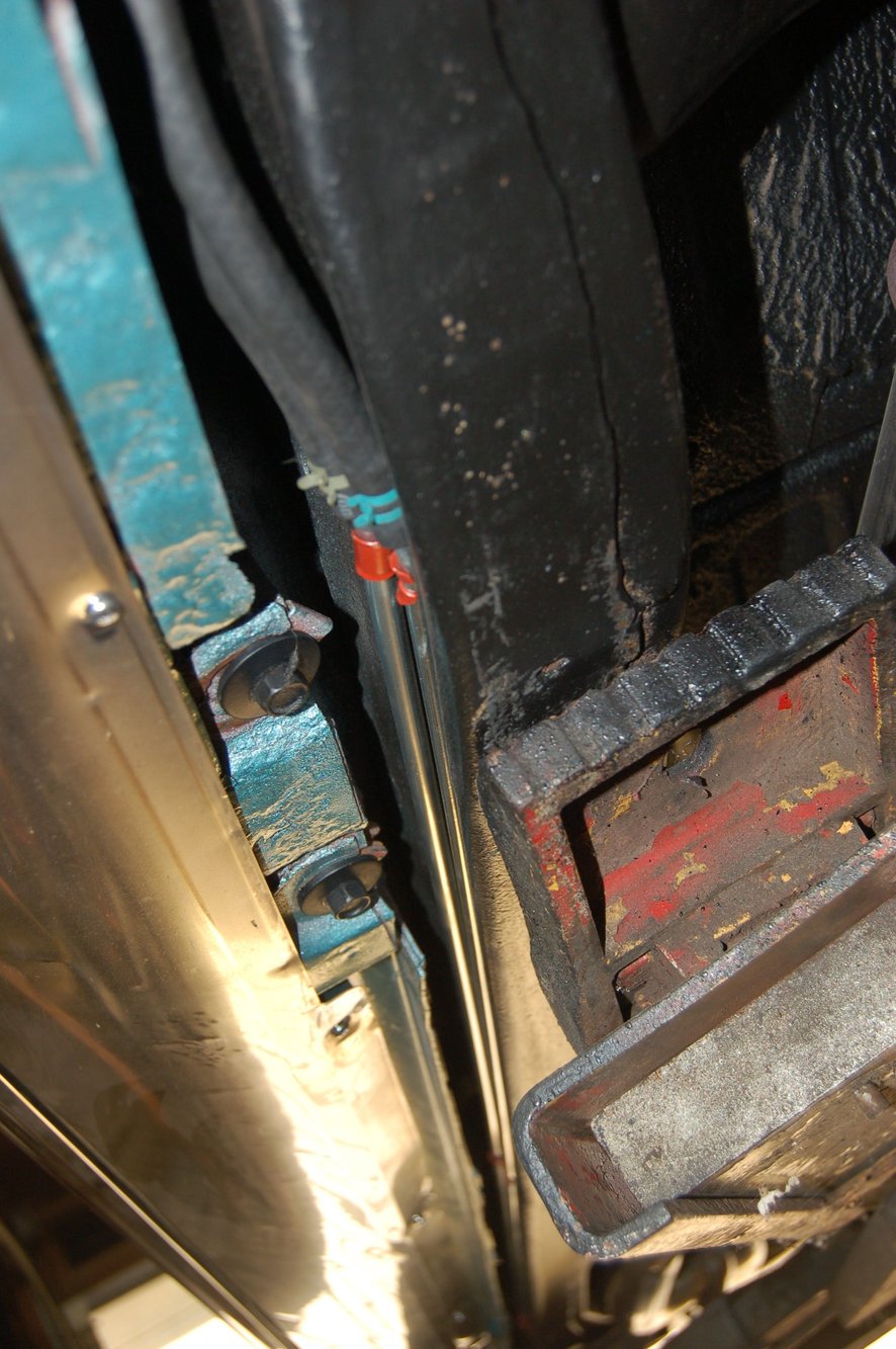

FYI, Toronados have more rubber fuel line from the factory than just about any other car you will find. Roughly 10 feet of 3/8" supply fuel line (5 feet in front and 5 feet in back), and roughly 10 feet of 1/4" return fuel line (5 feet in front and 5 feet in back), It is possible that only A/C cars got the return line, so yours may only have the single supply line if it is not an A/C car. If you look under the passenger side of the car you will see the metal fuel line(s) running along the outside frame rail. That is the only steel portion from the tank to the pump. You will see where the rubber hose that runs from the tank to that line connects in front of the rear tire (rubber line runs through the frame from the steel line the whole way back to the tank). You will also see where the rubber hose that runs from the pump to that line connects behind the front tire (rubber line runs through the frame from the steel line the whole way to the pump on the motor).
These are the steel lines on the outside passenger frame rail.
