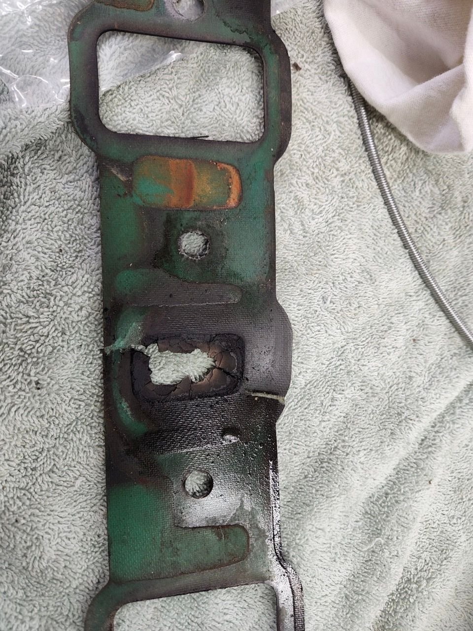

Here is the Offy that I removed after 5k miles. It had smaller heat ports and heads were not blocked off. Gaskets we’re starting to burn up at crossover. So either block off heads or open up the gasket for the cross over if you don’t use the turkey tray. Only 5k but no oil issues on bottom of intake.

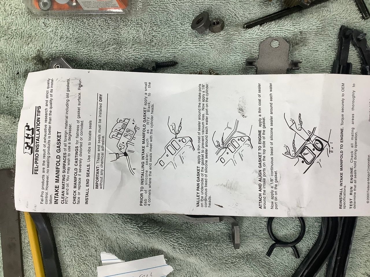

Here are the gasket instructions. Just a thin coat around the ports and a bead around the water jackets

The recommended way to use the turkey tray is to leave the intake ports dry and just use RTV around the water ports. As for the end pieces, just put a dab of RTV at the very ends (wedge shape ends of each end piece). Leave the rest dry as the rubber will seal tightly without any sealant. If you put sealant on the rest of the end pieces the sealant will act as a lubricant and the seals will work their way out of the gap and cause a leak.

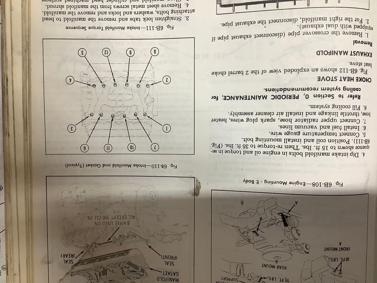

Here is the torque sequence, 15 then 35 ft lbs. fuel pro rec a thin coat around the ports to help prevent vacuum leak..I just spread on a thin layer with my finger..no bead.
