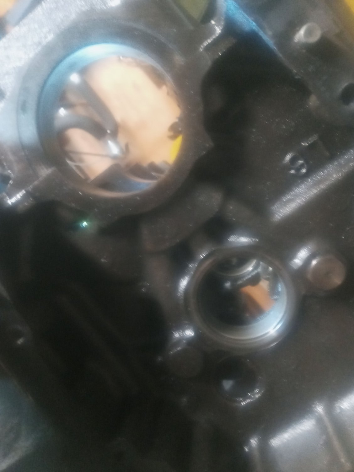

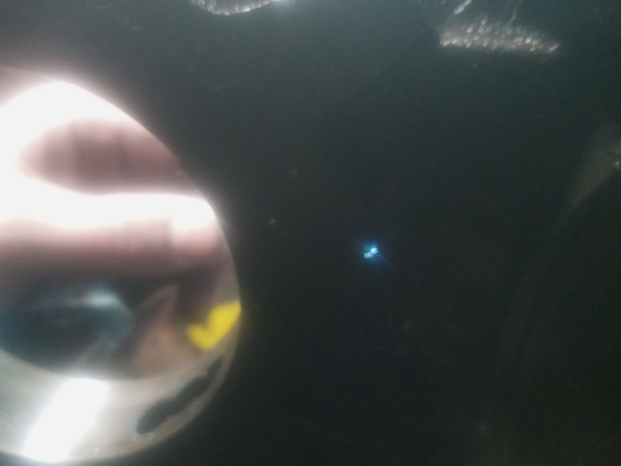

Hi all, I'm currently in the process of rebuilding a 455 for my 71 Delta and I noticed the small pin holes shown here near the bulge for one of the front main bolts. I'm pretty sure these holes are due to a piece of metal from the bearings that spun. Not sure how to go about this repair if it is even possible. My main concerns are how thin the metal is at those spots and the fact that repair has to hold oil pressure. Any advice would be greatly appreciated.
Outside hole
Light shining through can be seen on left side near the main
Inside hole

If it were me, it's time for a new block. If the metal is thin there it's also thin in other spots. If it's not and you want to chance it, then have someone weld the holes.

Looks like the bolt holes were drilled into the main web before they were tapped during factory machining. Or something in the hole the last time the mains were torqued.

I have seen those holes in other blocks. It appears to me the drill for the main cap bolts just barely broke thru the casting. Maybe the machine at the factory was set to drill just a little too deep, maybe the casting was a little thin there. Remember, these blocks were cast and machined long before all the fancy equipment today.
Unless someone more knowledgeable than me suggest otherwise, I would think it’s ok.

I missed the pic of the light shining thru the main web casting. Definitely thin casting!! But not nearly as thin as the windowed main webs of the 403.
Is this a later model block? While I don’t buy the theory of different metallurgy for certain blocks, it wouldn’t surprise me if the castings got sloppier the later the production run life. Just a fact of life that as the molds used at the foundry get older, they would need repairs. The repairs might effect casting thickness.

Don’t worry about it, most are like that.
it’s inside the engine and just the bottom of the hole where nothing is going on.
many of the main cap bolt holes in the block are through holes

Clean it up and put some JB Weld in it and put the engine back together.

Take a look down the other main cap threaded holes in the block..tell me if you see through the bottom?

That simply is not a problem. Probably 75% of Chevy blocks are like that. The drill just went too far or the casting was a little off at that point. It actually makes it easier to clean the bolt threads out. Stop worrying about it and keep going. Think about it . . . its been that way for almost 50 years and hasn't caused a problem yet.

That is nothing to be concerned with, most OE Olds blocks will have that, and if they don't........ that area will be paper thin. It will not cause any problems at all to use that block "as is"

Think about it. There is no oil pressure in the crankcase, just oil splashing around. There is no oil pressure under the cap bolts. So it's a hole internally between the crankcase and the inside of the main bolt threads. So your main bolt threads will be oiled. Why is that a problem? I agree with the others, do nothing. Just finish the build and enjoy it.
