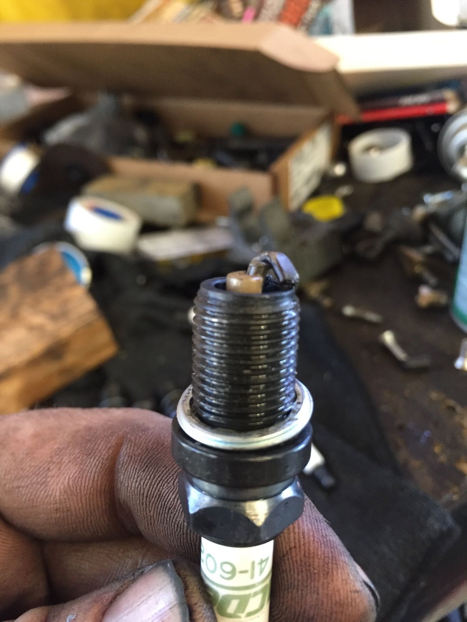

Okay the issue has been found! I broke a rod the piston hit the sparkplug and bent the tip. So I think instead of rebuilding this 455 I will get another one. This will be the 3rd engine for this car. Thanks all for the responses.

Old Aug 25, 2016 | 05:44 AM
Wildweed's Avatar
Joined: Jun 2016
Posts: 14
Originally Posted by m371961
Pics, I want pics
Sparkplug when i get the heads off i will post more.
Waiting for the tow truck

Old Aug 25, 2016 | 04:10 PM
RetroRanger's Avatar
72 Olds CS
Posts: 6,657
is that the right plug? The common ac 45s are a short reach plug
Old Aug 25, 2016 | 06:13 PM
76olds's Avatar
Hookers under Hood
Joined: Nov 2013
Posts: 3,543
From: Ontario, Canada
I was going to say the threads on that plug are really long. But I've never had a 455. Sad to hear about all the issues guys have with 455's. I hope you have much better luck with the next one.

Old Aug 25, 2016 | 07:50 PM
1970-W30's Avatar
Joined: Sep 2012
Posts: 484
From: Gilbert, Arizona
I'm guessing the plugs are deep thread because the engine has aluminum Mondello Racing non stock heads.
I would trust Bernard over Mondello Twister any day.....
Old Aug 25, 2016 | 08:07 PM
cwb442's Avatar
Joined: Oct 2014
Posts: 106
From: Duluth, Mn
That seems like way to much thread. Mine are half that. 9.75.1 comp motor

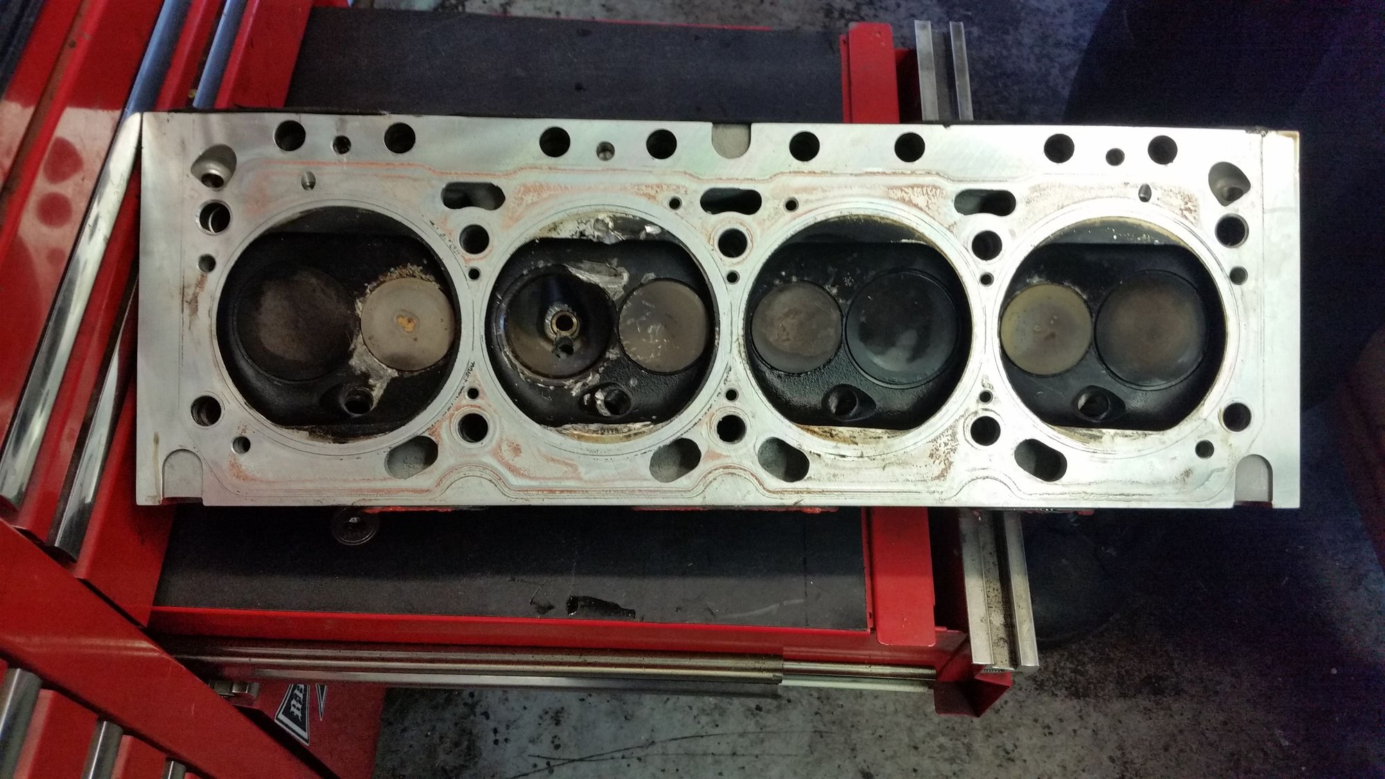

Pics, I want pics
Here are the pics
Old Sep 6, 2016 | 05:45 PM
  #31
72 Olds CS
Posts: 6,657
ouchy...im far from an expert but that does not look good.
sorry for your loss!
Old Sep 6, 2016 | 06:51 PM
  #32
Magna86's Avatar
Joined: Mar 2012
Posts: 1,257
From: Chesapeake, VA
I truly hope they are standing behind their warranty on the parts. They destroyed that engine completely. Never seen a cylinder crack/break like that.
Old Sep 6, 2016 | 07:02 PM
  #33
svnt442's Avatar
Posts: 4,293
From: Palm Bay, FL
Drop valve.....smash bore. Ouchy.
Old Sep 6, 2016 | 07:49 PM
  #34
MDchanic's Avatar
Connoisseur d'Junque
Joined: Sep 2010
Posts: 21,183
From: The Hudson Valley
Wowza.
Tough to rebore that one.
- Eric
Old Sep 6, 2016 | 07:53 PM
  #35
quaddriver's Avatar
4 Barrels of Laughs
Joined: Jun 2016
Posts: 405
From: I moved to pittsburgh so I can be near Primantis
that one is all bad...
Old Sep 6, 2016 | 08:40 PM
  #36
Posts: 12,762
That's pretty catastrophic. What happened to the cylinder to the right of it (the white stuff and the scraped up valve)?
Old Sep 7, 2016 | 08:01 AM
  #37
garage goat 67's Avatar
Joined: Sep 2016
Posts: 4
can that be resleved?
Old Sep 7, 2016 | 10:10 AM
  #38
1970-W30's Avatar
Joined: Sep 2012
Posts: 484
That's way past the point of resleeving...........
Old Sep 7, 2016 | 10:15 PM
  #39
svnt442's Avatar
Posts: 4,293
From: Palm Bay, FL
With the damage to the water jackets...no.
Old Sep 8, 2016 | 05:58 AM
  #40
olds 307 and 403's Avatar
Out of Line, Everytime😉
Posts: 10,082
From: Melville, Saskatchewan
This why guys stay away from Mondello. Their heads are Procomp heads they charge too much money for. Bernard Mondello or Dave Smith in Exner, California would both be much better to deal with and their motors will actually live. Yes, Eric, I too see many more problems with 455's compared to the nearly indestructible Olds 350. Those heavy bottom end parts need proper machining and assembling to last, especially at rpm beyond stock. Mondollars is probably slapping on out of box Procomp heads which should be inspected before installation. It also could be any of their sloppy work in this case that caused this destruction. Sorry to see you having these issues..
