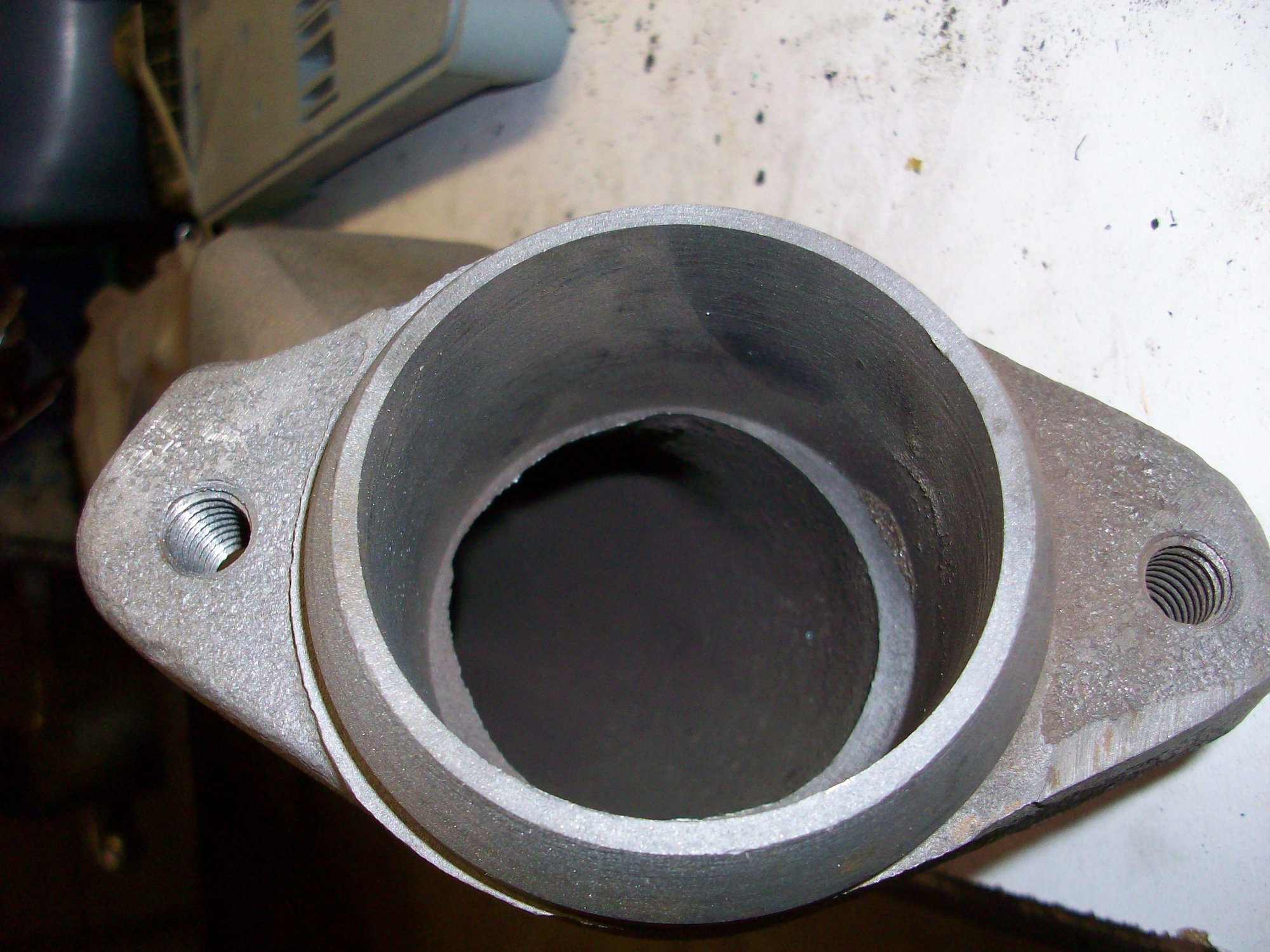

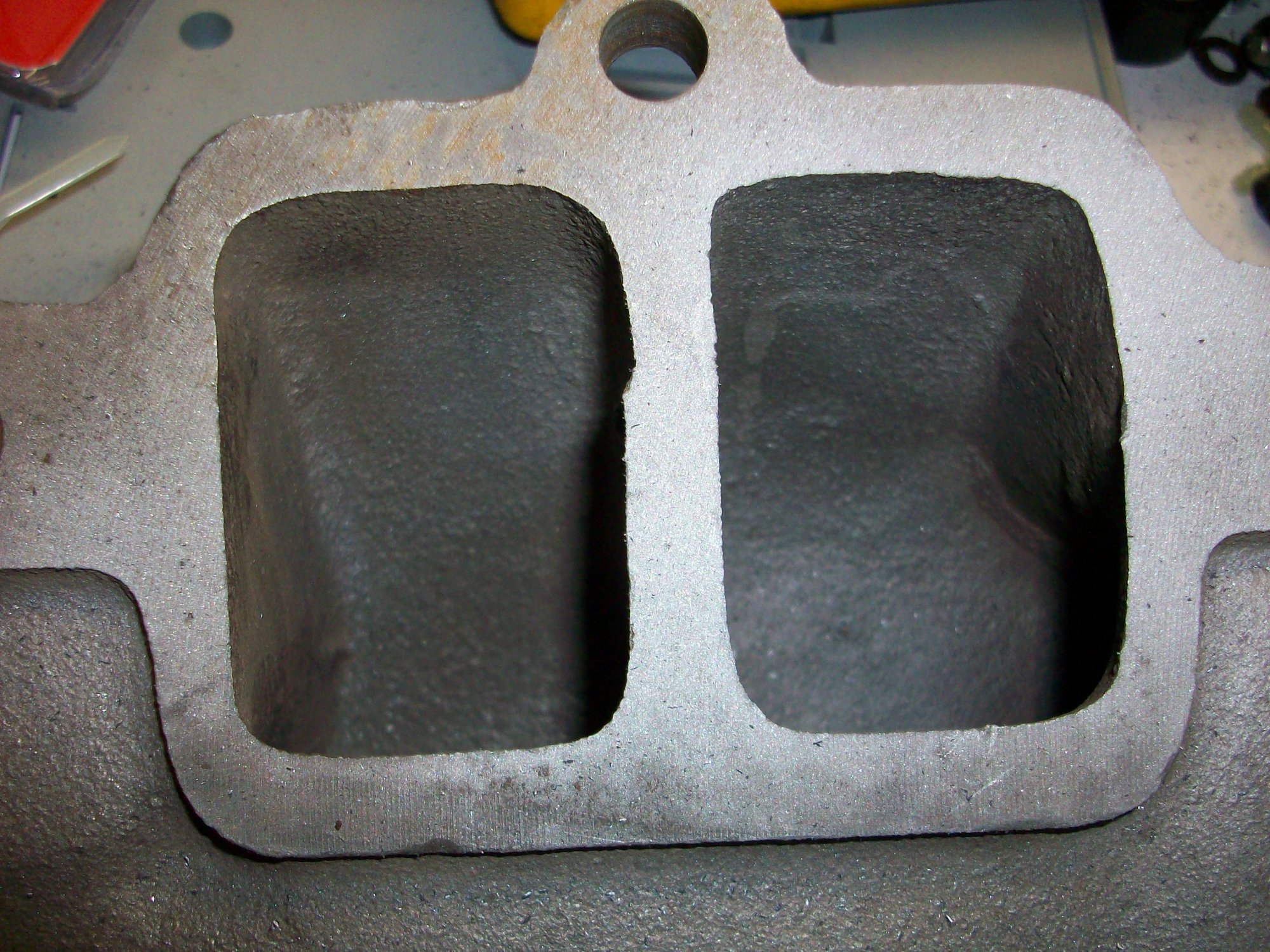

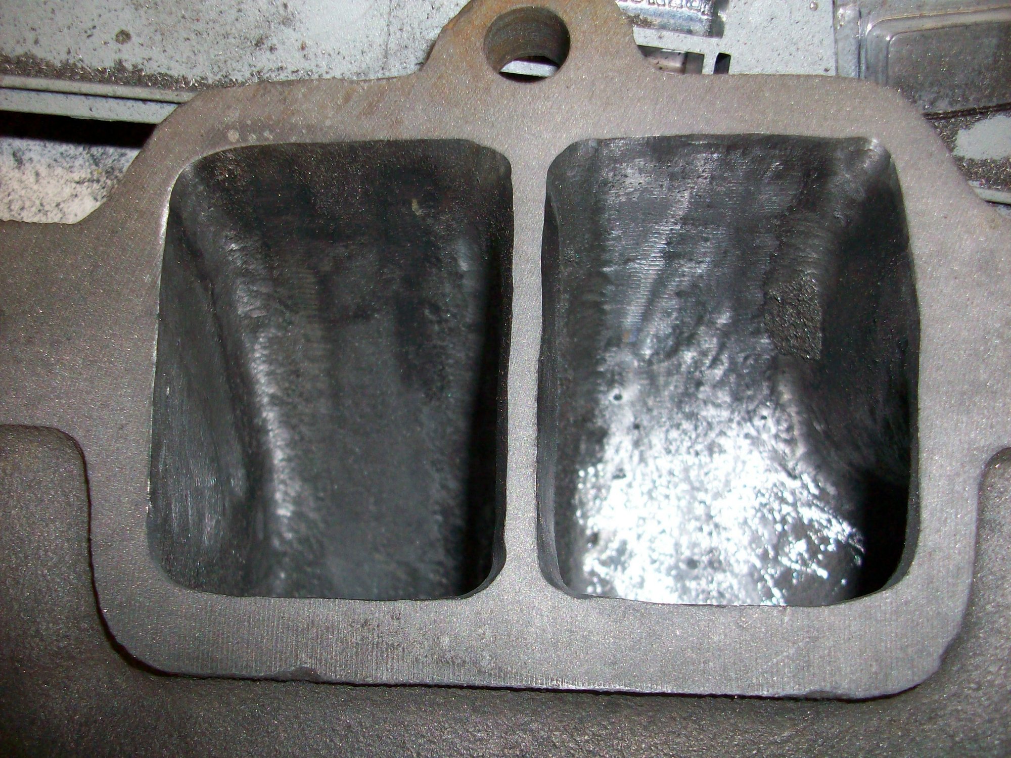

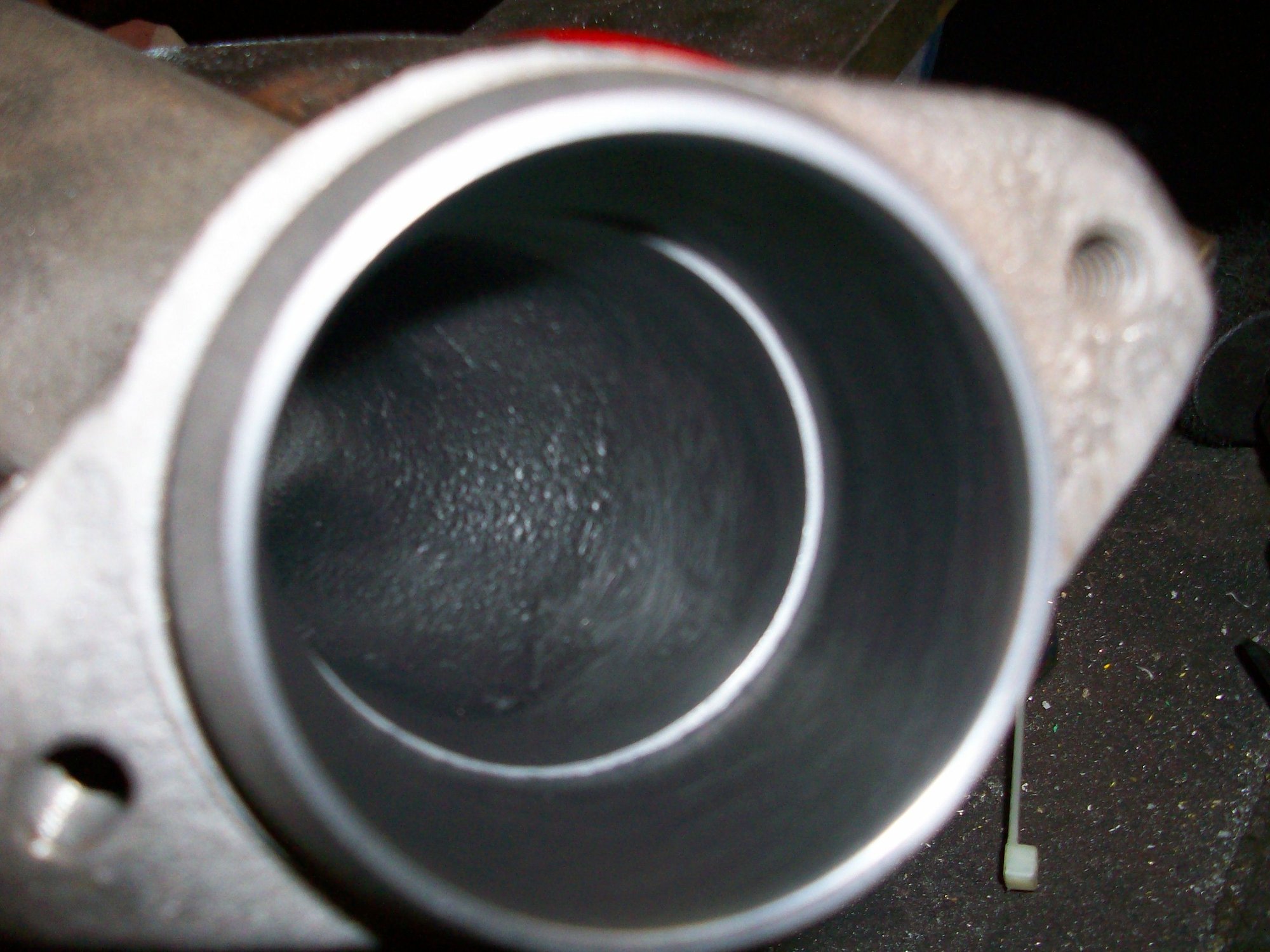

Joe said truth. No headers unless you have custom made. An option for the passenger side manifold is the divided Z available from a few vendors as a repro. The drivers S manifold is horrible, but sure beats the old crossunder single exhaust setup. I carefully used a die grinder to do a little port matching and enlargement of the exit ports on both. I used 2.5 aluminized pipes with electric cutouts along with a way-too-big comp cams ***** thumpr. It sounds absolutely outrageous at 1100 rpm. The passenger side with the divider has more cackle due to the isolation of the exhaust pulses. Drivers side S manifold sounds good, but is simply a log type, no divider
