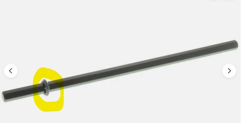

My original oil pump driveshaft didn't have that clip (circled in yellow). The new one I bought does.
#1 - Do I leave it on or take it off (have they ever fallen off) ?
#2 - If leaving it on, does it go on top (toward the distributor), or the bottom (oil pump end)?
#3 - What's its function? (since it wasn't original, on this car).
Old Mar 24, 2026 | 05:24 PM

Shaft installs up from the bottom with the clip near the bottom. (It won't go the other way). Keeps you from pulling the shaft out with the distributor

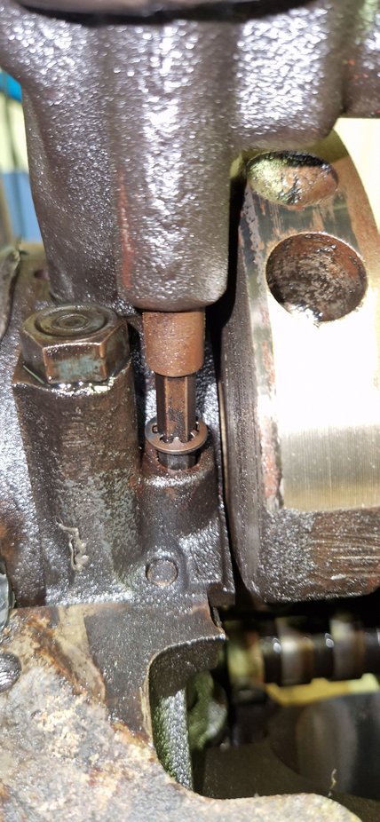

This is is a pic of my engine when oilpump and distributor still was mounted.

Well that's not going to work, I was a bit slow on this question. The oil-pump and pan is all buttoned up.
I suppose I will either cut that retainer off the new shaft or I could use the old one. My first choice is to remove that retainer. #!&%*$

The clip isnt needed. Its only purpose was to prevent the driveshaft from falling out of the engine while it was moving down the assembly line. Kinda like the clips they put over the wheel studs
