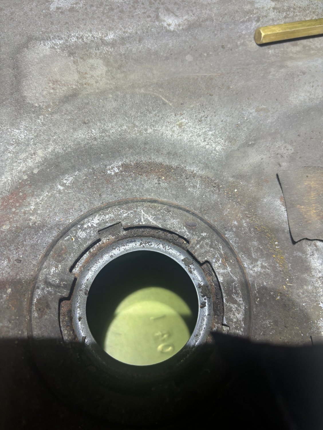

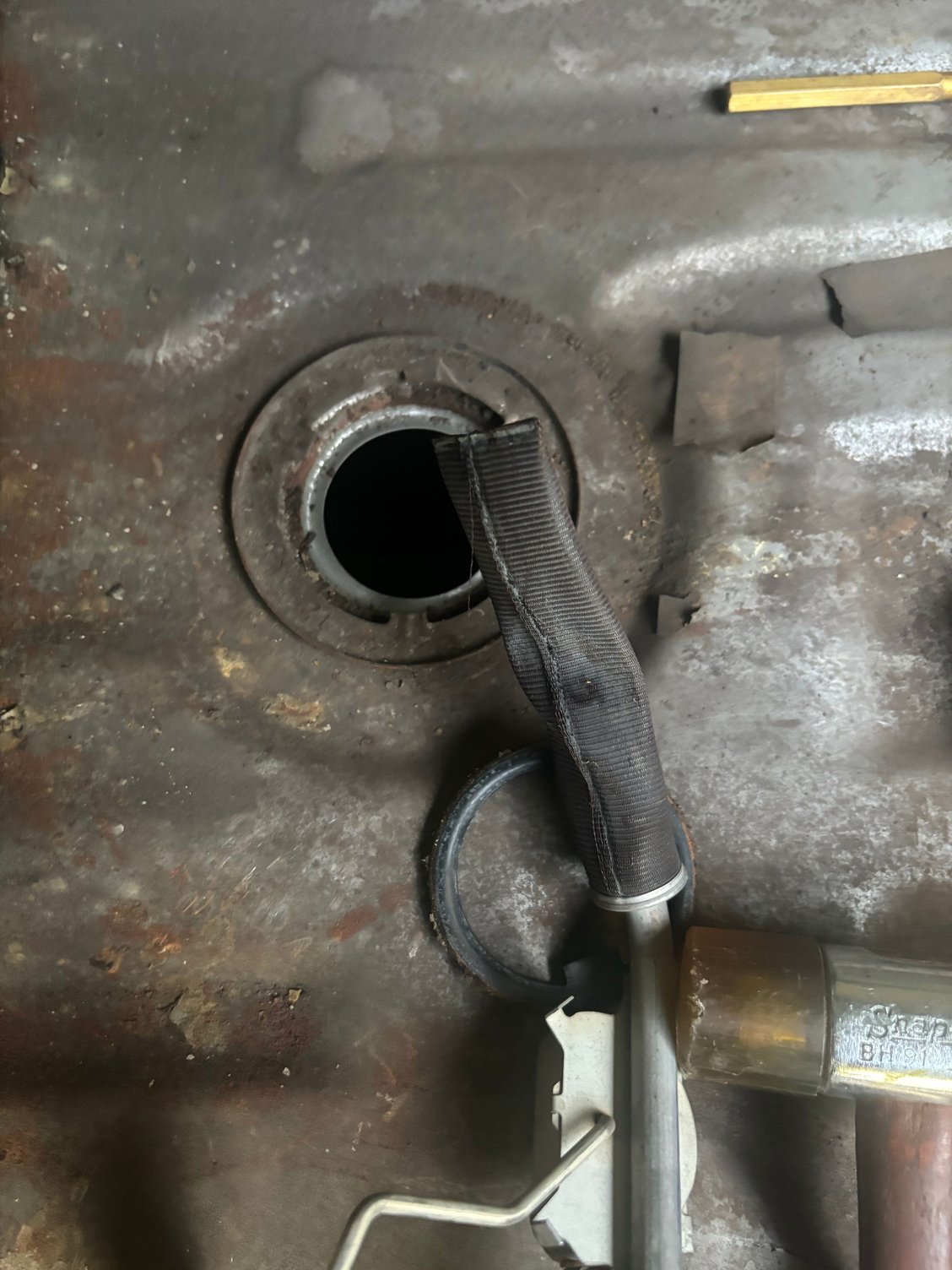

I have an all original 71 442 that has been giving me some issues. It will run great for a while and then it starts acting like it’s starving for fuel. As soon as I try to give it gas it falls on its face. I rebuilt the carb thinking that was the issue but no change. I also replaced the fuel pump just to rule that out but again no change. I figured there must be some junk in the tank that was gutting sucked into the pickup intermittently but I dropped the tank and it looks brand new inside. The sock on the pickup is black/brownish and brittle. Could that be my issue? I have included a picture of the sock and the inside of the tank.

Replace the sock.

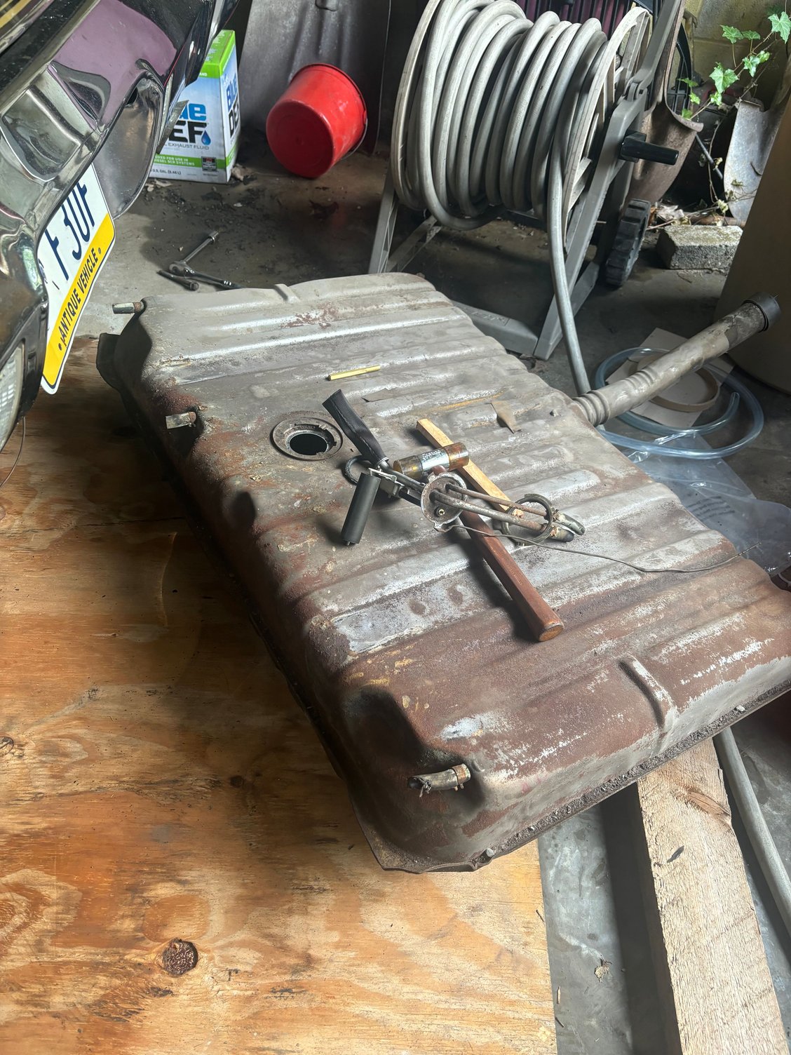

If I had it apart like you show, I would blow some air down the vent lines with an air compressor and listen in the sending unit opening.

Here is a pic of the whole tank

Have you checked/replaced the fuel filter?
Since you've taken the tank down, why not just replace the entire sending unit, which will include a new sock?

Yes, the filter was the first thing I tried. I will just replace the whole sending unit while it’s apart.
