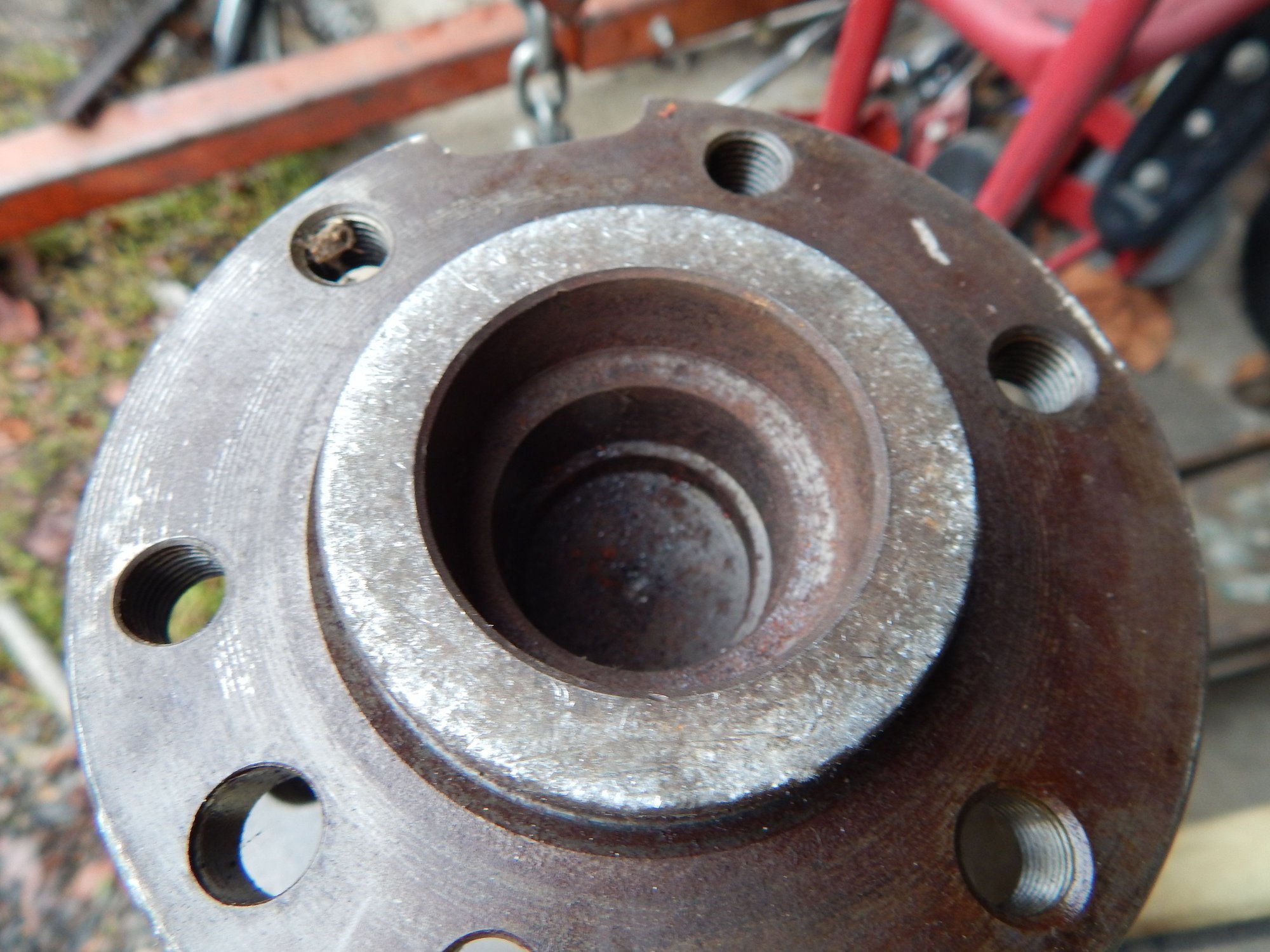

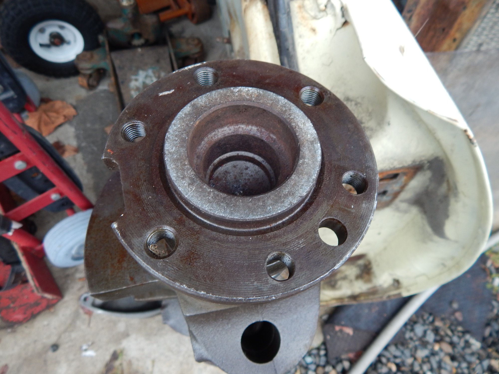

Here's a drawing of the factory 4 speed crankshaft. If yours doesn't have this you can either purchase a replacement one, or have your crank cut at a competent shop. I've had it done and my machine shop used a lathe to cut it out rather than drill it.
And here's a couple photos of the crankshaft itself. Note the depth of the hole and the steps in it. This will accept either a bearing or bushing.
