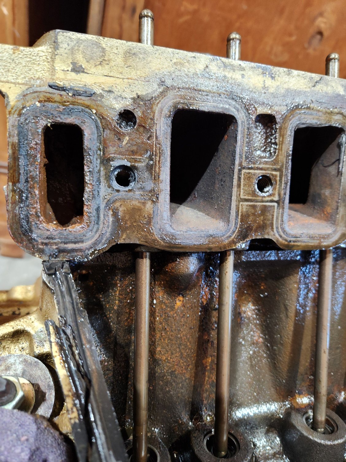

Hello olds fam,
Been a while since I've posted but I'm still working to get her on the road. Recently found out that the engine has bad main bearings and was recommended I do a full rebuild. The shop originally quoted me for around 9k. I unfortunately don't have that $$$ so I decided to take on the task of rebuilding myself with a mechanic homie who has more knowledge, experience and tools than me. BUT I wanted to get some input from the real experts on how I should tackle this rebuild. I think my goal is to get her as close to stock as possible. Maybe a different cam or aluminum intake. But nothing crazy for sure. I've been reading a lot of different threads on past 400G rebuilds and taking notes.
AGAIN open to all recs on what I should do? Will post updated pics soon.

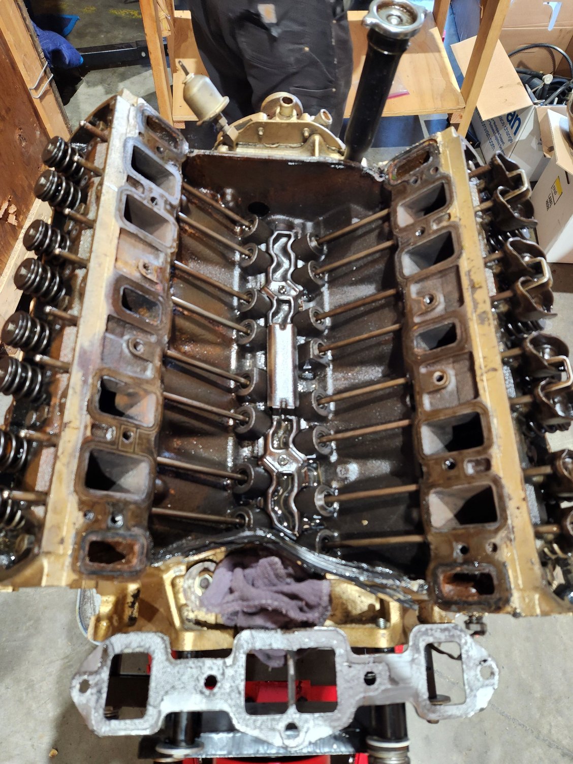

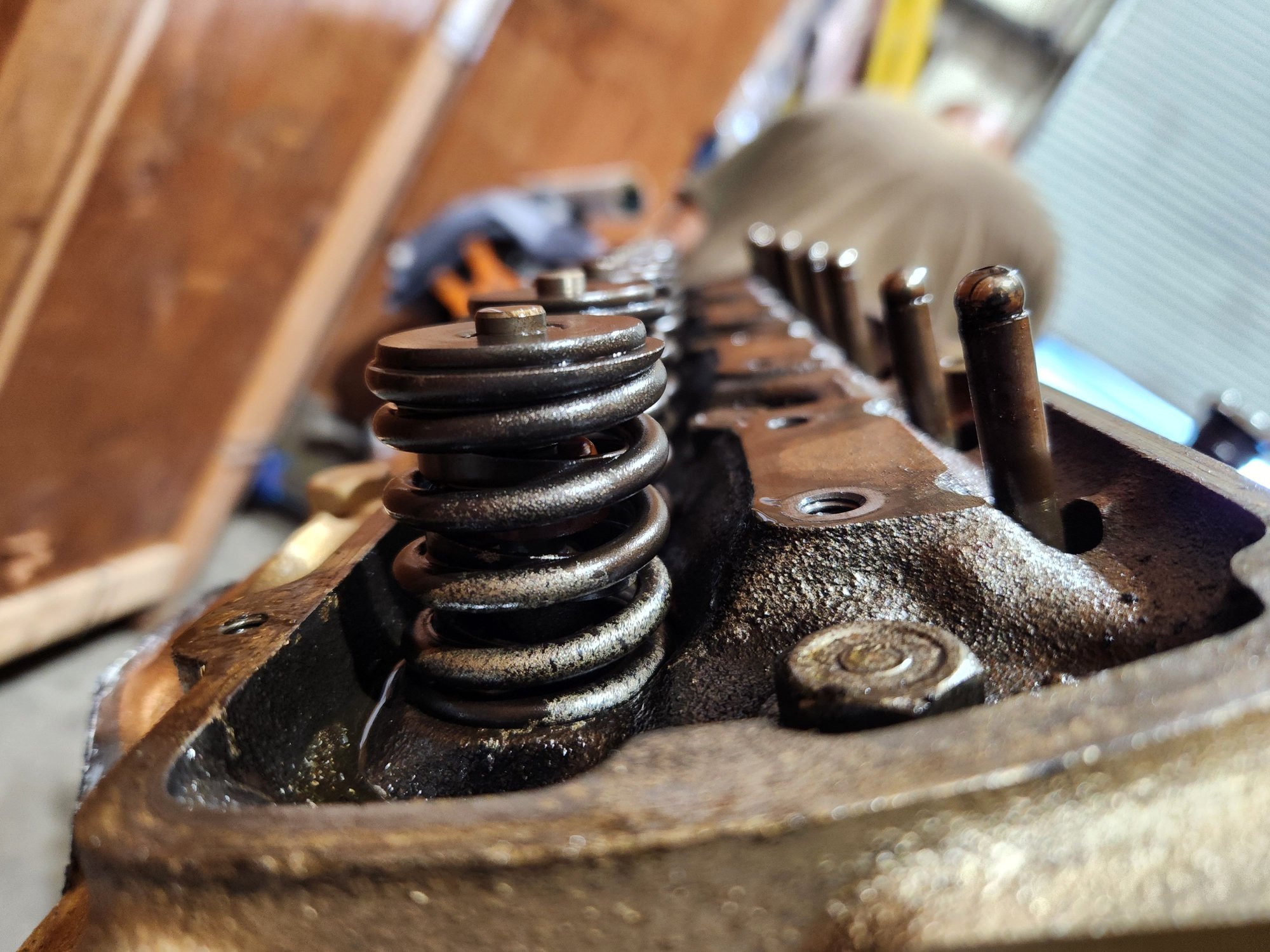

I'll be honest. With a G block, unless you're going for a numbers restoration, I'd find a 455 and rebuild that. Costs will be similar, easier to source internal parts and not as prone to grenading itself.
If you stick with the 400, hopefully those bad bearings haven't damaged the crank too badly and you can get by with a polish or .010 cut.

I bought this car from a guy who said he had the engine rebuilt. There was a new timing chain and sprocket. BUT opening it up I found that EVERY SINGLE bearing was turned. There was even one bearing that was flattened and wider than the rest. I think on the 4th or 5th piston. And there was numbers etched on the prod cap and big end im guessing to coincide with the piston number but the way it was assembled was actually backwards from its numbering. The crankshaft was was not rotating easily. And it had a '010 010' etched on it already.
Forgot to take pics of bearings but will post.

It's your car and you can go whichever route you want. If it were mine, I wouldn't even consider abandoning the 400G. Sounds like you're not going to be prioritizing horsepower numbers and want a close to original strong engine. If that's the case, you'll be more than happy with a properly built 400G. Too many guys take the easy road and drop in a 455. To me, that's little better than doing an LS swap. Everybody goes straight to the 455. Dare to be different.
OK, enough of my commentary. Rebuild components for the 400G are available. Aftermarket cranks, bearings, pistons, rods etc. are out there. I know because I built mine. Hell, a lot of the stuff is the same for the 455 anyway. Talk with somebody like cutlassefi to get quality advice on parts combinations.

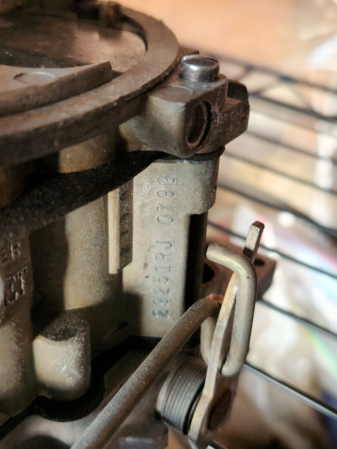

Yes that is 100% my plan. I have a numbers matching engine and trans and I just want it as close to original as possible.
just realized i have the wrong carb for it tho. But not sure if this will work the same.
So I will be on the hunt for the original carb 7029251 RJ if anyone has one they would like to sell me. Preferably in working condition. I bought this one off of a member here and had it rebuilt and it didn't seem to run too nice. But it could be cause the whole engine was ****.
But yes thanks for the reply. I've seen @cutlassefi pop up on every single thread related to rebuilding engines. I am def going to reach out him for some help real soon. Just took everything to the machine shop. They said it was salvageable.

Sounds like, as is all too typical, someone who knew nothing about Oldsmobile engines got their hands on it. Even if their knowledge was Ford engines I'm having trouble wrapping my head around how this individual buggered up the rod and bearing installation. What is so hard about left bank 1-3-5-7 and passenger bank 2-4-6-8?
How bad is the crank? As you may know it's 68-9 400 only if you want to stay original. If it's already been cut 10/10 the next step is 20/20 if polishing won't clear up the damage. You may find a good machine shop that can build up the bearing surfaces by spray welding them, then machine them to original diameter.

455 Cranks are inexpensive just buy a new crank have it ground 10/10. Find one with the large N or small CN 68 to 73?
400 G is notorious for spinning rod bearings so make sure you get the clearances right and go with an aftermarket rod if its in the budget.
If your car is a 4 speed you will need a four speed crank or drill the new crank for a pilot bearing.
When selecting an aftermarket rod make sure it fits through the small bore.

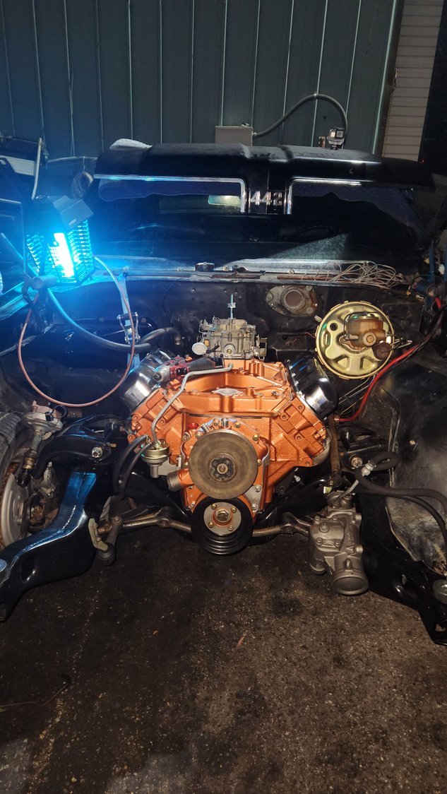

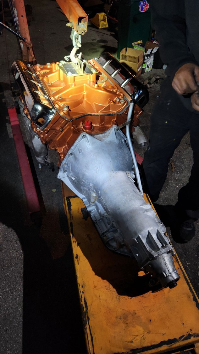

Engine update:
-aluminum manifold
-roller rockers, rods, and cam

depending on your body build date a 29251 with a build date of the 79th day of 69 is the correct carb for an automatic 442. It's well documented that the "70" was left off on some carburetors.

Most importantly...it is now the correct color

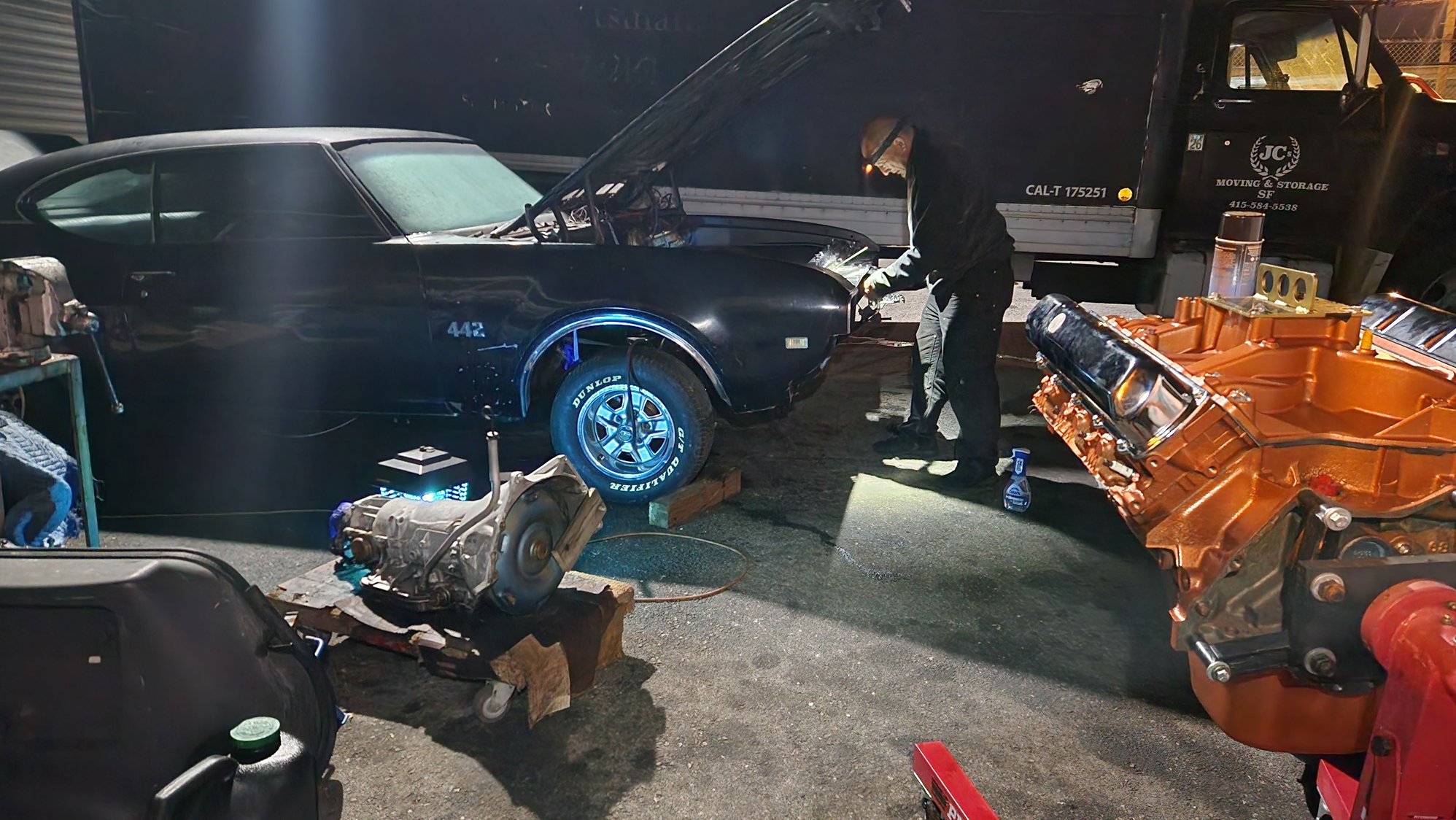

Updates and cylinder 7 question
Engine is in and running.
Ran into some defective lifters that needed replacing. A couple leaks that were addressed.
But now there seems to be something going on with cylinder7. The compressions for all are around 140psi. When I cover the carb the rpm does not go up but cylinder 7 is running at about 100 degrees colder than the rest. Anybody have any ideas as to why????
Thanks in advanced for all the help!

Car is running like a beast. This thing has been really fun. Got all the outside lights working. Dash lights work. Tach works. Gas says E but is connected. Not sure what the issue is. Speedometer isn't working. Temp gauge is working.

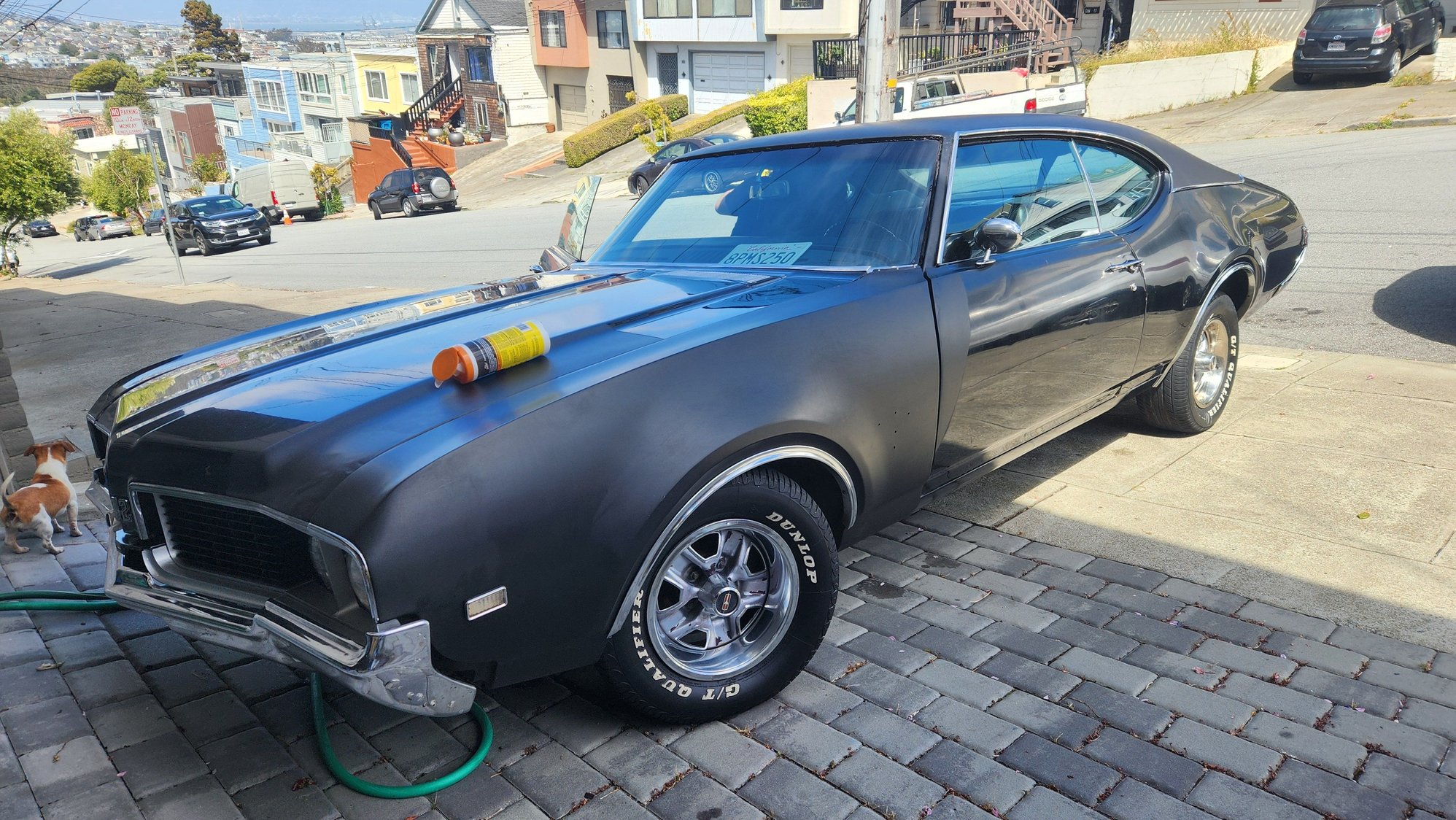

Finally got the correct front bumper shout out to Dave. Got some 15x7 ssii that I'm gonna finish up and throw on soon too. She's been a whole lotta fun driving this summer.
