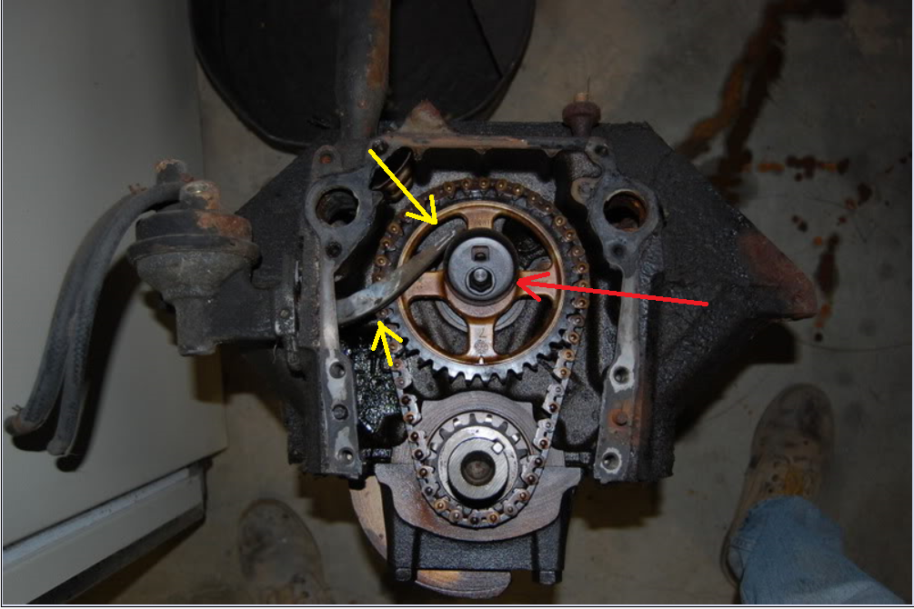

Well like I said in the beginning I have Chevy background and mentality and trying to install the Olds fuel pump I see (or rather feel) that there is no push rod to lift up out of the way and pack with grease before installing this pump? Am I correct in the assumption that you just maneuver the pump and lever in such a way that it just slides into place and bolts up without a whole lot of hassle or a whole lot of pressure? I looked up fuel pump in service manual and there are no directions only a note that it is operated by a concentric lobe. Thanks again, Mike
Old Jun 18, 2019 | 07:32 PM
Posts: 15,394
Yes, just insert it and it should align correctly. The flange probably won't sit flush to the block, but as you tighten the bolt and nut it will compress the pump arm and snug up to the block. As you said, this is not a Chevy so remember to put the pump in with the housing in the right orientation.

thank you, I feel better about the install. and thanks for the internal pic of the pump arm and where it sits. Too many years of chevys. That pic explains it very well. thanks, Mike
