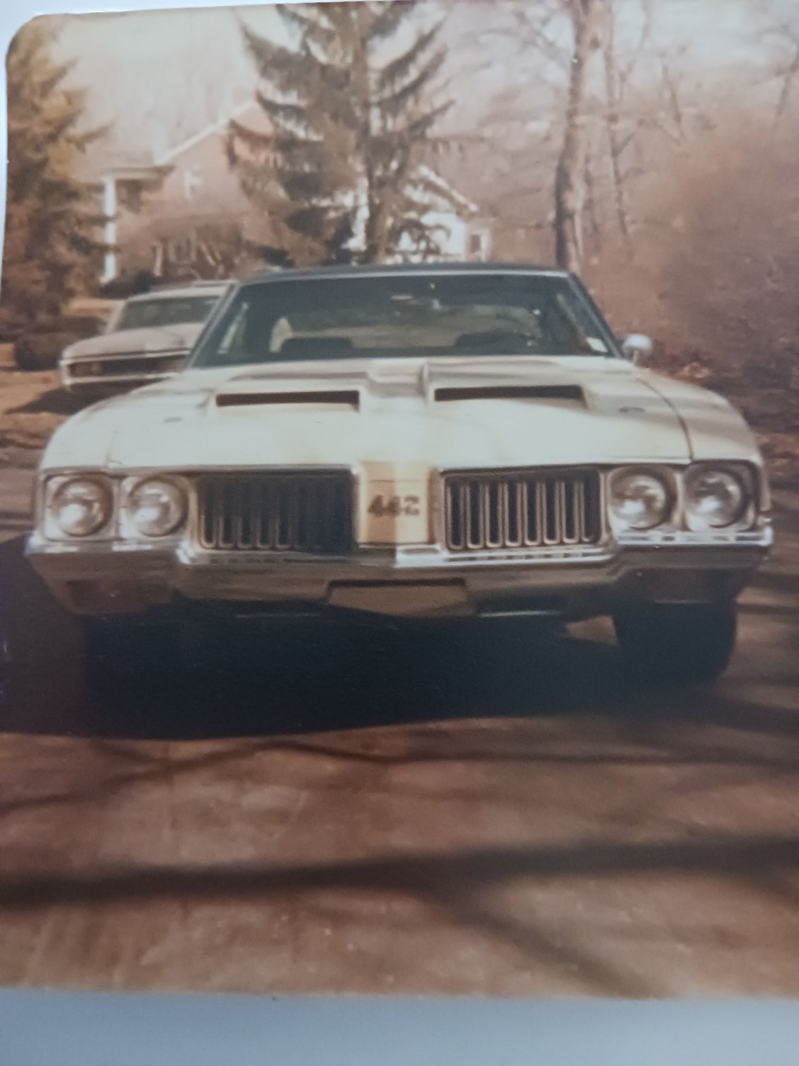

I'm doing a complete rebuild on the 442, I bought a Roadster Shop frame and suspension, I really like the 425, my wife and I are going to drive the car across country as a road trip car.

I bought the car in 1979,the gentleman pulled the 455 and put the 425 in it to drag race. I did a partial rebuild in 1985, then put it in storage for the last 20 years.
I wanted to restore it before I got too old.

I will keep you all informed as I buy parts and get the motor done,
I fell in love with this car the first time I saw it. Hence the reason I still own it after 45 years.
(the color on the car is Bamboo Cream)
