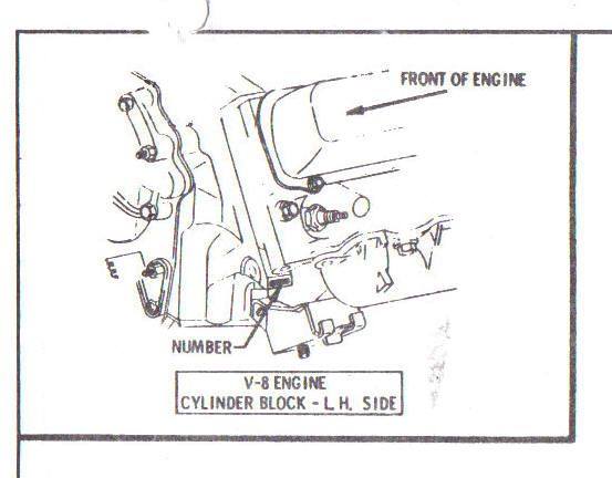

E heads are 1970 heads, but they may not be original to the block.
look on the pad near the front drivers side of the block just below the head. There will be a vin deritive number stamped there that might shed more light on the year of the block.

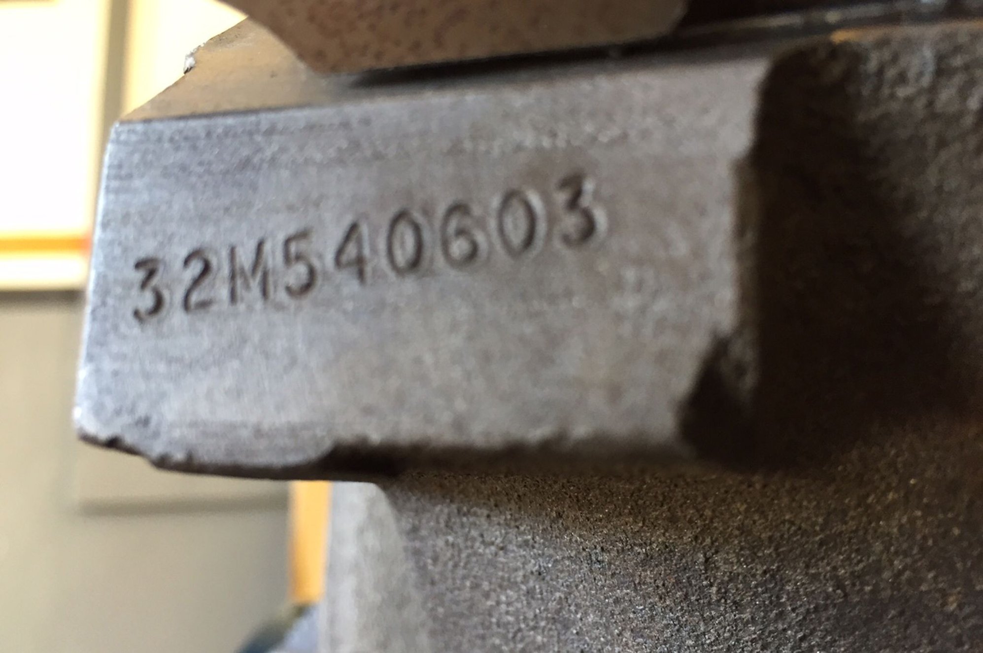

Posts: 50,770
The only way to know the year of the block for sure is to check the VIN derivative stamp. The second character is the model year. In the photo below, the "2" in the second position is 1972 model year.
